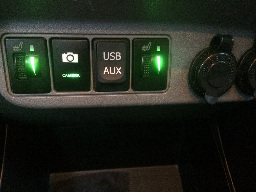

    Has anyone been able to add two cameras (for a total of three) to the OEM display?
    And any issue with the camera being always on?

    If you use the module listed above it allows you to add two cameras and the option to connect to your turn signals for side cameras or manual switches. Also I believe the camera is triggered by completing the ground with the switch so as far as I know it's not on all the time. Rearview camera stays connected to your reverse circuit. Hope this helps.

    For the cost of the bunch of wires they are selling, i see no reason why you shouldn't be able to run the cameras whenever/all the time.
    If you wired in the front camera to a switch, couldn't you just flip the switch and it'll keep displaying it until you turn the switch off?

    That's exactly how it works flip the switch and the camera is turned on until you flip the switch again. Unless of course you wire it to a momentary.

    @THE CALICO & @mCat any reason in your opinion why the kit cost so much while the cameras are super cheap? Is there some kinda special chip in that box or it just a bunch of overpriced wires? Granted im not a big tech guy but it's shocking that the camera is 15 bucks and the wire to hook it up is 270 :notsure: :annoyed:

    My only guess for the price is it was so new. I had no idea how to connect the switchable cameras for the head unit with out it and still don't. I do feel it's over priced but it was the only option I could find. Hopefully they'll drop the price soon and include better instructions because what they currently include leaves a lot to be desired. I'd like to also point out if you buy the kit and don't have RCA Cables just laying around your going to need to get some. RCA barrels would be better and then you wouldn't have all the excess wiring. All the RCA connectors are female and two of them have to be connected.

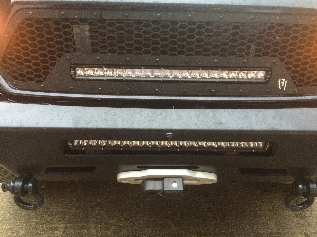

    I'm not sure the resolution but it's as good if not slightly better than the
    factory back up cam.

    New to this posting thing, but love reading all the threads. I would love to add a front camera to my 16' Taco. Has anyone done that with the wiring kits shown above? Where did you mount the switch? Any help is greatly appreciated.
