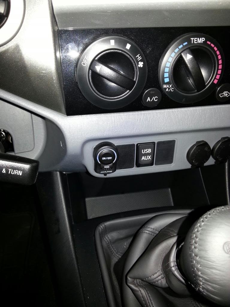

    I run a front camera in my '13, but I am after market (alpine)
    The front camera is on demand just press the button and the image is in the HU. It is really handy when parking in tight spaces and lots of other applications.
    Button location:

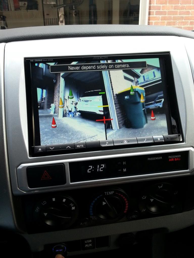

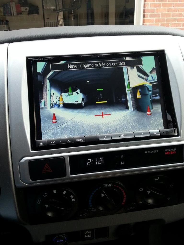

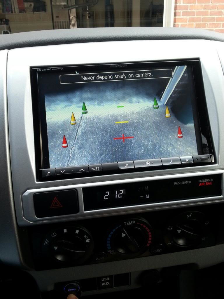

    The camera can toggle between 3 modes
    Head on view:
    Downward
    and 50/50
