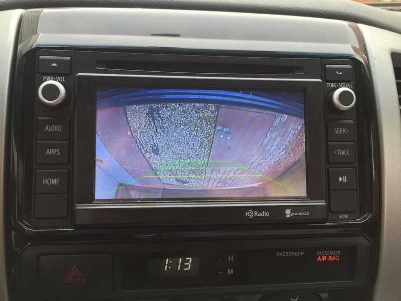

    I got it to work! The only problem is that the signal is flipped because I bought a backup camera instead of front facing camera. So the picture is upside down and the lines are right side up.

    That's awesome! How are you switching between cams?

    camera is upside down????
    front vs rear cam should flip side to side not upside down

    rotate the camera 180°

    Ill try out another camera. I bought a cheap Amazon camera for 15$ that I used. Quality looks like crap compared to the factory camera in the tailgate. I'll see if I can order another one that's better quality and faces the right way.

    Ok guys just to keep everyone updated, everything I have works fine(except the camera view being upside down, but that's a minor camera issue). I'll be away about a week and half on a roadtrip to Yellowstone for backpacking but I'll ask the guys at camera source if they can get a few kits ready for sale as well as some group pricing back to me.
