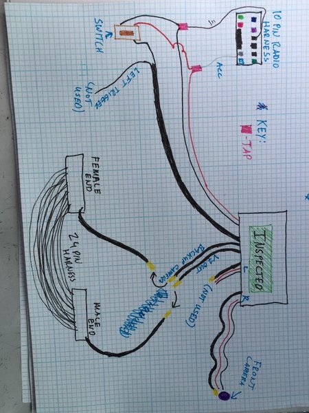

    @mCat how does the harness plug in/attach to the factory harness? splice connectors? plug and play connectors?

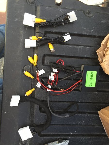

    As long as the connector at the back it the same as the others it should work for all other models. The unit just taps into the backup camera feed and uses that to display the front camera.
    The only wires you have to cut into are the acc power and ground. The guy doesn't want to make an additional harness just for those two wires since you can even tap into your 12v outlet for this. This entire thing is 100% reversible(other than where you attach the switch and camera(s))Everything else is either rca cables end to end or attaching a switch.
    The picture below is my setup with the two camera option, one of which I'm not using right now.

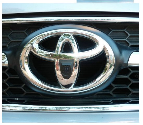

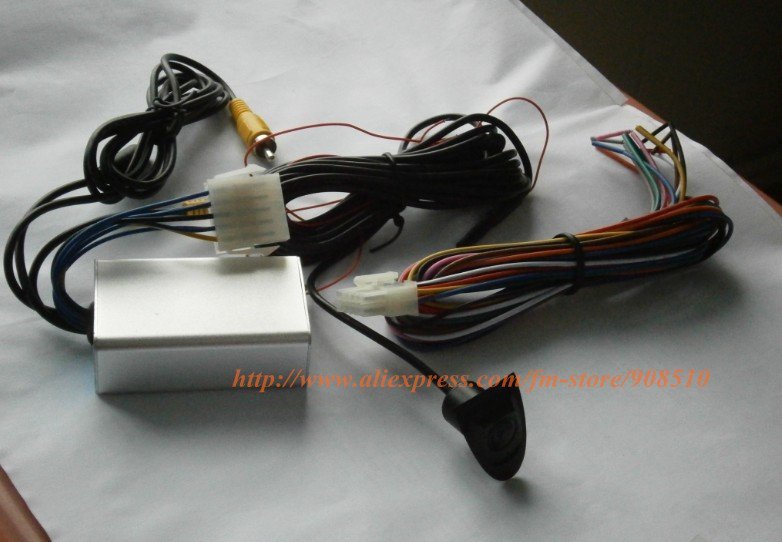

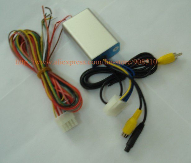

    @mCat I looked at this setup that includes the camera for the emblem. Camera quality unknown, but otherwise looks worth a try.
