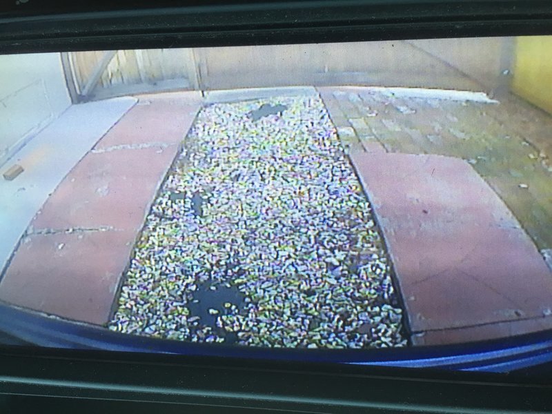

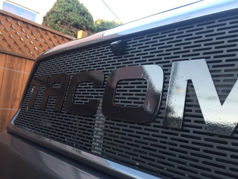

    Hey guys sorry for lack of updates, been super busy, no time for truck stuff. I bought a new camera off Amazon(link below) that was supposed to be reversible view(used for front camera as well as rear) but that one didn't function as it was described(video wasn't reversible) so I got a refund from amazon for it, Now I'm looking for another camera to try out. I don't want one that mounts to the lisence plate as I park in the city and get little 'love taps' from very friendly people all day.
    I had it mounted in my grille(satoshi style) at the very top center of the grille, worked really really well to see all points on the bumper but video was upside down so i returned it
    now I'm looking for something new that's not upside down again....
    http://www.amazon.com/gp/product/B00RD05MOO?psc=1&redirect=true&ref_=oh_aui_detailpage_o05_s01

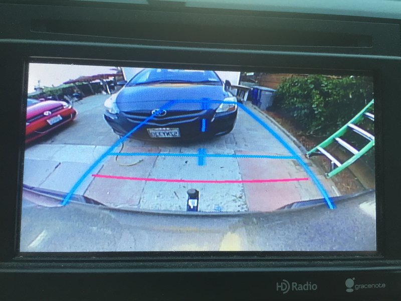

    here are some pictures of the installed camera I got from a buddy of mine. Seems to be the same thing I bought from Amazon on the previous link but for some reason this one reverses the video but the other one i got from amazon didn't do that.
    just quality comparison here is the front camera and the factory rear camera resolution.
