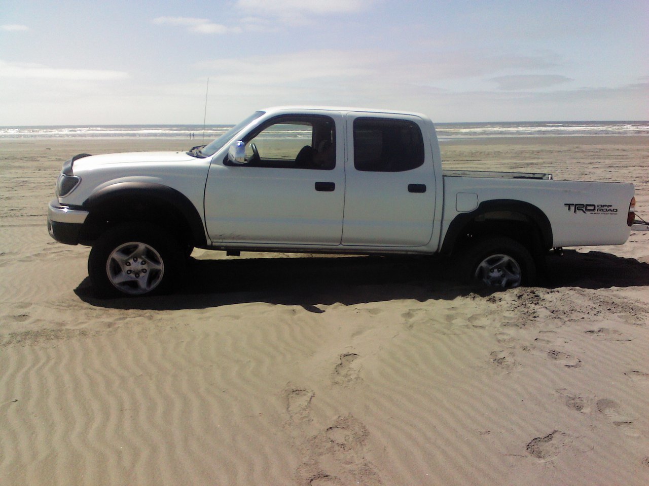

    A locker is good, but 4 wheel is better. I just converter a 03 prerunner the weekend before last. Started Friday and was driving Sunday in front wheel drive. The truck is way more useful as a 4x4 than a prerunner with an e locker. Even more useful as a front wheel drive than rear.IMGA0124.jpg I was the bone head that did not try airing down the tires but my e-locker could not save me.
