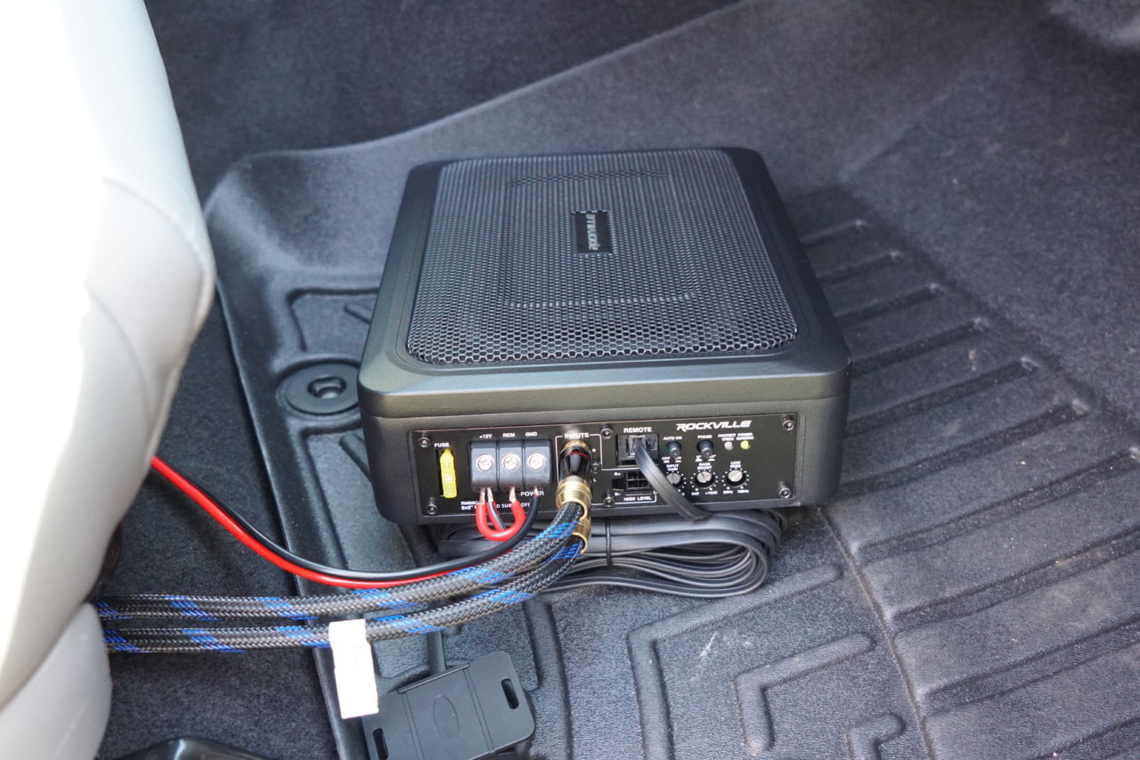

    Rockville $149 which is is a huge budget option https://www.amazon.com/dp/B019Z3R582

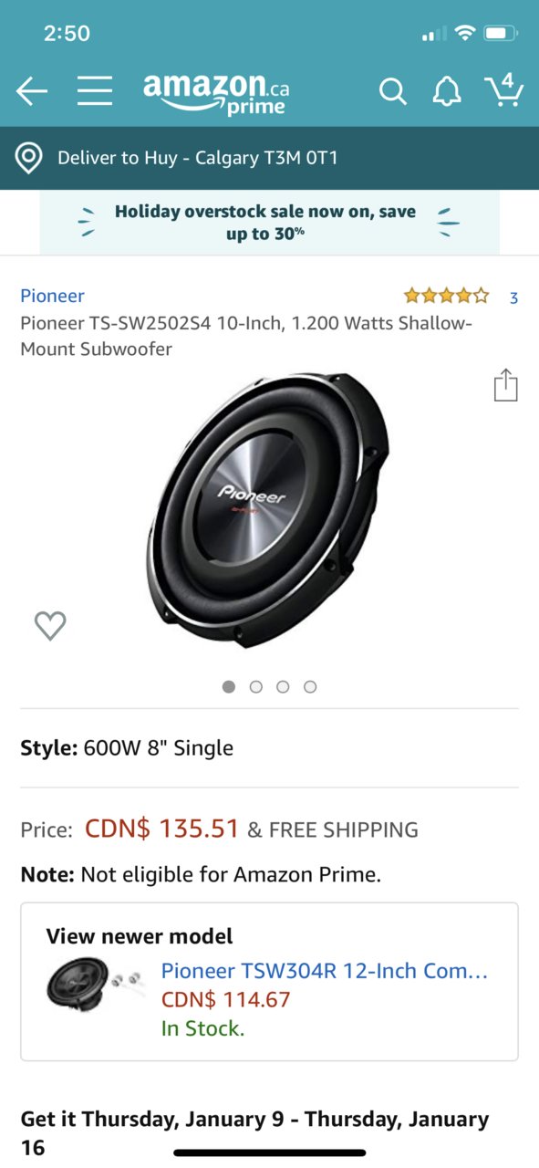

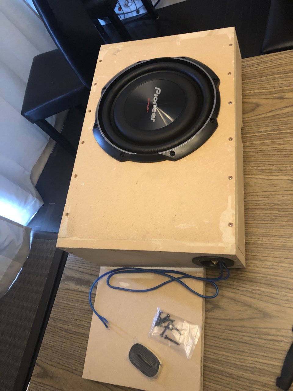

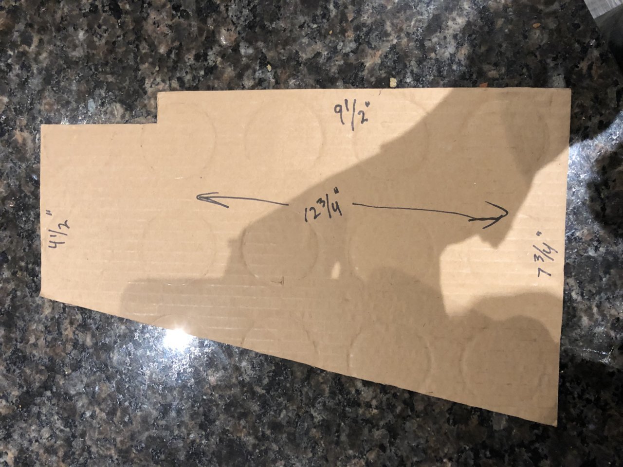

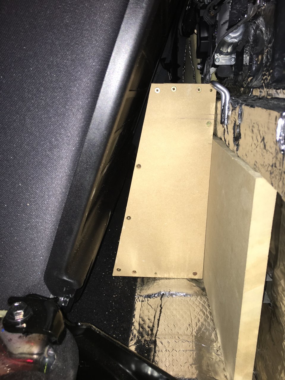

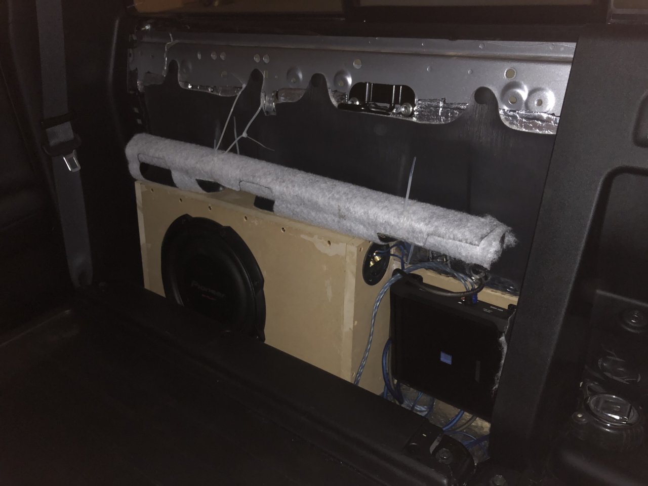

    I built mine for a few hundred. Its 300w 10” pioneer matched with 300w alpine amp. I built the box myself. 77674397-8CCF-4D65-8653-9148F8272030.jpg

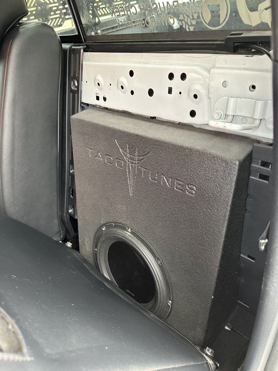

    I don’t have any good pictures but I have the single 10” taco tunes box behind the passenger rear with an alpine sub and alpine amp under the drivers seat with kickers all round

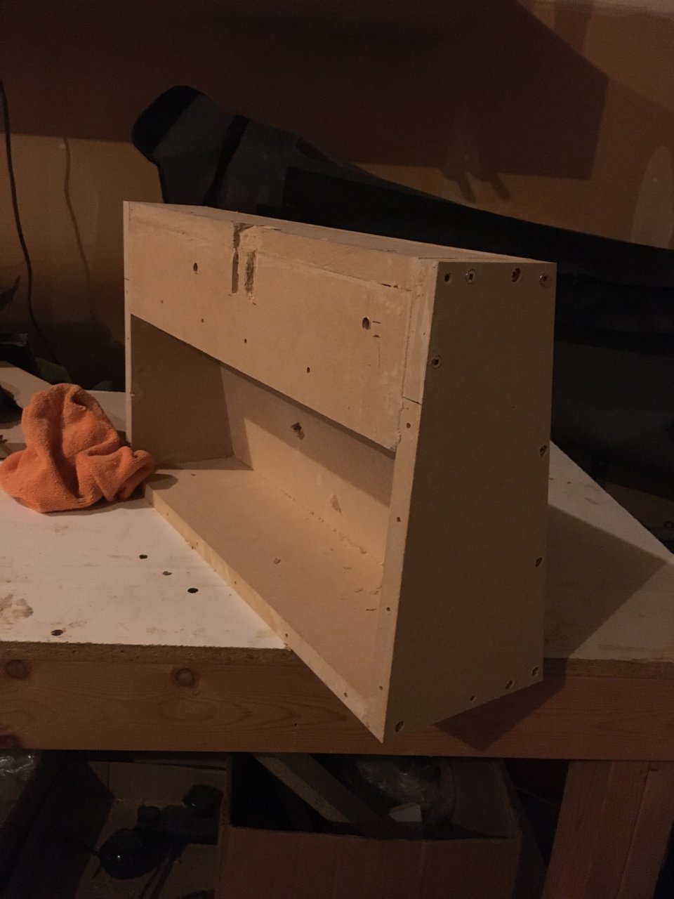

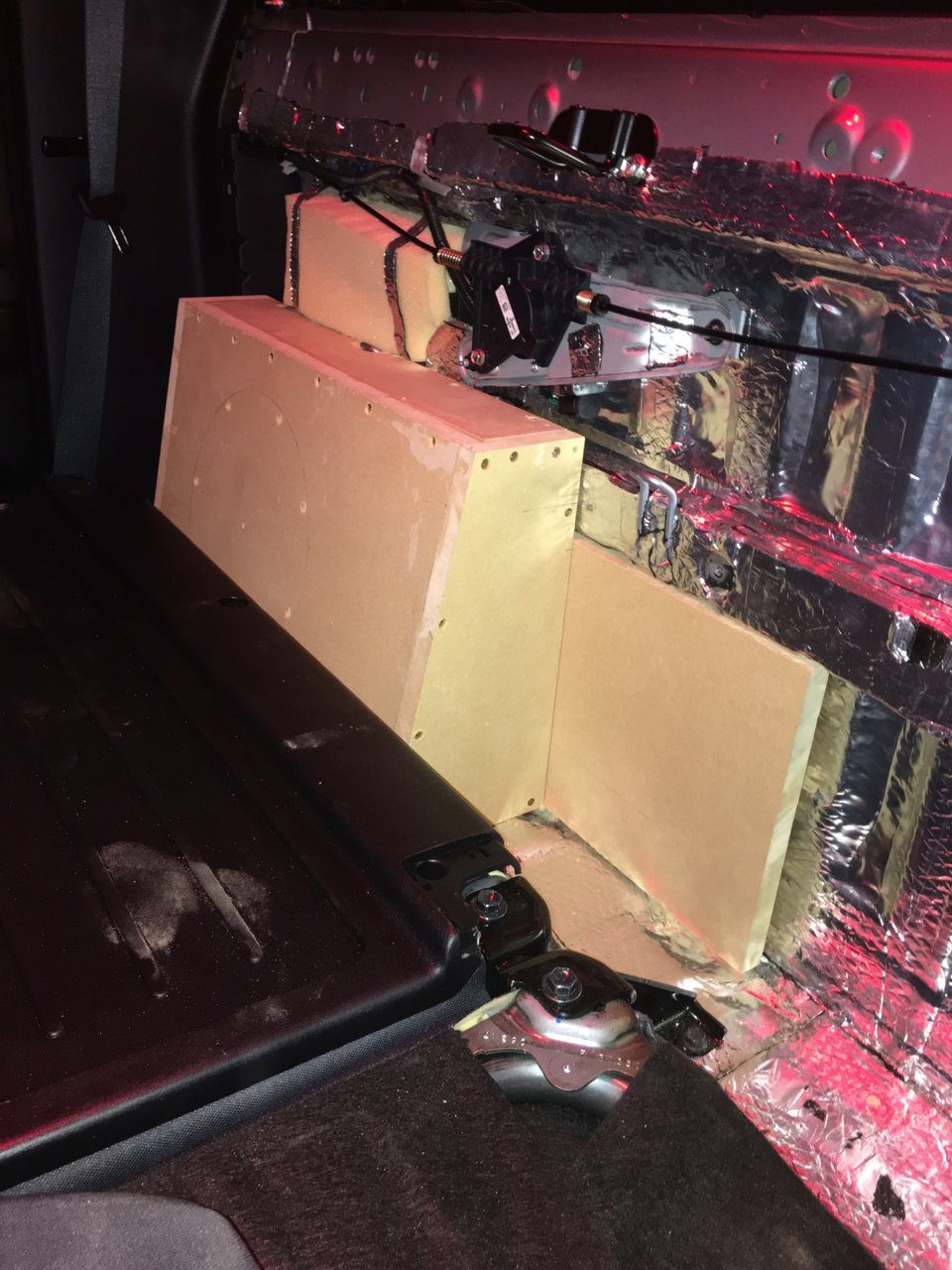

    No worries…it was hard getting the sub boxes up to canada at a reasonable price. The air space is in spec for a shallow mount sub but you can make it as wide as you desire. I only did one 10” so had enough space to mount an amp right beside, which made things convenient. Added a few more pics so you can see how i built it, as well as clearance so you dont need to remove the back of seat like most sub boxes require. Probably could make the box a little larger if you like. My other 6 speakers are not amped, although i did upgrade the headunit which put out more power than the stock radio. Its a nice balance but most importantly, glass shaking bass. Not sure how anyone can drive without bass

    Got a few pictures

    Does the taco tunes box require the removal of the plastic ?

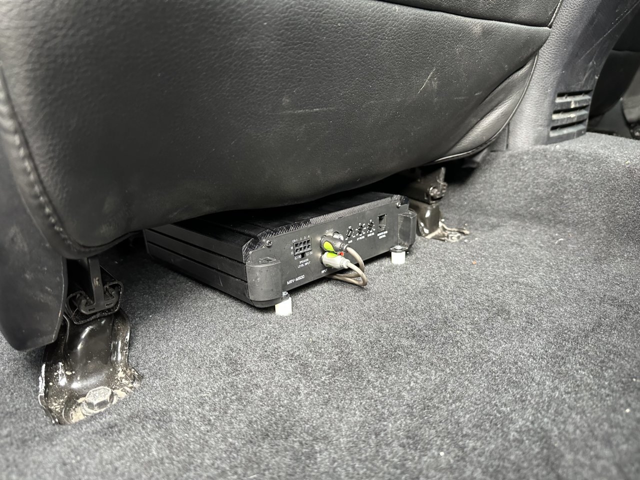

    Slides under my passenger seat. Takes pressure off the HU amplifier adds to the bass.

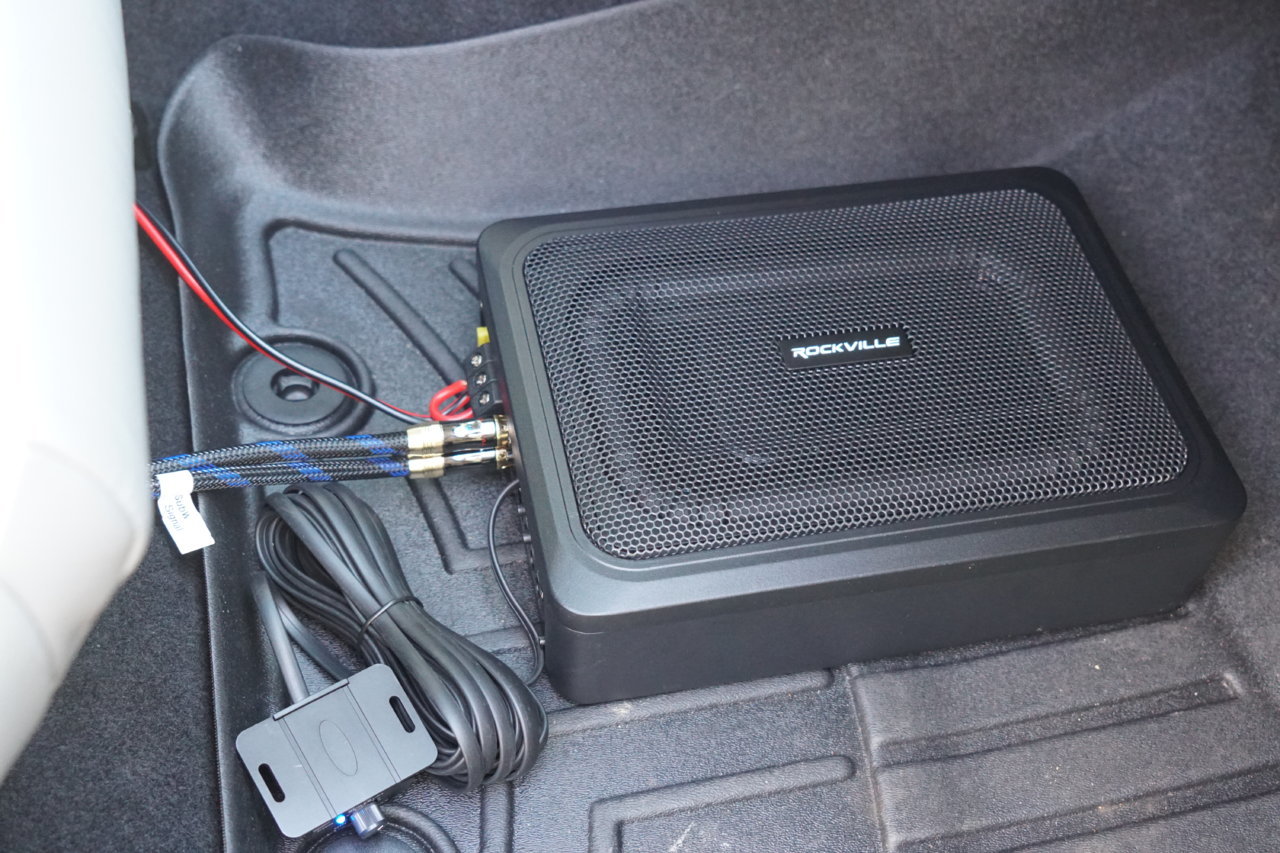

    because everyone's point of reference is entirely different, nor is well-described.
    the rockville under seat sub is going to be good for older-alternative, rock, twangy-country, jazz. up to about half the volume level of the stock system. if you listen to anything with a strong drum beat, rap, new-country, pop, the stealthbox/taco tune box+sub+amp is going to be a better option.

    removal of that side of the storage behind the seat. Just some screws and clips. No cutting

    i tried a soundstream usb10p just for kicks in the last truck. the specs looked promising at least. even with some crazy tuning, i never got it past the level of bass one would expect from a boom box. was it better than stock? yes, but it didn't hold a candle to even a cheap sub/box/amp combo.
    i would rate underseat subs very similar to how a tv/vcr-combo works. it's functional, but built to an extreme cost that is easily outpaced by purchasing individual versions of the same thing.
