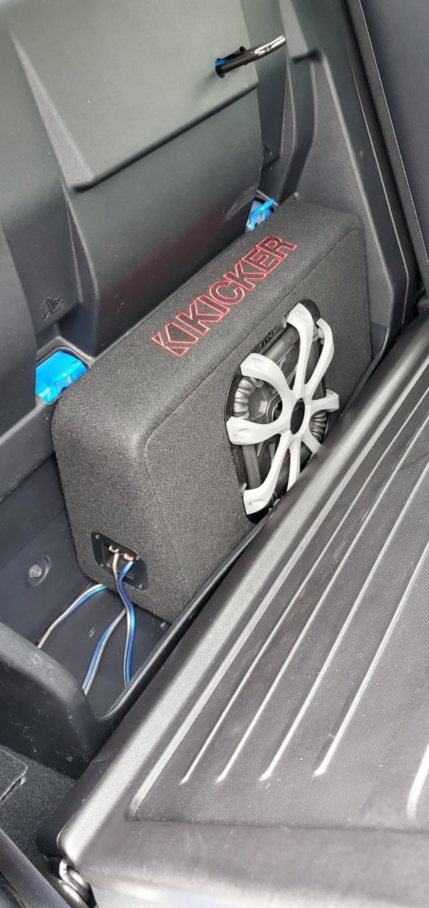

    I installed this Kicker 46TL7T82 Loaded 8" Subwoofer that is 350 watts RMS with two 4 ohm voice coils in parallel running at 2 ohms. The Kicker 08GL78 grill is optional.
    https://www.crutchfield.com/p_20646TL82/Kicker-46TL7T82.html?tp=112
    I also previously installed Kicker CS series door speakers for 3 years before adding this sub and a Kicker 5 channel amp.

    That thing looks like it fits really snug! that's great. It requires a separate amp right?

    Yes it fits snugly! The grill will put some pressure on the edge of the bin and ensure the sub has no restrictions when operating.
    There is a tiny fin in the bottom of the bin that needs to be trimmed. It will allow the enclosure to sit flat in the bin. The enclosure fit is perfect, nothing is forced to fit and the back of the seat is completely clear to operate.

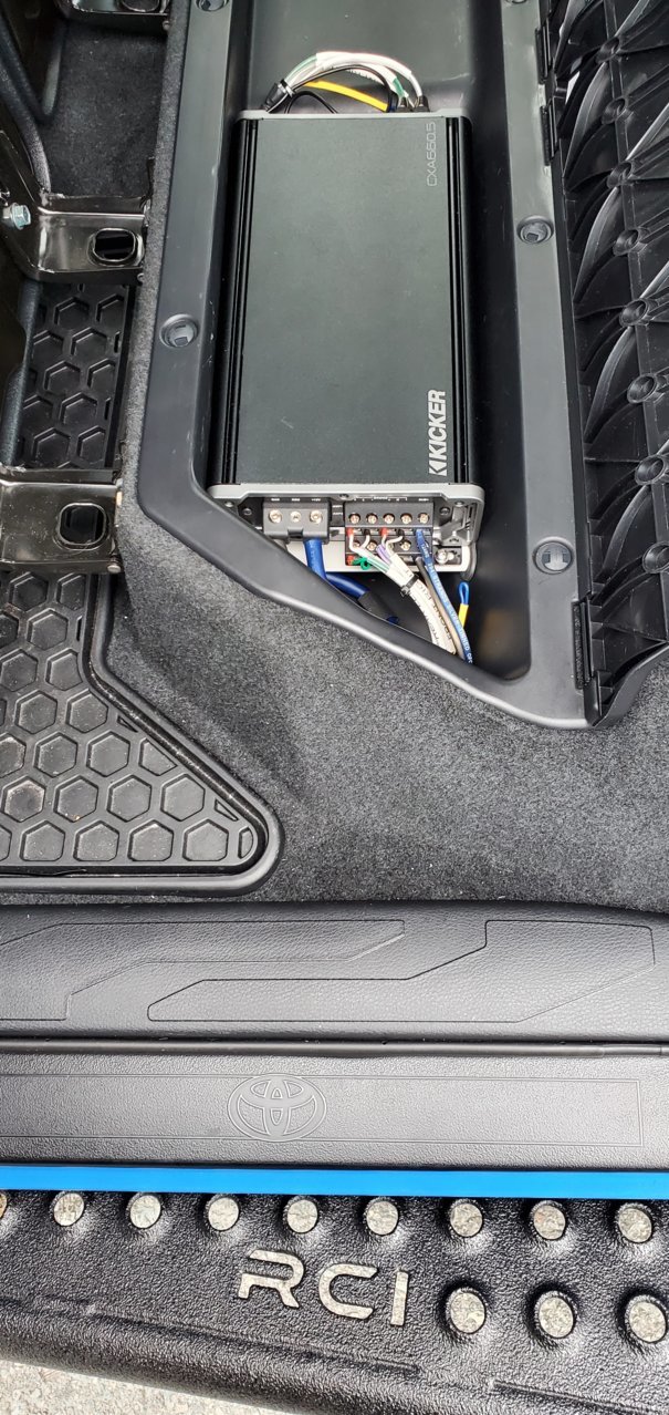

    I also added a 5 channel amp. This is a Kicker 46CXA660.5 to go with the 4 Kicker CS series door speakers. The amp outputs 300 watts RMS for the 350 watt subwoofer @ 2 ohms. The 4 ohm door speakers each get 65 watts RMS from the amp.

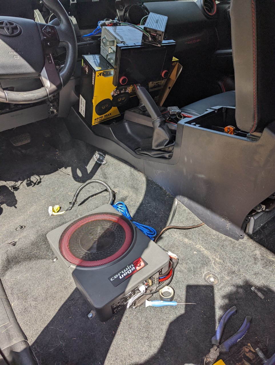

    I run a Certain Vega 10" underseat. Surprisingly it gets decent reviews and it really does live up to it. It produces a decent, clear-ish tone at a wide range of frequencies, and can rapid-fire thump with any drum solo.
    ...for an underseat.
    Of course it will never come close to a proper enclosure or even a confined "low-pro" enclosure, but I knew that going in. Location is also far from ideal. If I was willing to give up even a smidgeon of my rear storage my first choice would be a small box behind the bench.
    But this really isn't bad. I'd put it up against any other underseat on the market currently. It hits the lows and rounds out the sound stage for an enjoyable commute. It isn't competition grade. But it gives a "good 'nuff" sound for a little pickup truck, and I didn't have to sacrifice any space at all for it. That's a win.

    I see the Kicker Key amp. I considered that jem for a while but it was always sold out. The Kicker amp I purchased would not fit under the front seat unless you put seat jackers in. The main issue is a bar under the rear of the seat that moves with the seat. Pretty much defines the small area the amp can occupy.
