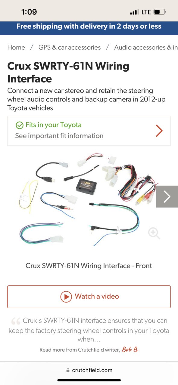

    JTG67-
    JTG67- Member
    Nov 30, 2015
    #171012
    24
    Jerry
    2016 Tacoma Sr5
    Yea the head unit part isn’t true depending on what head unit you’re looking at getting. I spent like $260 for a head unit on crutch with the wiring harness to allow me to keep my controls, backup camera, etc.

    JTG67-
    JTG67- Member
    Nov 30, 2015
    #171012
    24
    Jerry
    2016 Tacoma Sr5
    There’s actually some headunits that don’t need that. I ended up using the Crux wiring kit that Crutchfield offered and had no issues with it
