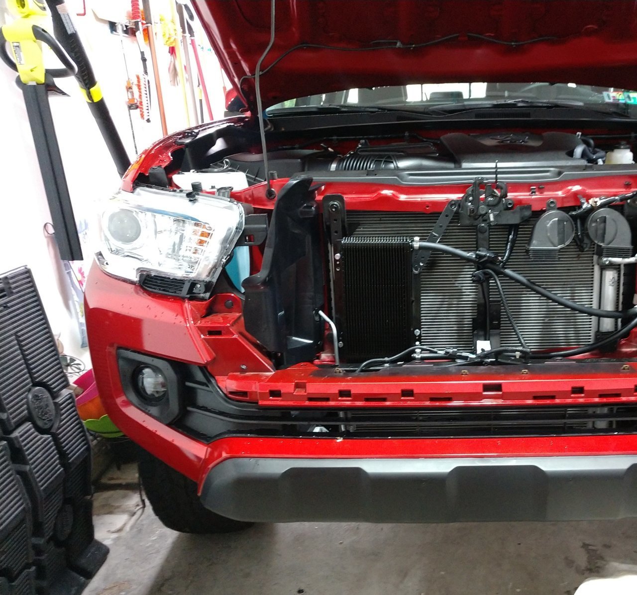

    A few questions for those that have added a second transmission cooler.
    It seems easier to add in line with the little cooler that comes with the tow package. Does it matter which cooler comes “first” in relation to the transmission? How do I know which line come “from” then goes “back to”? Please pardon my lack of proper terms here.
    The new cooler came with plastic zip ties to attach to the radiator. Seems simple enough but is it really a lot better to get some metal straps and have it a bit separated from the radiator?
    Lastly, as this is a sealed system, can I top off the fluid myself?

    It shouldn't matter which is "first." I would consider the plastic zip ties to be temporary. Topping off the fluid is a relatively complicated process, if it is like my wife's RAV4. To do it right you have to monitor the fluid temperature. There are several UTube videos on the process.

    Would it be safe to install the cooler then drive maybe 5 miles to a shop to have fluid topped off?

    I took my little cooler out and made a bracket with some steel flat bar from HD to install a huge aftermarket cooler.. Painted the brackets black. It you keep the factory cooler then you have double the number of potential leak points.

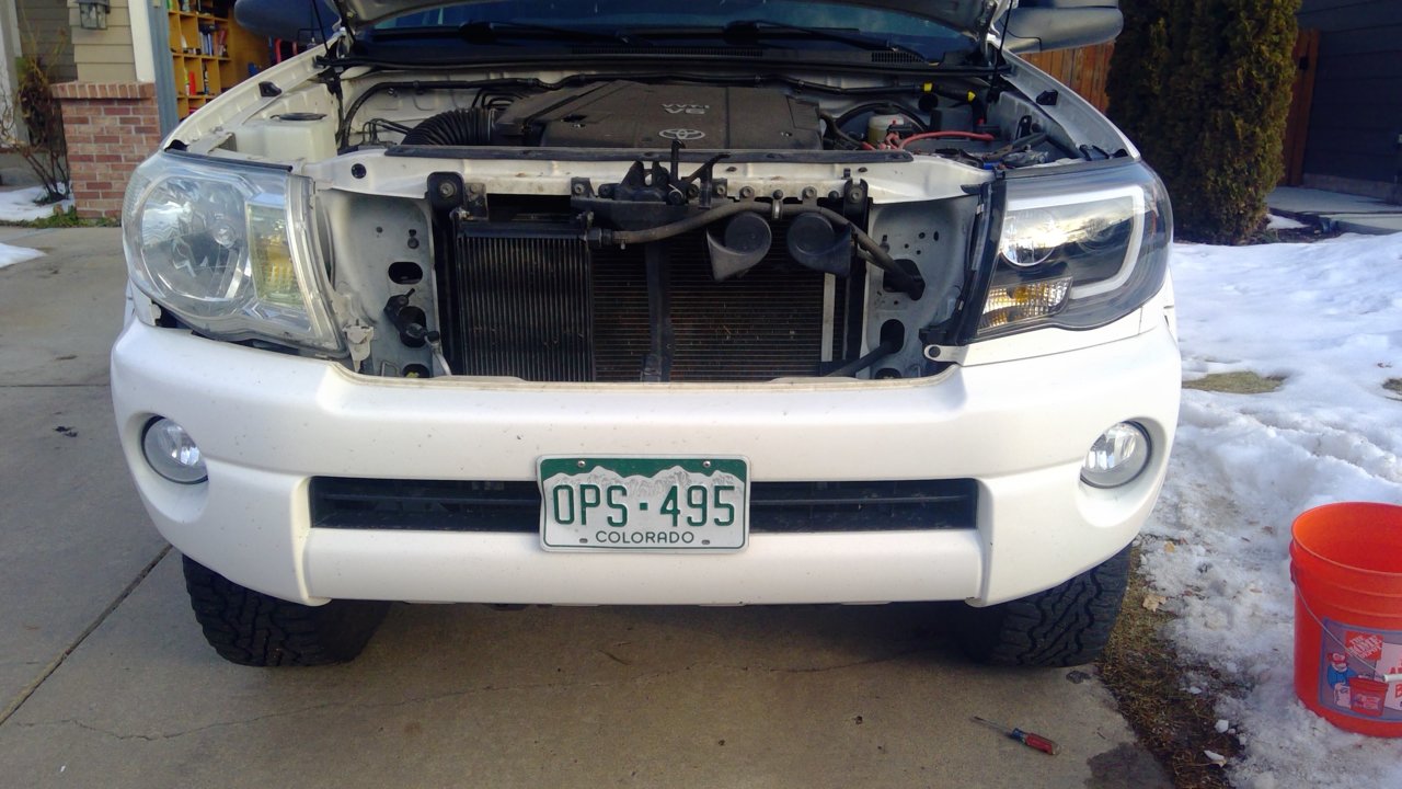

    Ended up rotating 90 deg., for better air flow with stock grill. But what TMOne said. Was doing the lights here.

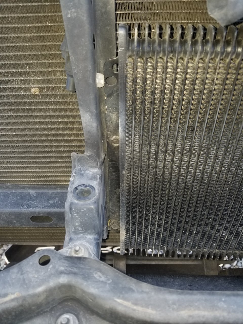

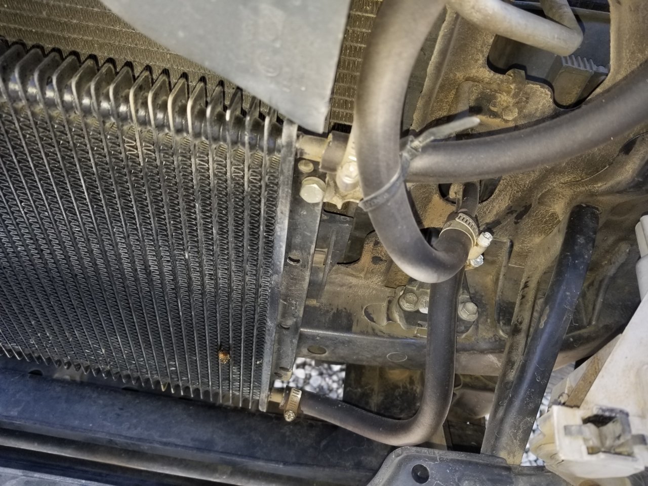

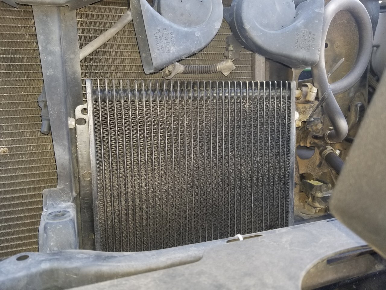

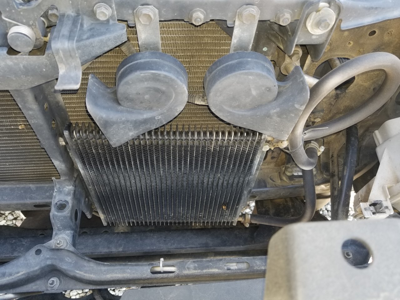

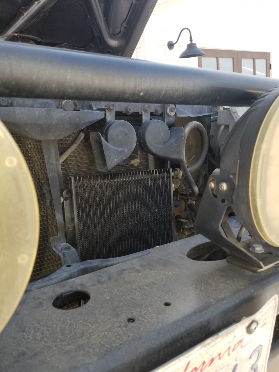

    Here are some pics:
    I installed a Hayden 679 replacing the OEM trans cooler. I tried using the OEM location. The top hose had to have a loop in it (which is recommended in the Hayden 679 cooler manual) since taking a direct path would cause the hose pinch/collapse.
    I used 2 factory transcooler mounts and 1 factory bolt hole. The 3rd location at the center support where there was a transcooler bracket, I had to use an M10 bolt on the bottom left b/c the factory bolt had too big of a washer.
    I'm satisfied with the install and have no doubt in its longevity.20210217_144604.jpg 20210217_144610.jpg 20210217_144620.jpg 20210217_144631.jpg 20210217_144635.jpg

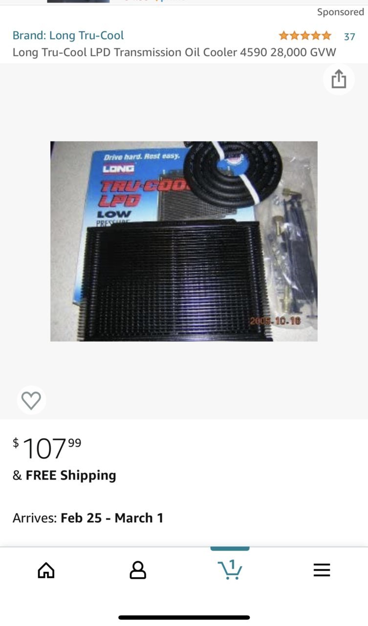

    I ended up buying a tru cool transmission oil cooler 4590 and it’s kicks on at 180 degrees and fully opens at 205 degrees. Now I have to buy the fluid for it. What fluid did you guys go with?

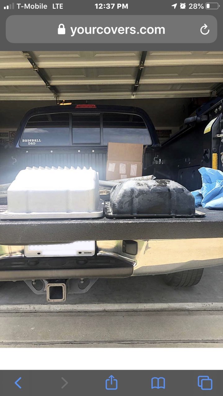

    AB3F0BE2-DF10-4A49-A882-1978FC2584D6.jpg Add this a few years ago. Gave me about 3 extra qrts of fluid. I don’t tow anything and I haven’t put it to the test. I got it from yourcovers.com. They were looking for trucks to give reviews before it went on the market.
