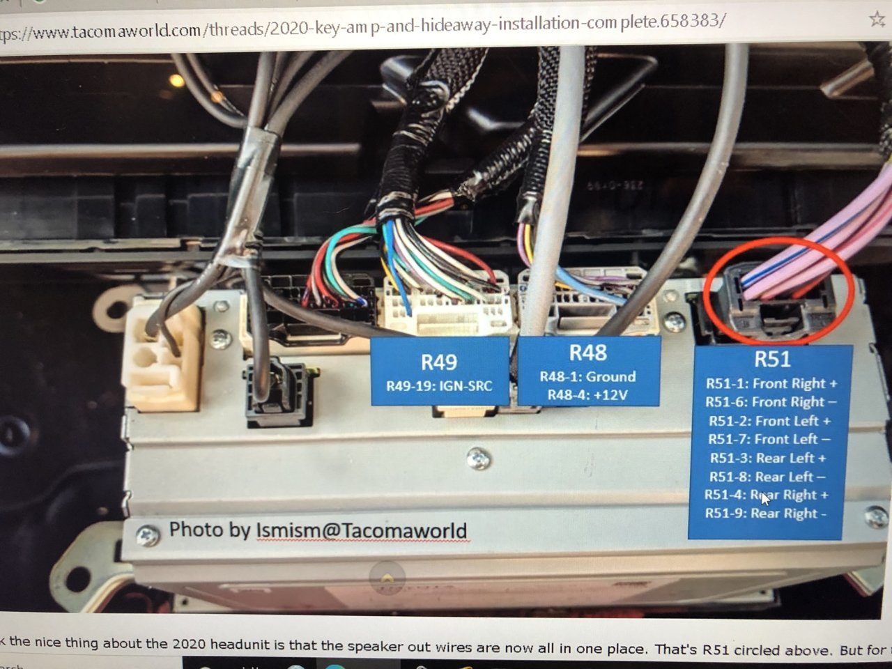

    I bought one from Tac0 tunes.. I had one in the 2015 truck I had along with the ez recurve unit. I just had to order a new harness. The plug on the back of the head unit for the 2020 is different. There are a few threads on 2020 stock head unit with amp / sub builds..

  12. Sep 29, 2020 at 5:47 PM
    JimResnikoff
    JimResnikoff Well-Known Member
    May 31, 2020
    #329981
    290
    JIm
    Tacoma
    Rockford / Focal Audio upgrade

    As far as I can find, only ttunes makes a harness. Metra and other suppliers don't currently make a harness for 2020 Tacomas according to their websites.
    At this point thinking of making my own. Anybody know where to find the right rectangular connectors?

    Thanks! Wow that is a great thread. I'm still trying figure out how to search/locate what I'm looking for in TW.
    I'm feeling adventurous. Might try and locate the right connectors to wire my own harness. Ill update if I find a way forward. Thinking I'll peruse the depths of the digikey catalog.
