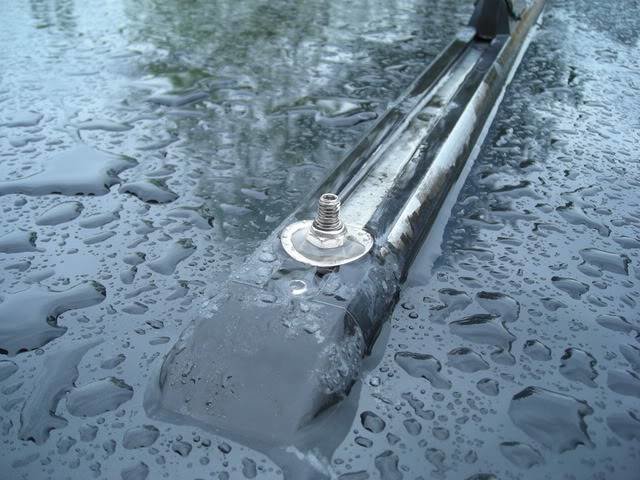

    I have a super simple awning setup on my 1st gen that goes into the roof rack tracks and works with or without the roof racks on (I usually leave them off unless I'm transporting something).
    I got some extra nuts for mounting the roof rack into the track and installed them into the track. They're rectangular with a threaded hole in the middle. I installed a long stainless set screw of the same thread as the nut, then put a washer on top and ran a nylock nut down on top of the whole thing to hold it together, end result looks like this:
    I put one of those at each end of the track. Then, I bought an el cheapo tarp and installed grommets the same distance apart as the studs. When it's time to put up the awning, I drop the grommets over the studs and toss a wingnut on top to keep the tarp on. The non-vehicle side is supported by two collapsible tarp poles. I'm not sure what brand I've got, they were in the cheap crap section of a store like Dick's or Big 5.

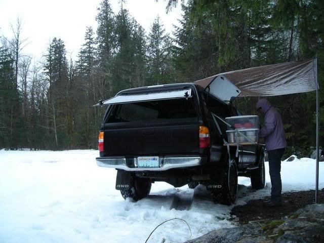

    Finished prototype in action:
    After I tested it a few times I splurged and had a canvas shop make me a custom tarp out of some heavy duty awning material. The downside of this awning is that you have to run guylines for the tarp poles. The upside is that I can install it on either side of the truck. If I'd been thinking, I would have put all of the mounts the same distance apart as the width of the roof rack tracks, then I could put it on either side or the back. Oh well. Another plus is that I can use the awning if I have to go under the truck for any reason.

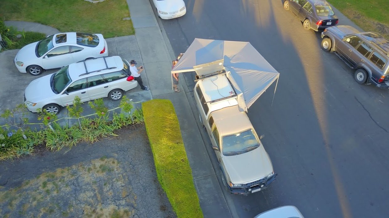

    It doesn't hold up at all in a windstorm. A decent breeze will make the hole thing flip up perpendicular to the ground.
    If there's actual wind I either won't set it up or will guy it out to heavier stuff.
    Alu Cab makes a really nice super sturdy awning but it's $1500. It'll stand up to stronger winds and has legs that fold down for more support and can still be guyed out.
    http://alu.cab/en/270-shadow-awning/
