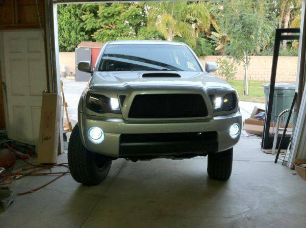

    your daytime running lights on these trucks are your turn signals (in the middle) like here on my truck
    your side markers turn on when you flip your switch to just turn on your "parking lights" then obviously the last setting is turn on your headlights.
    so what exactly do you want done? maybe i can give you an idea of something cheap or something :thumbsup:

    That's what I meant, my drl are like yours in the pic. My foglights don't turn on with my drl's though. I leave my foglights on all the time, but, they only come on when I turn my headlights on though. (I actually prefer that) What I would really like,would be to have my drl's on all the time, and have my headlights automatically come on at night. I might look into the link you posted. They look promising, I'm going to check some places in my area to see if they can install it. If anyone has them, please let me know if you like them. Will installing them void my warranty? Sorry for the long post! Thanx!
