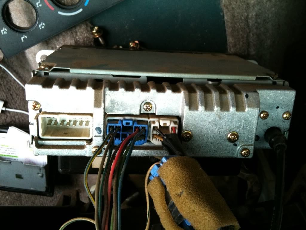

    I have a Toyota Tacoma 1998 with Stock radio/cassette I have been using the Cassette with the audio jack attached to it. I want to add an 3mm jack to it so I can use my iPod/MP3 Player with it.
    I found this http://www.mattgilbert.net/carstereoauxinput/ which is a DIY of how to add it but my situation is that i do not have a CD deck with it. I took it apart and what i have is a port for the CD Drive but nothing plugged in back there.
    I guess my main problem is that i would like to add a Auxiliary jack to be able to press the CD Button on the Deck and just switch it to be the in put for the iPod.
    this is what i am planing on using.
    here is what mine looks like. nothing for the CD.
    here is what it looks like with the CD port plugged in. (from DIY tutorial)
    here is where i would be plugging in the auxiliary jack to
    Any help is appreciated

    Sorry it's been a whole since I checked on this. From what I understand it uses a switch on the radio just like the fm, am, tape and cd. I was planning on trying to use the cd one since that is what I would be inputting the audio through. From the other guide the guy has a cd deck which the wires plug in the back. I just don't know how to bypass that. I don't have the cd deck. I can purchase the harness(?) online but it would help if there was some other way.
    Thanks
