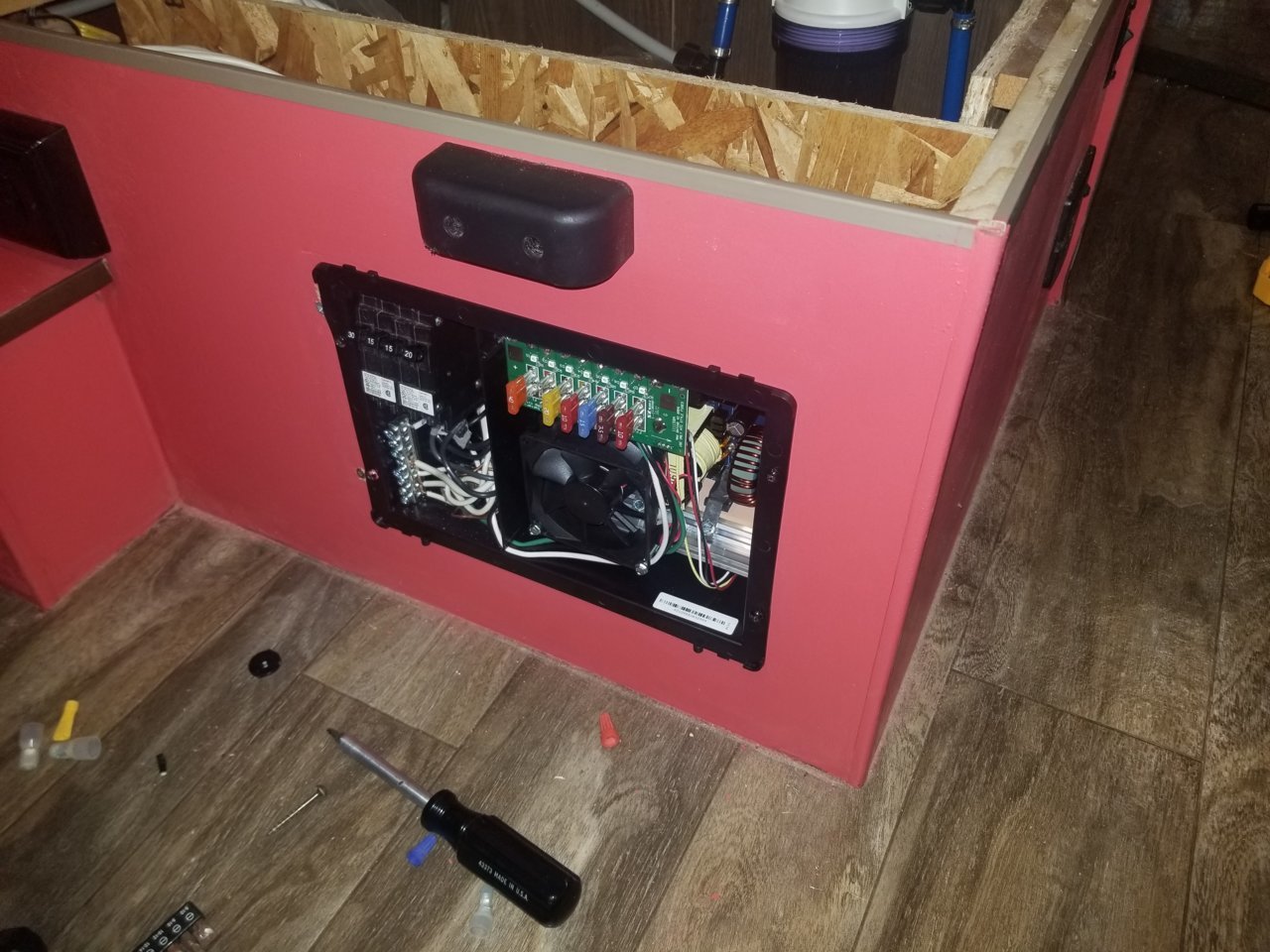

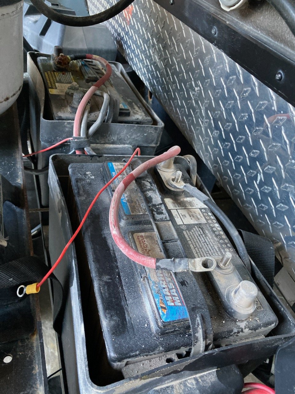

    Old and busted:

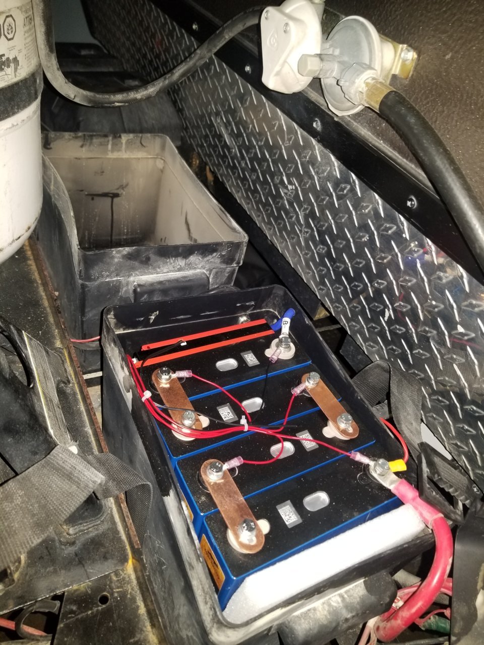

    New Hotness:

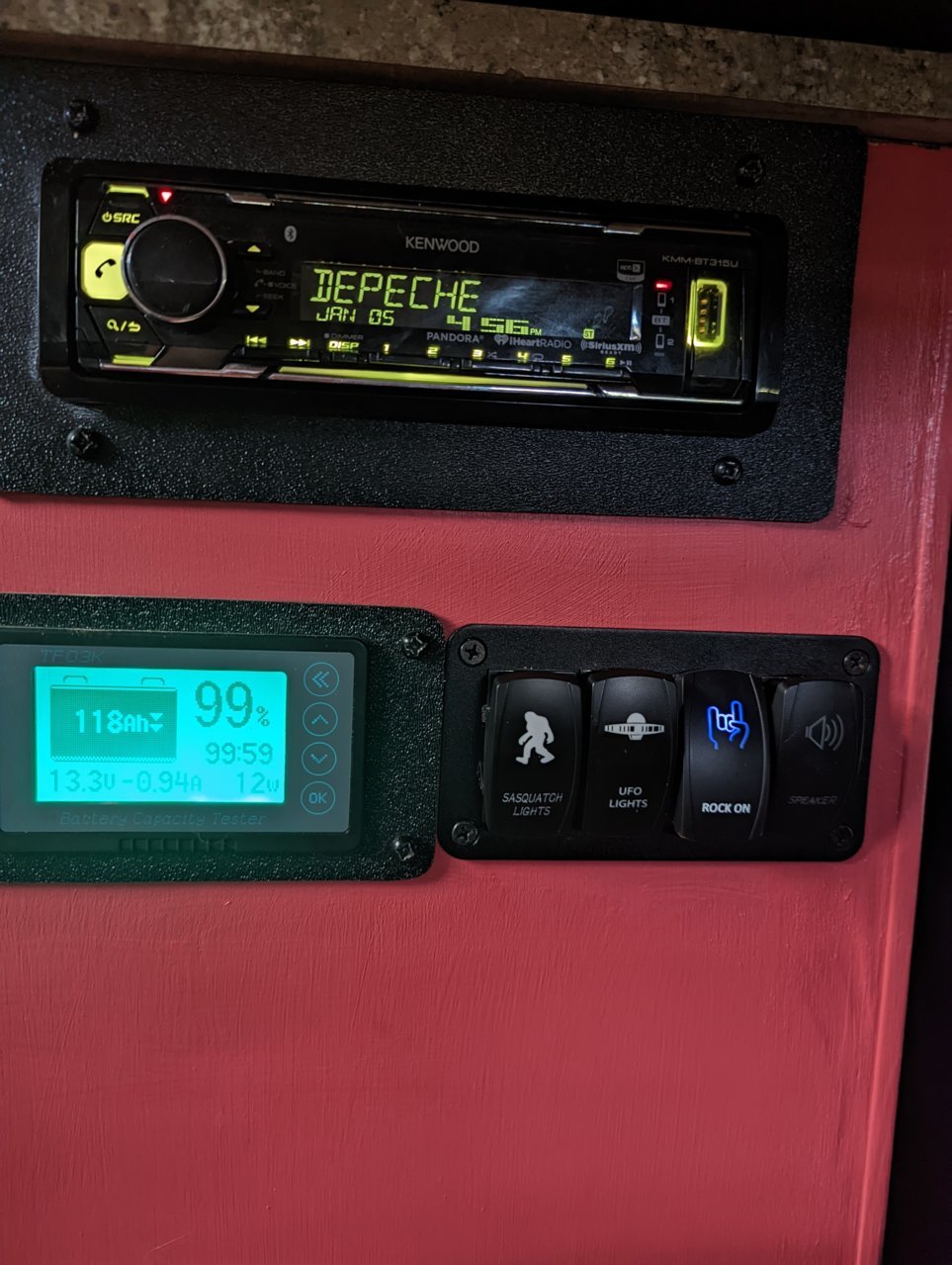

    Monitor panel:
    New power center, as the old one did not have a lithium profile when hooked up to shore power:

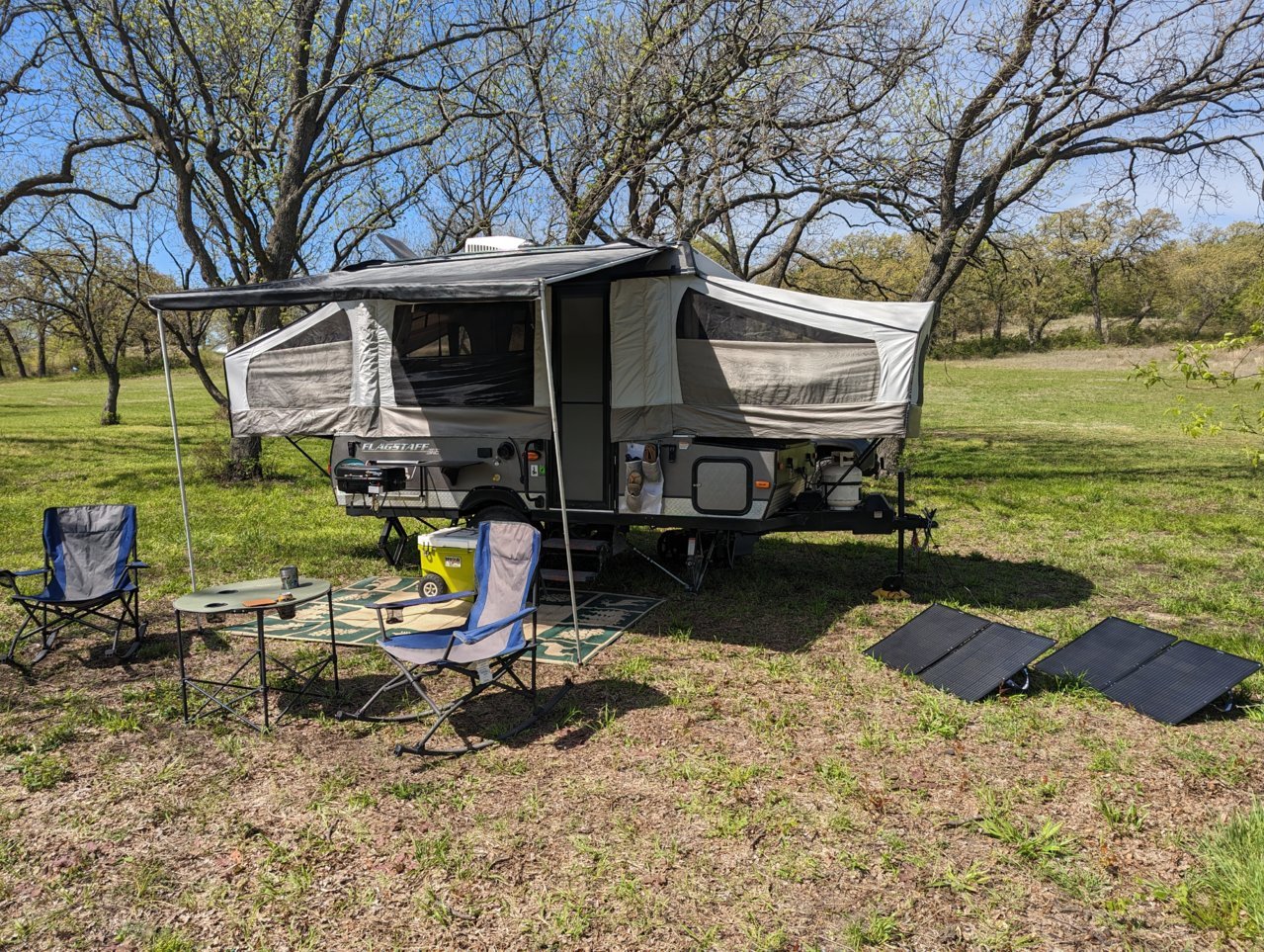

    Solar set up:
