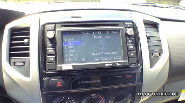

    Hello all. I've searched all around and haven't found any wiring diagrams that would work for me. I'm trying to add the factory clock in the hazard switch panel to my 2015 Tacoma trd sport. If anyone knows what additional wiring, if any, has to be accomplished I would appreciate any input (and pictures would be greatly appreciated as I am novice at electrical at best). Thank you.

    Yeah its not plug and play, 2 wires need to be added according to the diagrams in the other thread, I have been wanted to add the clock myself.

    In that case does anyone know what the wiring diagram for the 15 would look like? I've seen the above listed threads diagrams and although the wire type, (tail light, battery, dome light, etc) may be right, the position of it under the dash isn't between those pictures and the 15's.

    Correct, the clock had been blanked out with a "Tacoma" logo. 50 cents saved x 160,000 trucks per year...
    Common practice with American-brand vehicles - clock is shown in the radio only.

    I have a 2015 and just did the swapover to a hazard switch w/clock. I bought a hazard switch w/clock assembly off of ebay for $95. If you want the clock to have white numbers and you want the hazard button to be black instead of silver make sure you get P/N 84332-04100 which is off of a 12-14 tacoma. I bought 2 terminal repair wires p/n 82998-12690 online from toyota dealer for about $35 shipped. There are 2 wires missing for a 2015. The battery and ACC. I just tapped into the radio battery and ACC circuit because it was right there. I have a entune plus non nav non JBL radio. The repair wires get plugged into pins 13 & 14 on the hazard switch assembly connector. Pin 13 is constant 12v and pin 14 is ACC. I ran pin 13 on hazard switch to pin 4 (Diagram says blue w/yellow stripe but mine had white wire w/blue stripe)on the radio connector that has 10 pins. Then I ran pin 14 on hazard switch to pin 3(grey wire) to the same radio connector. Check pins 3 and 4 with a meter to be sure. I used wire taps to connect the wires. Took about a hour and works great.
