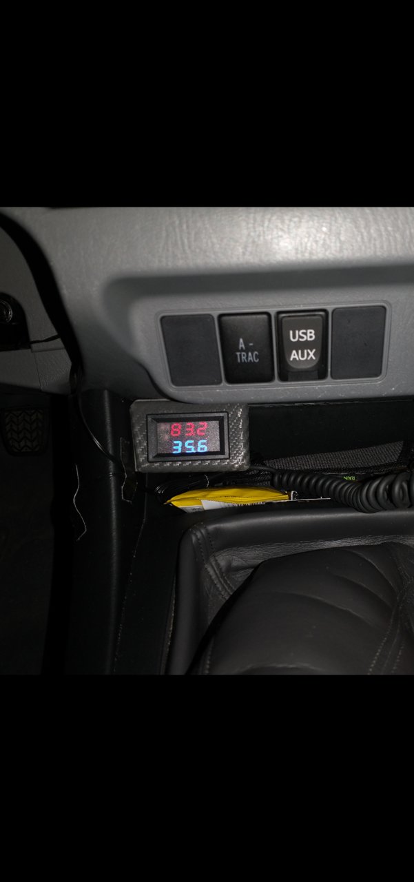

  5. Feb 1, 2021 at 6:28 PM
    winkel
    winkel Well-Known Member
    Dec 24, 2015
    #173039
    2,662
    Corydon, IN
    2014 Spruce Mica, TRD Off-Road, 6 Spd Manual
    Sliders, Tailgate Liner
    I ordered a $20 unit from Amazon, extended the thermocouple wires and made a small housing out of Kydex for it. The black duct tape will be replaced one day but it's been working great for a couple of months now.

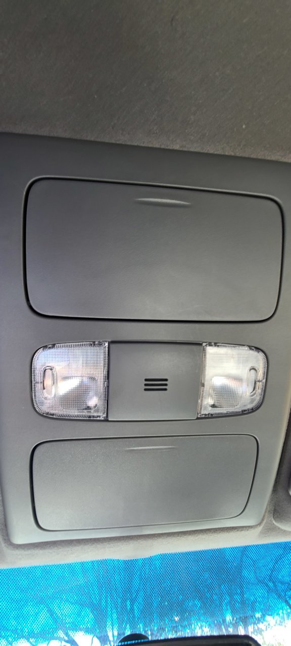

    I finally got around to checking and mine is prewired. Are there any other options other than the Gentex mirror?
  10. Mar 6, 2021 at 4:31 PM
    IL14TacoGrey
    IL14TacoGrey [OP] Well-Known Member
    Sep 15, 2020
    #340898
    70
    2014 Grey Tacoma SR5
  11. Mar 6, 2021 at 5:52 PM

    What does your overhead console have instead of the display?

    I have an extra pocket for sunglasses. Can you get a display that mounts in the 2014?

    The 2014 has two sunglasses holders? Mine is an 06 which is slightly different and incompatible with 2009 and later, but with the 06 the display should fit where the garage opener goes. You may have to replace the entire overhead console if it doesn't fit in yours. Maybe someone else has swapped the display into those overhead consoles if you do more searching.

    On a short research, it looks like the overhead displays weren't a thing in 2014. I wonder how hard it would be to modify the 2009 ones to work or if the hardware is all there for it.

    I believe the overhead display went away in 2012
