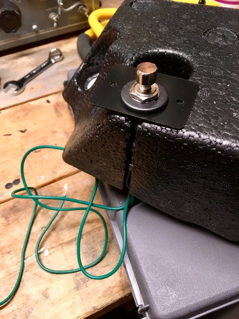

    I’ve got my driving light relays powered by the high beam circuit. But I found I didn’t want to dim way back then drive with low beams for a mile before meeting the traffic.
    My solution was a footswitch on my big lights.
    This way I can hit the switch and turn off the driving lights- keep the high beams on for a bit longer, then switch down when I get close.

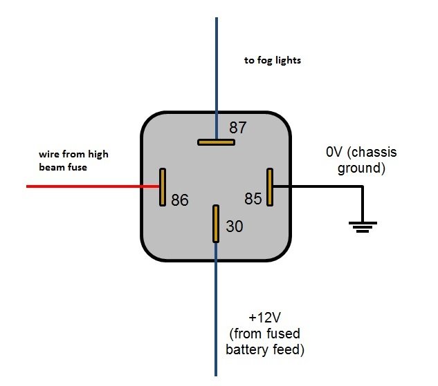

    Can I get a second opinion on this?
    ~'17 with BD Squadron sport as fogs~
    The set up I'm aiming for; everything functions stock except "fogs" come on with high beams. Looking through this thread I think the below would work. Looks pretty much the same as @67siia posted, just a different relay.

    That works if you want your Squadrons on every time the highbeams are on.
    Throw a switch in the red line (86), or the black ground(85) and you have the option to have the highbeams alone.

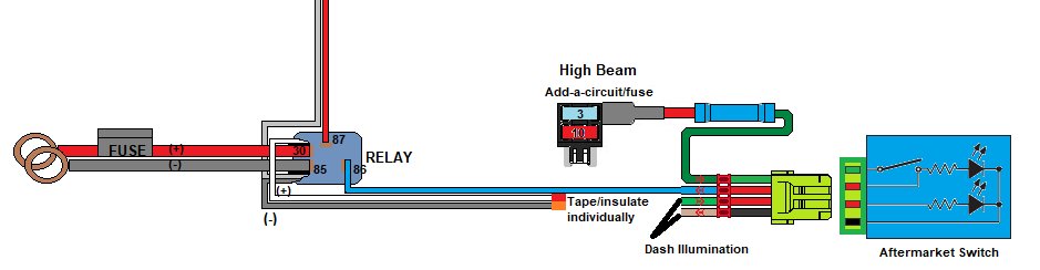

    Thanks for the information - very helpful and seems relatively simple. From memory, there were 4 wires coming out of the switch (black, green and two reds). Black goes to ground (black) on light bar, green goes to white on light bar, and both reds go to the blue wire coming from the light bar. Which switch wire would I tap the new wire coming from the add-a-fuse too?

    Sorry to bug you again @kmorgan3 and @CaliRaisedLed, but how do I specifically connect the fuse tap from the high beam to the OEM switch? I just tapped the LH high beam and connected it to the green switch wire while it was still connected to the white wire coming from the light bar relay. However, this just turned the RH high beam on permanently. I then disconnected the white wire from the relay so that the green switch wire was just going to the wire to the LH fuse tap, and this had things working as desired except for that the LH high beam never turned on (just the RH side). Any ideas? Do I need to try connecting it to the red switch wire instead of the green wire?

    Remove the white wire. Connect fuse tap to green as you did. Verify you properly installed the fuse tap. When you had the white wire and the LH fuse touching each other you may have blown the LH fuse, so check all fuses.

    That did the trick, thanks heaps! Everything is working as it should be!

  14. Apr 22, 2022 at 6:54 AM
    #54
    HoosierAussie
    HoosierAussie Well-Known Member
    Dec 7, 2020
    #348906
    88
    2019 Tacoma TRD Offroad
    Great diagram, thanks!
