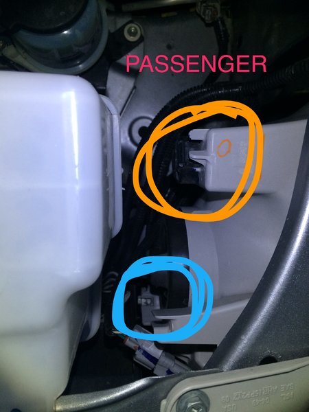

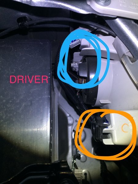

    Can someone tell me which one of these adjust the vertical orientation of the headlights?
    The posts circled in orange have black covers protecting the adjustment, and the posts circled in blue are exactly as pictured.
    I need to aim my headlights further down.
    What do?

    Pretty sure it's the blue one. Pull up to a wall and find out

    You were right, thanks!

    ^^^^^ THIS!
    It took me a stupid long time to figure this out. (And I thought I knew how to work on shit.)
    The "gear" piece meshes with a standard phillips head screw driver bit perfectly. On my 2015 there's even a plastic guide for a long screwdriver for the bottom adjuster.
    Tip: Don't mess with the horizontal adjuster unless you have a reason to.

    Hey don't feel dumb. I was using a flathead adjusting that thing and wondering if I was going to go insane before I got any measurable adjustment. I parked facing a brick wall that was about 15 feet away. Got it down 2 courses before I called it good enough. I'll see how this does and if it needs further adjustment I'll break out the Phillips head tomorrow.

    Thanks for this. I just installed some LED headlights ad they need some adjusting. They sit to high. So judging by these diagrams, it looks like I would fumble with the vertical adjuster. And leave the horizontal adjuster alone. correct?

    also i think an 8mm wrench fits on the adjusters as well. Shouldn't need to touch the horizontal adjusters if the light center is in the right spot.

    No wrench needed just a Phillips screw driver.
