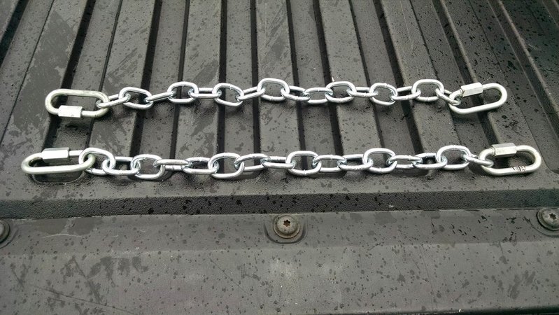

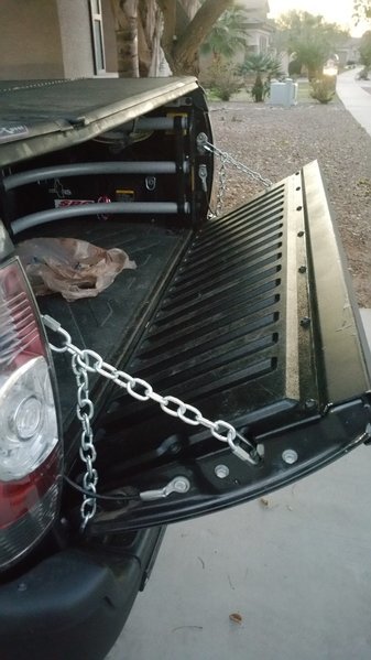

    Hey All, Joined the forum today just to show this off...
    I've been looking for a way to safely and securely hold my tailgate up at an angle when hauling my YFZ in my DCSB. Normally i'm happy leaving my tailgate down but I'm now towing a trailer as well, and the tailgate would hit the trailer jack. On my dad's Chevy Colorado the cables have a second attachment point to hold the tailgate at the perfect height to lay a sheet of plywood level between the fender wells and the tailgate and it's been very useful. After finding no similar solution online we made something ourselves.IMG_20170219_133221577.jpg

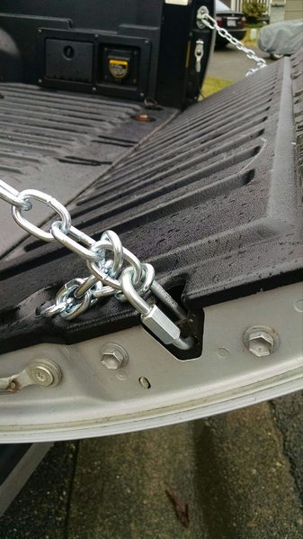

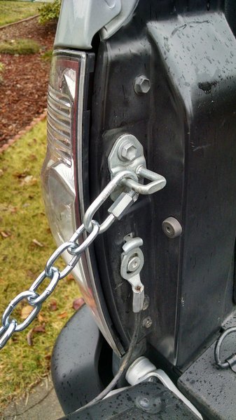

    1/4" chain links are able to fit into the latch in the tailgate. On the top I added a 1/4" screw lock carabiner to hook to the normal tailgate latching point. The carabiner on the tailgate end of the chain isn't 100% necessary, but it is much easier to grip when pressing into the latch. To release the tailgate simply pull the handle. I purchased 30 inches of chain, and ended up cutting about 6 links off. Links can vary, but it ended up being 16 links for each side, plus two carabiners. I can now adjust my tailgate to any height/angle I want and i'm only out about 10 bucks. When not in use I just throw them in one of the bed cubbies.
    Hopefully this comes in handy for others! Now I'll be able to haul all my toys to the dunes next month!

    Using the full 16 links it does lay flat... but I guess I never thought to take a picture of that. But I promise, it looks the same as with cables... accept with chain too :)

    Edit: the only downside to this method is when u hit a bump the slack on the chain will cause the tailgate to bounce (unless theres weight on the gate to hold it down) and hopefully the door latches don't let go of the chain, unlikely, but possible. cables are still there to catch the tailgate but none the less, keep us updated on use and if anything bad happens haha still cheaper then 200$ haha

    You're right on the bounce, I'd suggest only running like this when you need to. My dad hasn't had any trouble with his bouncing (and his truck was made that way) even with just a couple 8ft 2x4s. As for the tailgate latch popping loose... make sure you push the carabiners into the latch til they click the second time and hope for the best :fingerscrossed:
