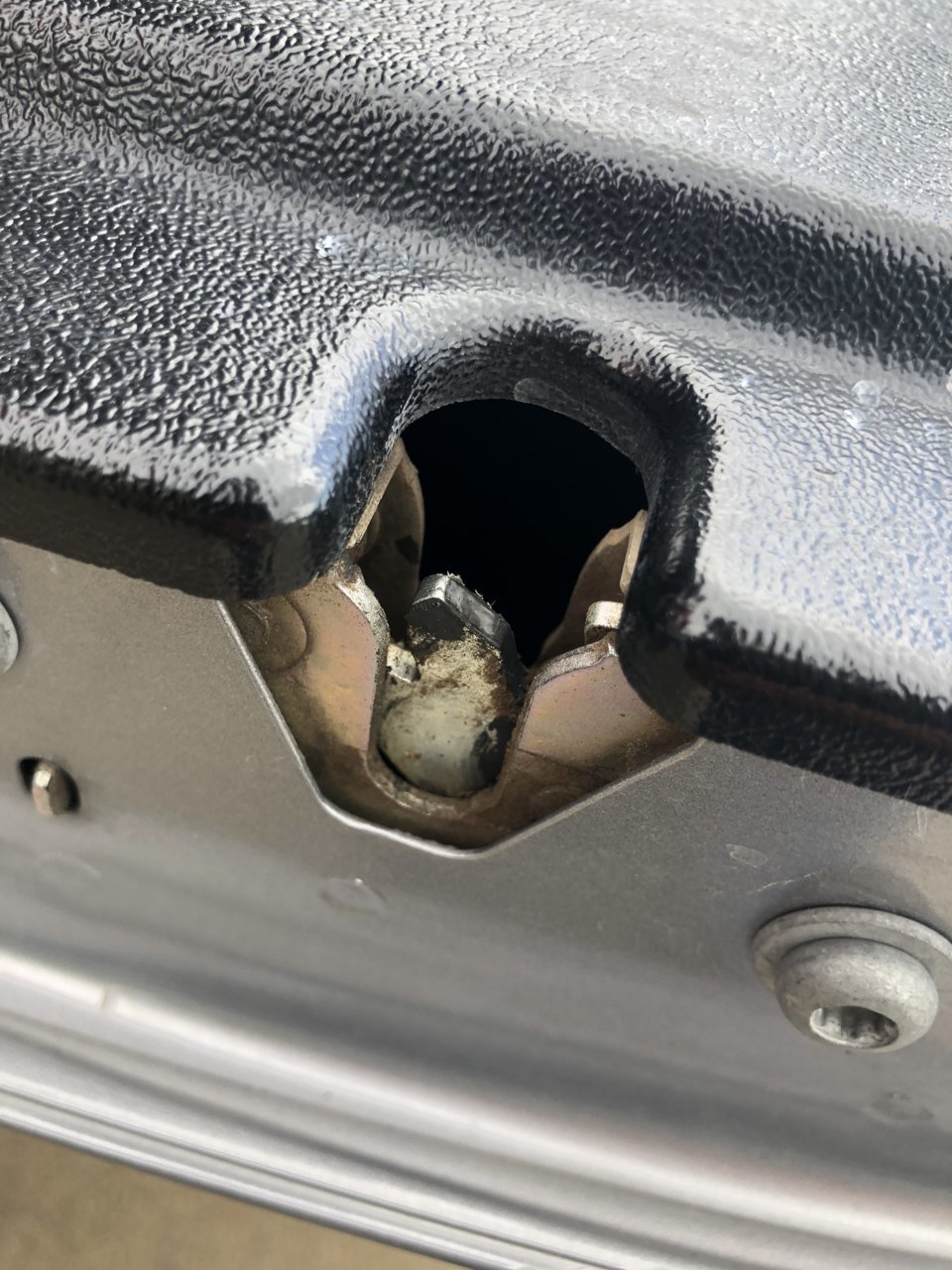

    Anybody have a picture of their tailgate? I'm wondering how you are attaching the cable to the tailgate itself. I don't really see it staying clipped on too well with mine. Maybe 3rd gens are different.
    Heres what mine looks like.
  10. May 25, 2019 at 3:36 AM
    #30
    Backt
    Backt Well-Known Member
    Dec 2, 2013
    #117792
    417
    Oregon
    2012 Tacoma DCSB Off Road Pryrite Mica
    It doesn’t clip on like your thinking. Look at the oem bar that latches the tailgate in the 1st pic with the chain links attached a few inches above the oem cables. It is a 1/4” bar. The 1/4” chain links snap into the latches just like the tailgate does when closed.

    Yep! I finally got it figured out. Thanks!

    Make sure you hear the TWO CLICKS as the latch clasps the chain or you won't have it fully secured.......!
