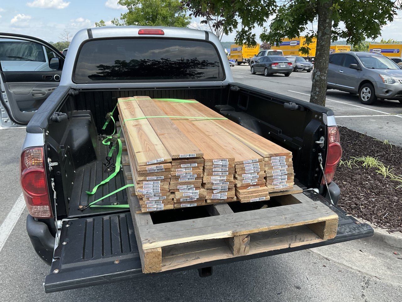

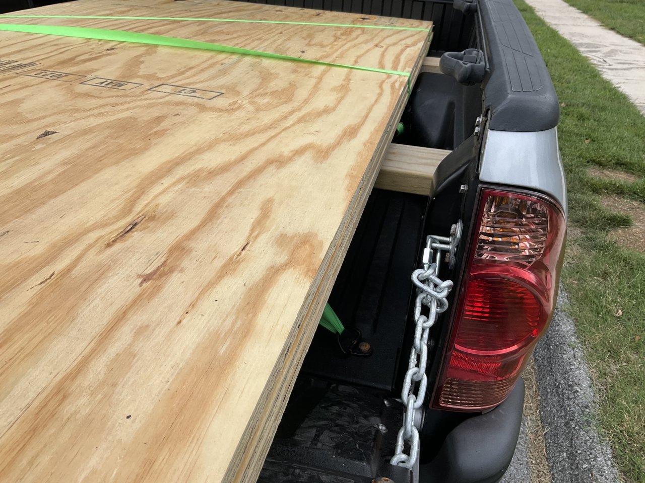

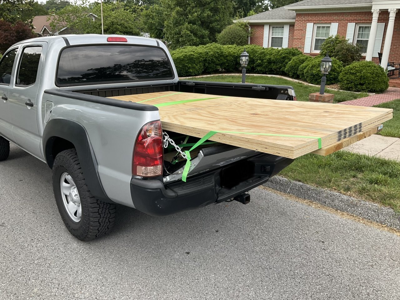

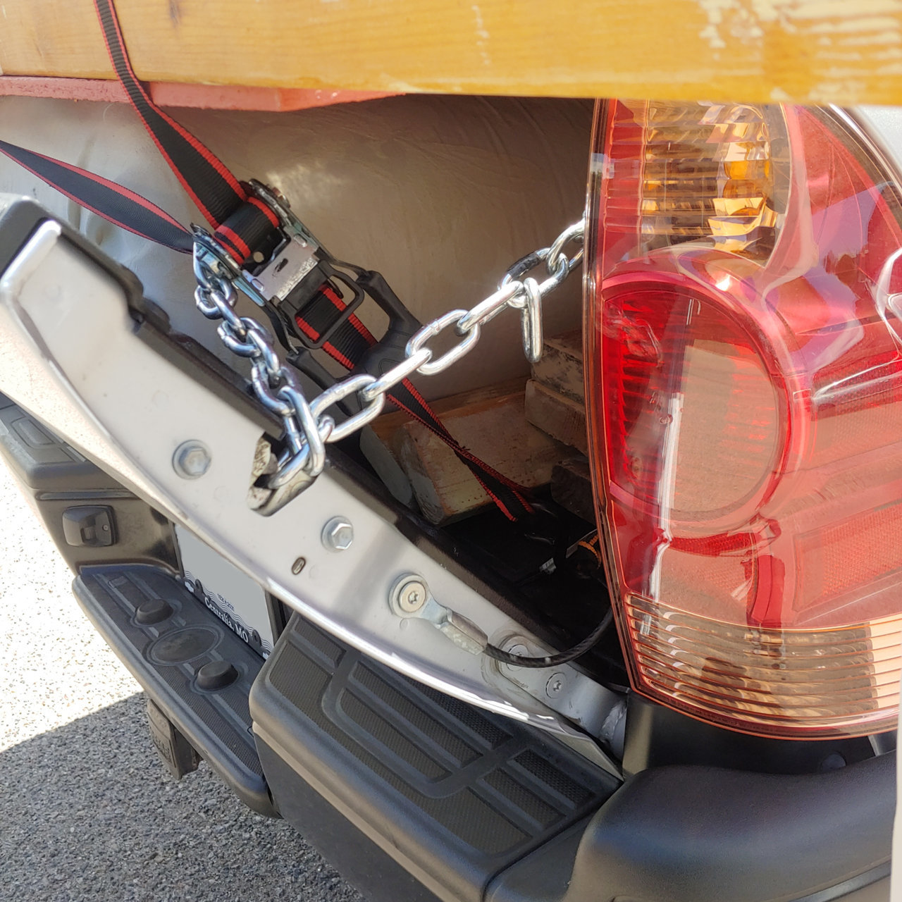

    Bazinga. 1/4 Chains man.

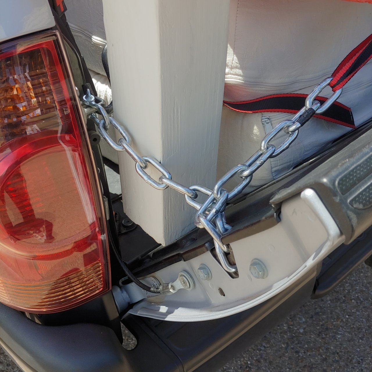

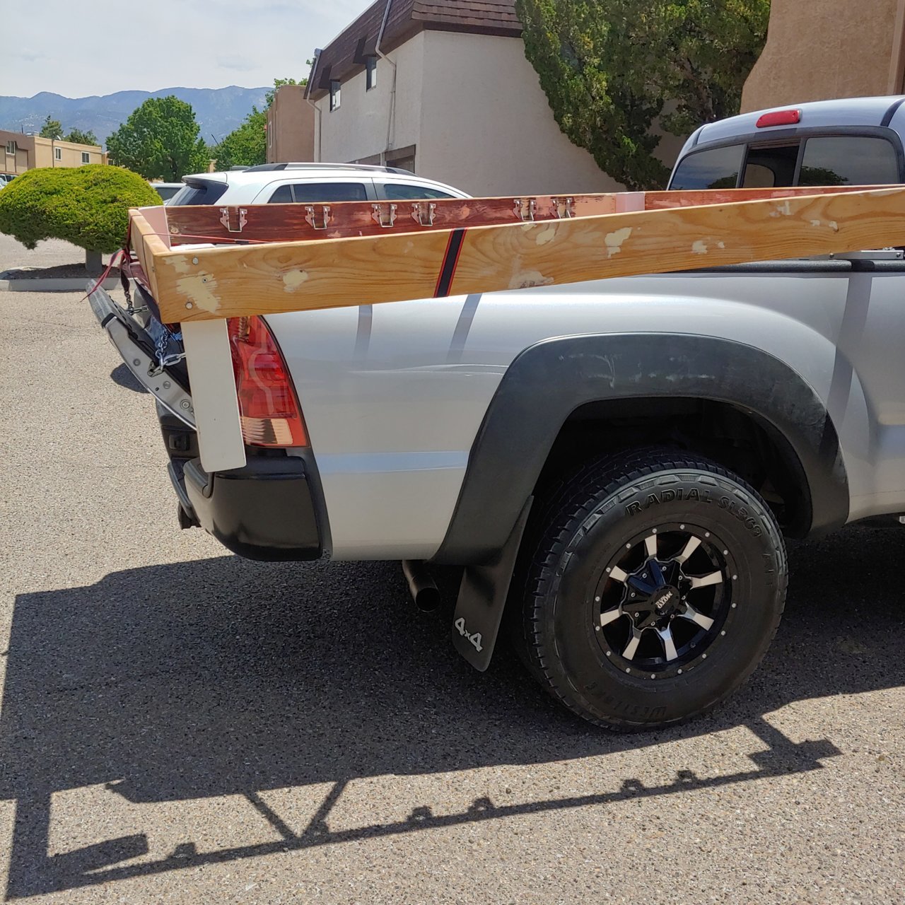

    Picked up the chain when I first saw this thread a year ago, forgot I had it until I moved this bed today. Very handy! Thanks @YF_Ryan

    When chains were stock for tailgates, they often came with a rubber tube cover so they didn't scratch and clang. Check out vintage truck parts. They also had a "J" hook on one end that allowed for the in between adjustments.

    This is such a great idea. I'm going to the store right now to get some chains. What size carabineers are you using?
    YF_Ryan[OP] likes this.
  5. Aug 6, 2023 at 10:38 AM
    #45
    vanhalo
    vanhalo Well-Known Member
    Jul 3, 2022
    #400580
    112
    same size as the chain links. 1/4”

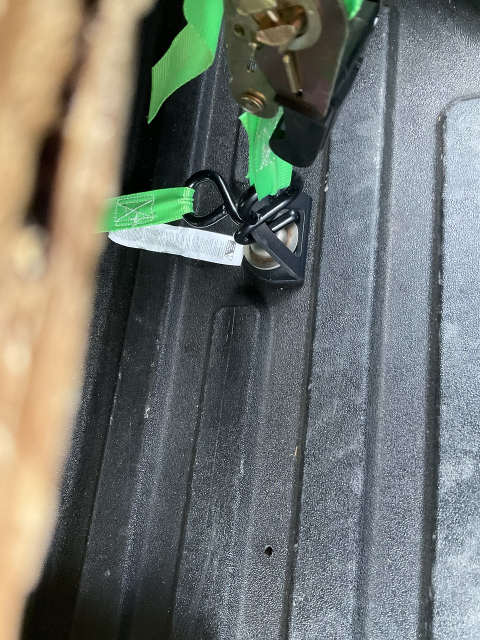

    I think you need bed bolt tie downs for this to work effectively.

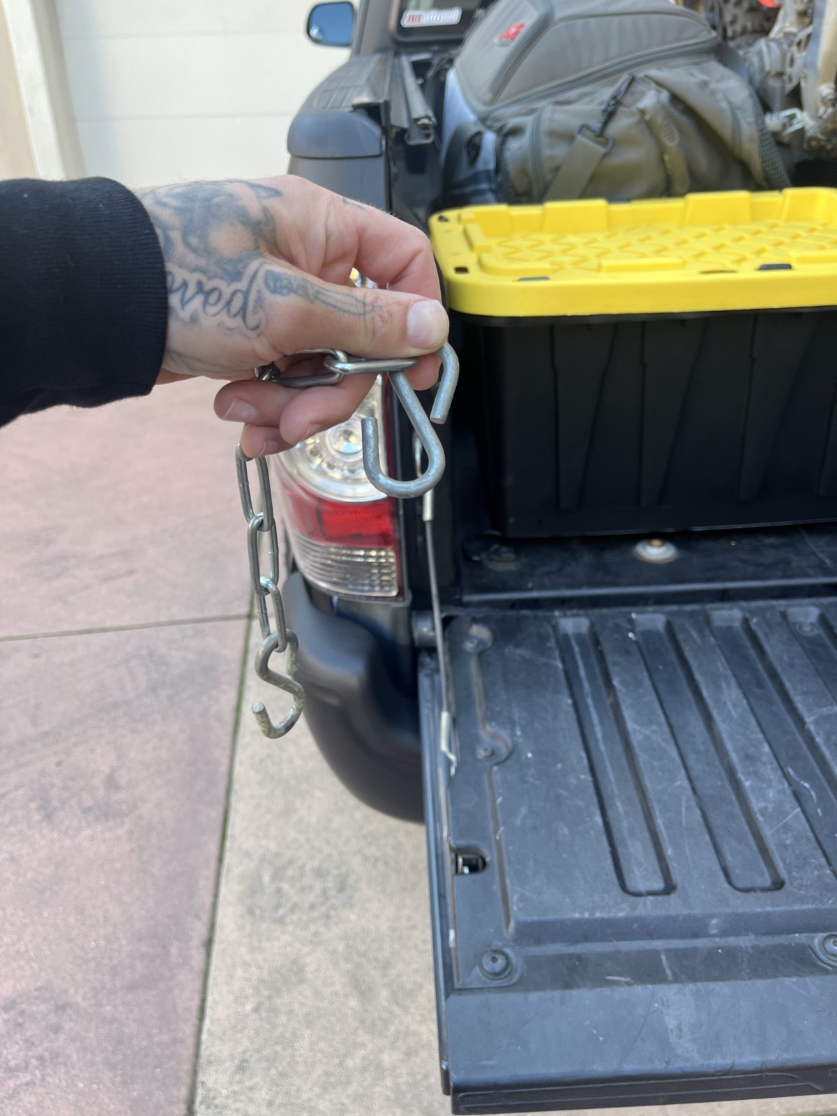

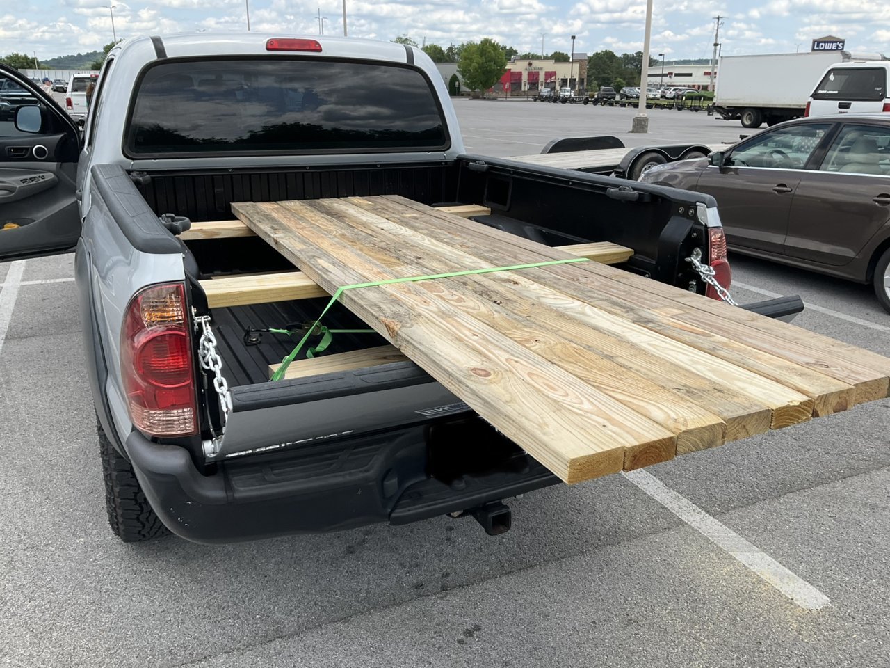

    This thread was very helpful. I ended up making these which are very similar but smaller diameter chain and S hooks instead of carabiners. Big hook points out away from truck, two clicks and it’s set

    Just be careful if you hit a speed bump or something. Your tailgate can easily bounce upwards and the hooks could fall loose. Obviously not an issue if you have a load strapped down that holds your tailgate from bouncing. :thumbsup:
