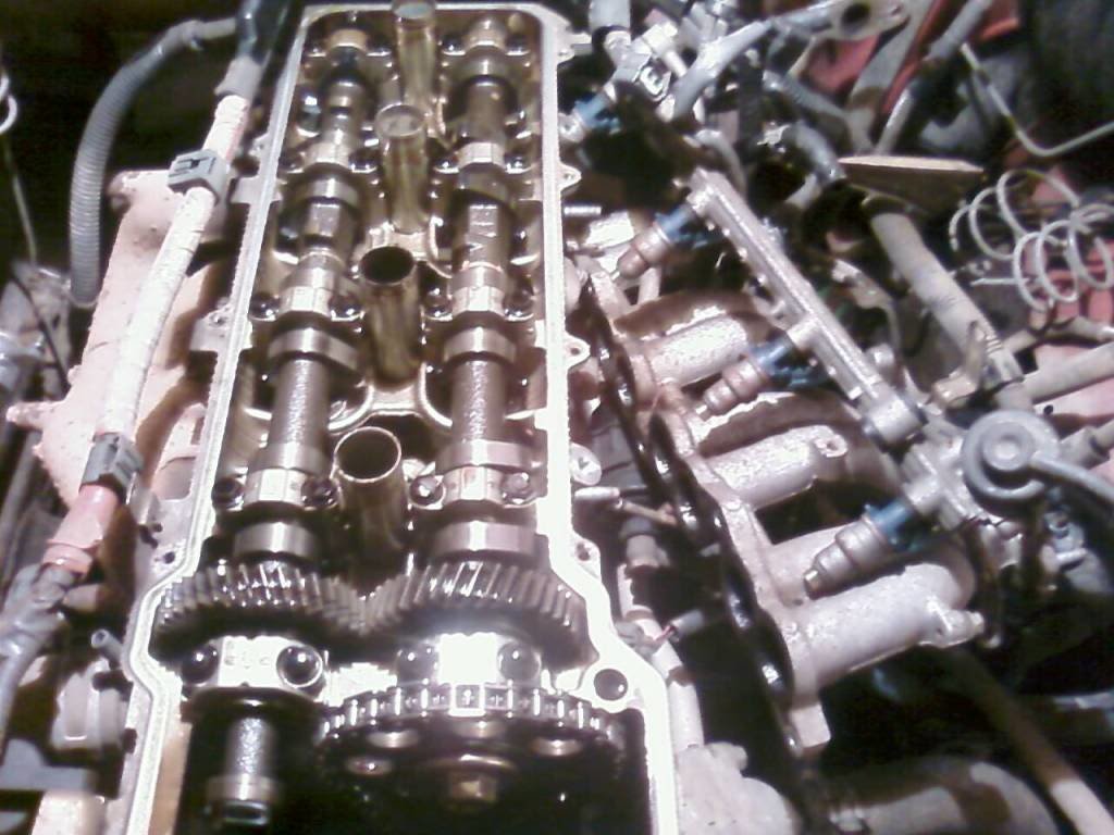

    tacoma prerunner
    3 inch lift in back 1 1/2 front. 31' mesa A/T's. Alpine deck, alpine speakers, l5 kicker solo baric sub

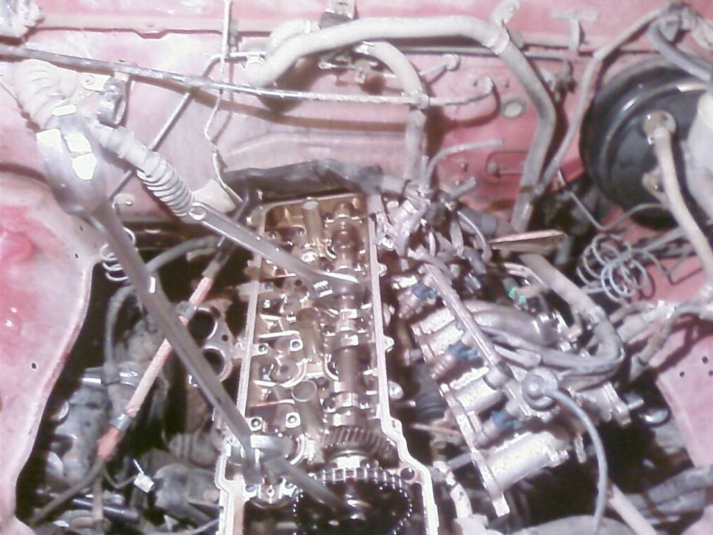

    open her up and have a look guys... see anything you can adjust here? I don't... see waldo anywhere?

    I am setting them all at 012 in case anyone wants to know lol my michanic ordered the exhaust valves and they were $20 each so in the end its about a $450 job

    First off your not supposed to turn the motor by the cam, especially not with a crescent. Do it right and turn it with a 19 on the crank. Second, the adjustment is the shims. Exact same setup as motocross bikes. No lifters, no pushrods, no adjustable rockers like on Hondas. Just cam, bucket, shim, valve
