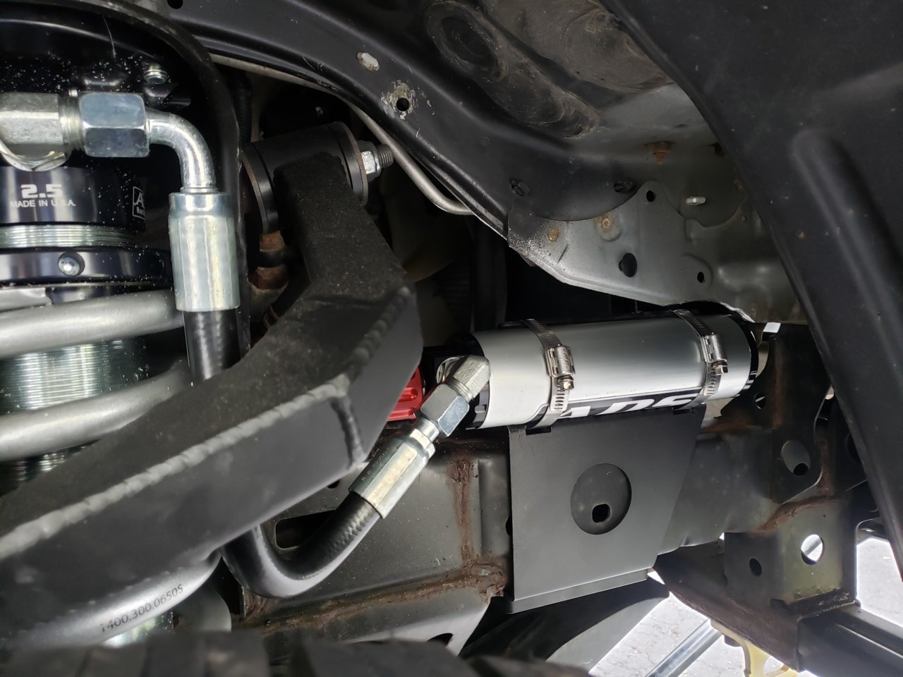

    Anyone have experience with the remote reservoirs moving enough to hit their frame? We have terrible roads in Omaha and when one wheel hits a sizable bump, it sounds as if the 90* fitting going into the reservoir is hitting the frame. Haven't pulled the mount apart yet just seeing if others have had similar issues. I absolutely hate clunks/thuds and other noises in general and this one is driving me crazy. Already pulled my sway bar as the relocation kit moved the bar into the frame brace shown here... https://www.tacomaworld.com/threads/sway-bar-and-a-power-steering-pump.609869/#post-20649685
    Edit: spent about an hour on this when I got home. Pulled both mounts and found the tip of the reservoir hitting the body seam commonly in the way of the upper control arm bolt. Since the shock is aluminum this interference was actually eating away at the body of the reservoir. I would have moved the reservoir back if i could get the hose to play nice but I've had the same issues with getting it in the right spot as many others have noted in this thread.
    I cut a piece of rubber outdoor mat and placed it between the mount and reservoir body and it essentially filled the gap. Took it for a drive and no more rattle! Gotta love getting rid of unwanted noises.

    Trim it back a little. That was part of my way of getting it to fit. I forgot to post it here but i'll try tomorrow to take some pics and go into detail of how i got mine to fit best

    Way late with this update, I actually got the reservoirs clocked pretty easily with some sleep and a level head in the morning. Once I got the hang of adjusting the fitting and hose it wasn't so bad. My issue was compounded by having boxed UCAs (LSK) which left about 6mm of space maybe less on each side of the hose at full droop. The big ticket to getting them fit for me was facing the fittings out and trimming the fender well a little at the front of the mount location. Only needs about a cm by 5-6cm section cut out which allows the resi to be pushed forward enough that the hose isn't stretched or jammed tight against the coil. Once I got the hose tension right I could rotate the resi to get the hose to sit where I wanted between the coil and UCA. Frustrating to deal with all this first time through but once I got it I got it
