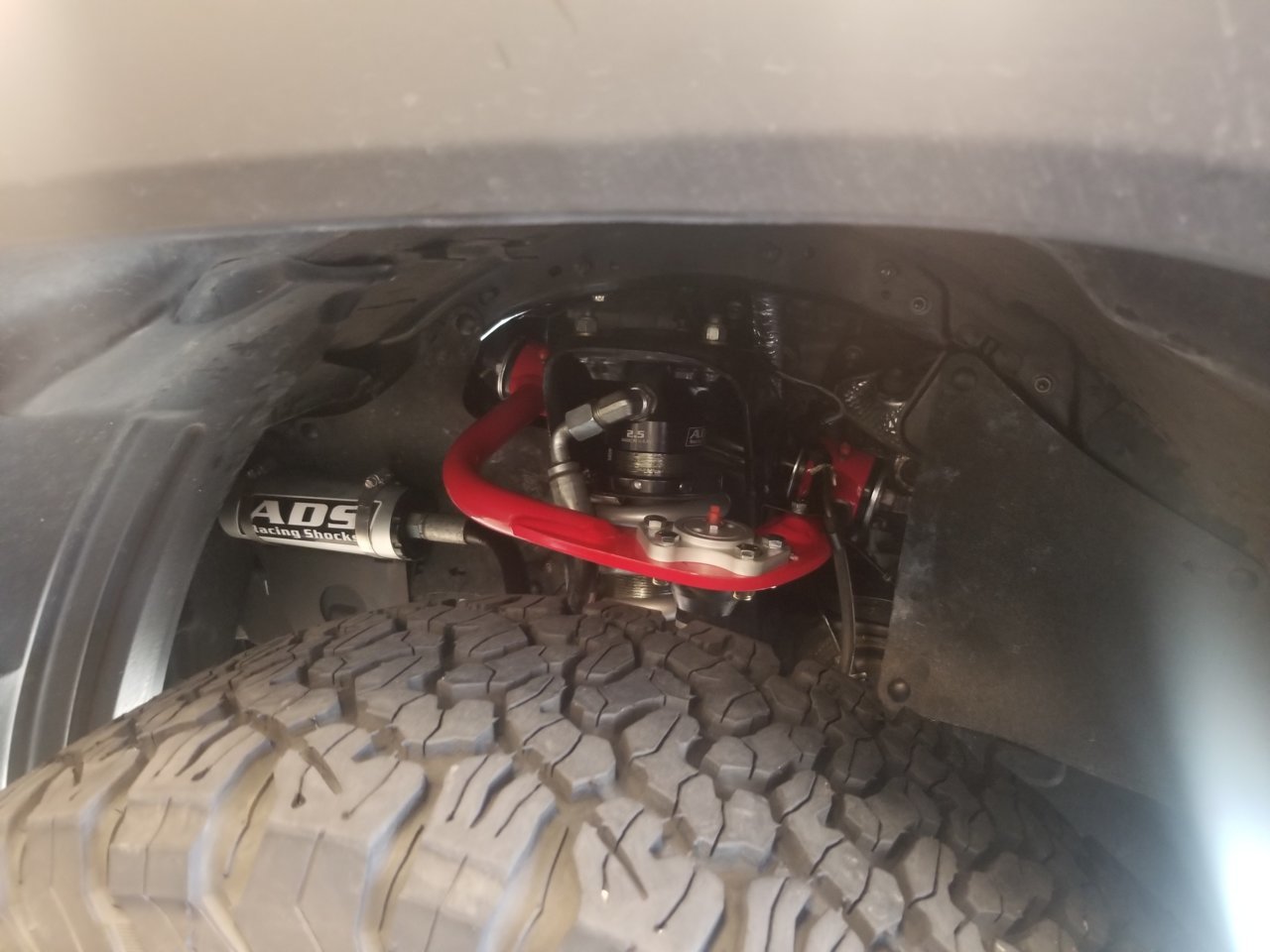

    Ok, so the groaning when hitting speed bumps still exists. Shop is saying it's my ADS coilover. They said it's either still breaking in (1 year and 10k miles later) or it was defective from the start. Anyone else have this issue?
    When hitting a bump, and the coilover is being compressed, I'm getting a very audible groaning sound, like dry rubber rubbing on something.
    I got them from @HeadStrong Off-Road less than a year ago.
  9. Sep 22, 2019 at 9:53 AM
    #3389
    Shortman5
    Shortman5 Well-Known Member
    Mar 30, 2013
    #100952
    2,725
    Supercharged TRD
    TRD S/C, ADS coilovers.
    Sounds like dry bushings.
    Bertw192[QUOTED] likes this.
  10. Sep 22, 2019 at 9:55 AM
    #3390
    Bertw192
    Bertw192 Well-Known Member
    Aug 3, 2017
    #225852
    14,460
    Bert
    Seattle, WA
    2017 TRD OR DCSB
    All the things!
    Bushings on the coilovers? Where exactly and how best to remedy this?
  11. Sep 22, 2019 at 10:01 AM
    #3391
    Shortman5
    Mar 30, 2013
    #100952
    2,725
    Supercharged TRD
    Bushings in the UCAs. You need to loosen the bolt that runs through the UCAs and grease the zerks with a PTFE lube until it starts to seep out from the bushings. Then tighten them to spec and wipe the excess off.
    It doesn’t sound like they’ve been greased so you need to be careful and watch them. If they’re seized it could start to push the bushing out and you may have to completely remove them to fix it.
    Also, find another shop.

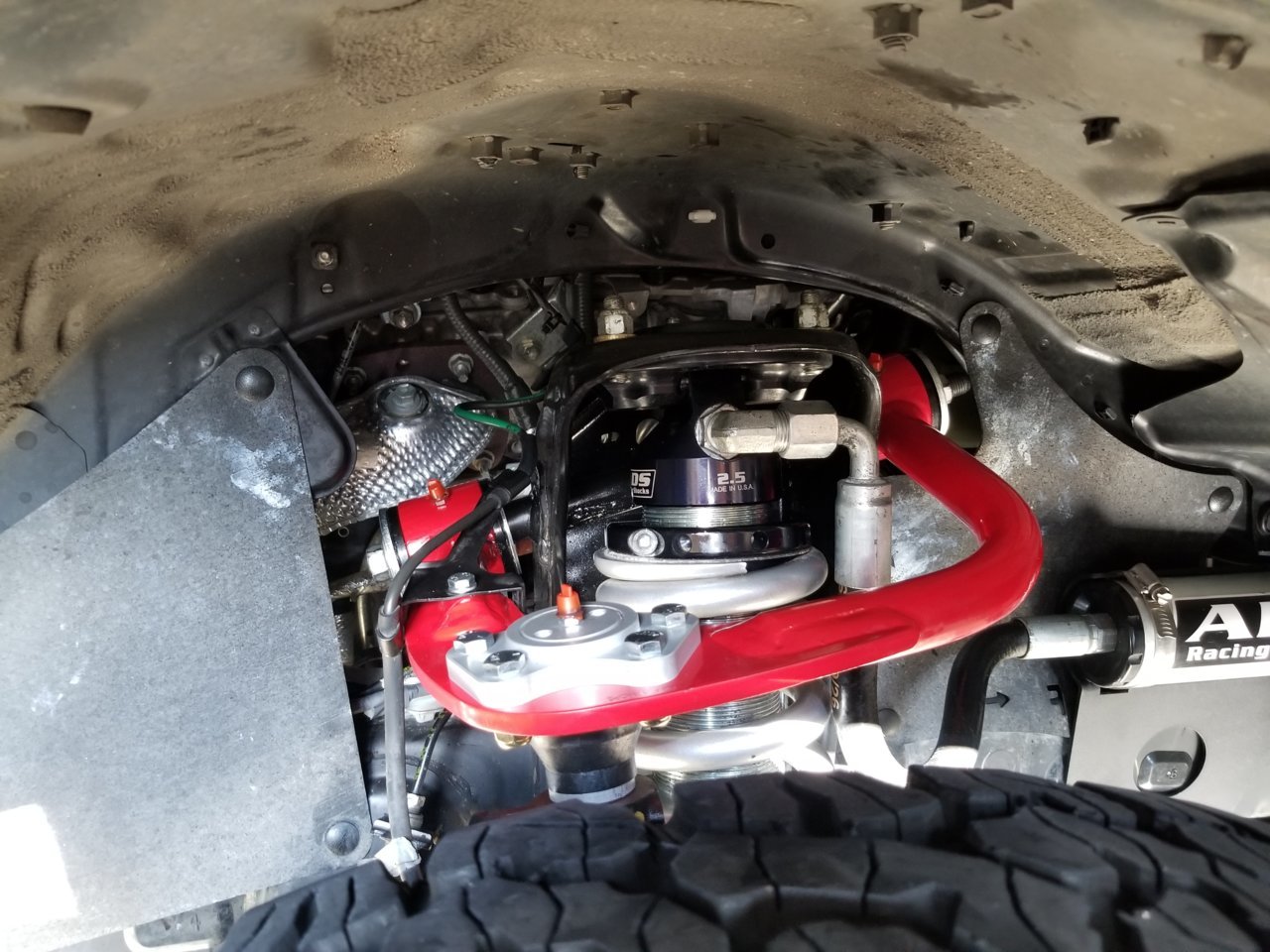

    Could it be the rubber bushing in the UCA? My SPC do this
    ready6delta and Bertw192[QUOTED] like this.
  13. Sep 22, 2019 at 10:28 AM
    #3393
    Bertw192
    Aug 3, 2017
    #225852
    14,460
    Bert
    Seattle, WA
    2017 TRD OR DCSB
    All the things!
    I thought it was, hence I swapped my Icon uniballs for the JBA's. But even with the swap and liberal greasing, I'm still getting the same noise.
