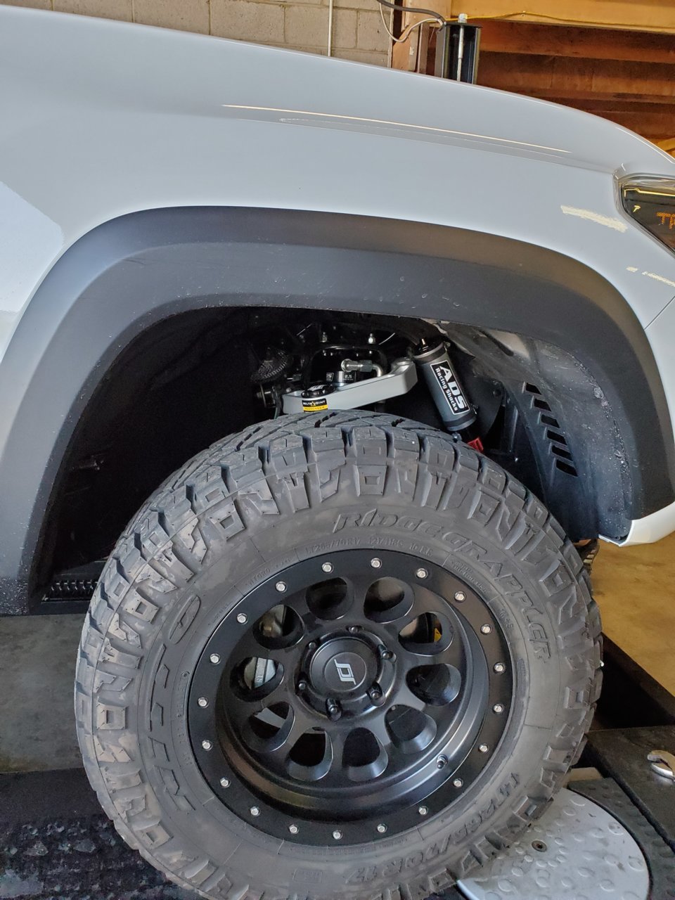

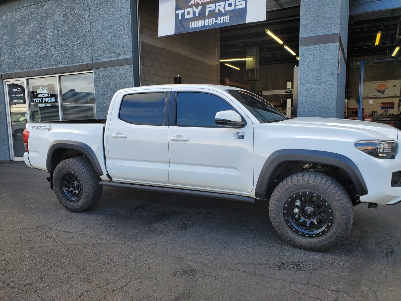

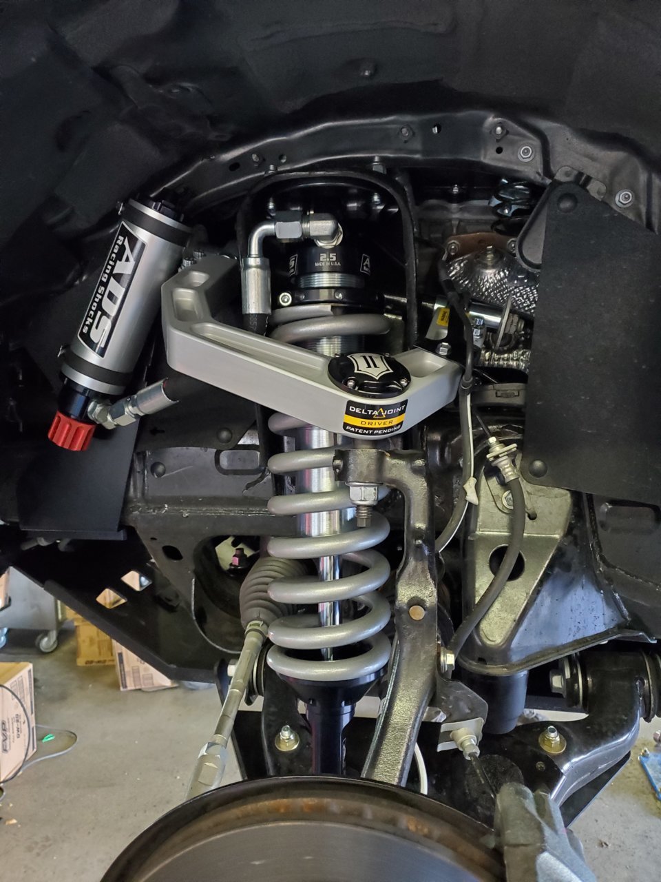

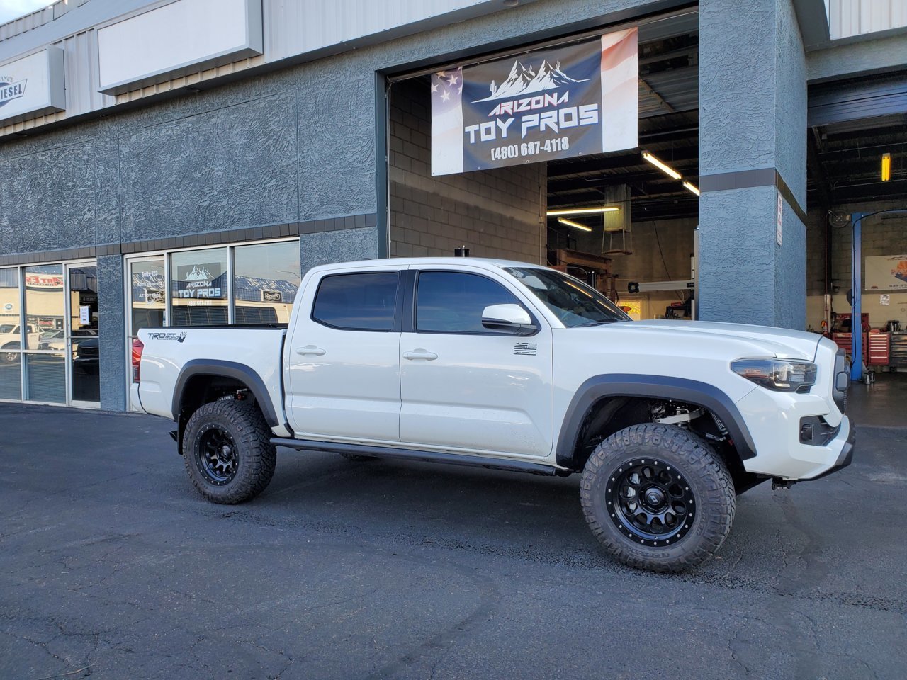

    Just got these on today, they feel so good, 700lbs and 22.5 inch from middle of hub, planning on adding weight later on but 8 threads showing on driver and 5 on passenger. Thanks for @state48overland and Ben for hooking it up at aztoypros

    Looks great UC!
    Clarification on the specs:
    Currently 265/70/17 tires
    (plan to eventually run 285/70/17)
    Goal to keep lift proportionate looking at this time with current tire size
    Installed ICON RXT pack left at option 1, (23 7/8" center hub /bottom fender in rear 1 7/8" over stock) your current offroad/camping weight keeps it 1/2" above level when loaded up
    700lbs spring rate coil-overs (came at 6 threads on driver side and 3 threads preset from ADS-which was perfect for about 2" of lift)
    Goal was to get to 2.5" lift in the front, (set driver side to 8 threads and passenger side to 5 threads-center hub/bottom fender-22.5") springs will settle in a bit-then we can touch up adjust it again for you!

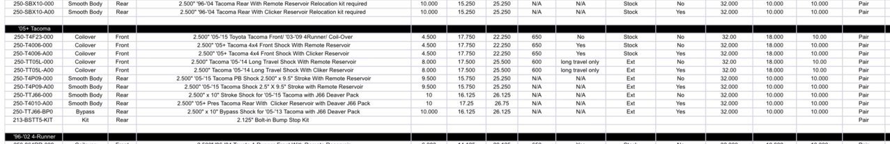

    The stroke is the first column after the description. Add 1/2” for extended length
    This is directly from ADSs 2019 product spreadsheet. Sorry it’s small, had to d a screenshot since it wouldn’t let me load the file on my phone

    Awesome, thanks! Any idea how close it is to 1 or 2" for the extended length? I'm going to be measuring my droop because I top out more than I expected for being at 2.5" of lift and trying to make sure I actually have the extended travel version that I ordered. I guess I'll know pretty soon if it's at least an inch more than the 4.5" spec.

    2” of lift should set you right. Extended travel is really only 1/2” longer.
    I run 1.5” of lift with the extended travel and the ride is cherry

    It seems to me that ADS doesn't make a mid or standard travel coilover length. Only 1/2" less stroke than stock?
    Mine are right at 4.5" till metal contacts, not 5" like i first measured, fixed that above. That seems to be their stock travel length according to your chart.

    Interesting. Not sure because I’m not a shock expert, but 5” does seem accurate for stock stroke

    Spey, can you upload that whole file.
    I'm wondering if it says anything about a mid travel or extended travel kit.
    I'm starting to wonder if ADS even sells a mid travel kit, or ever did.
