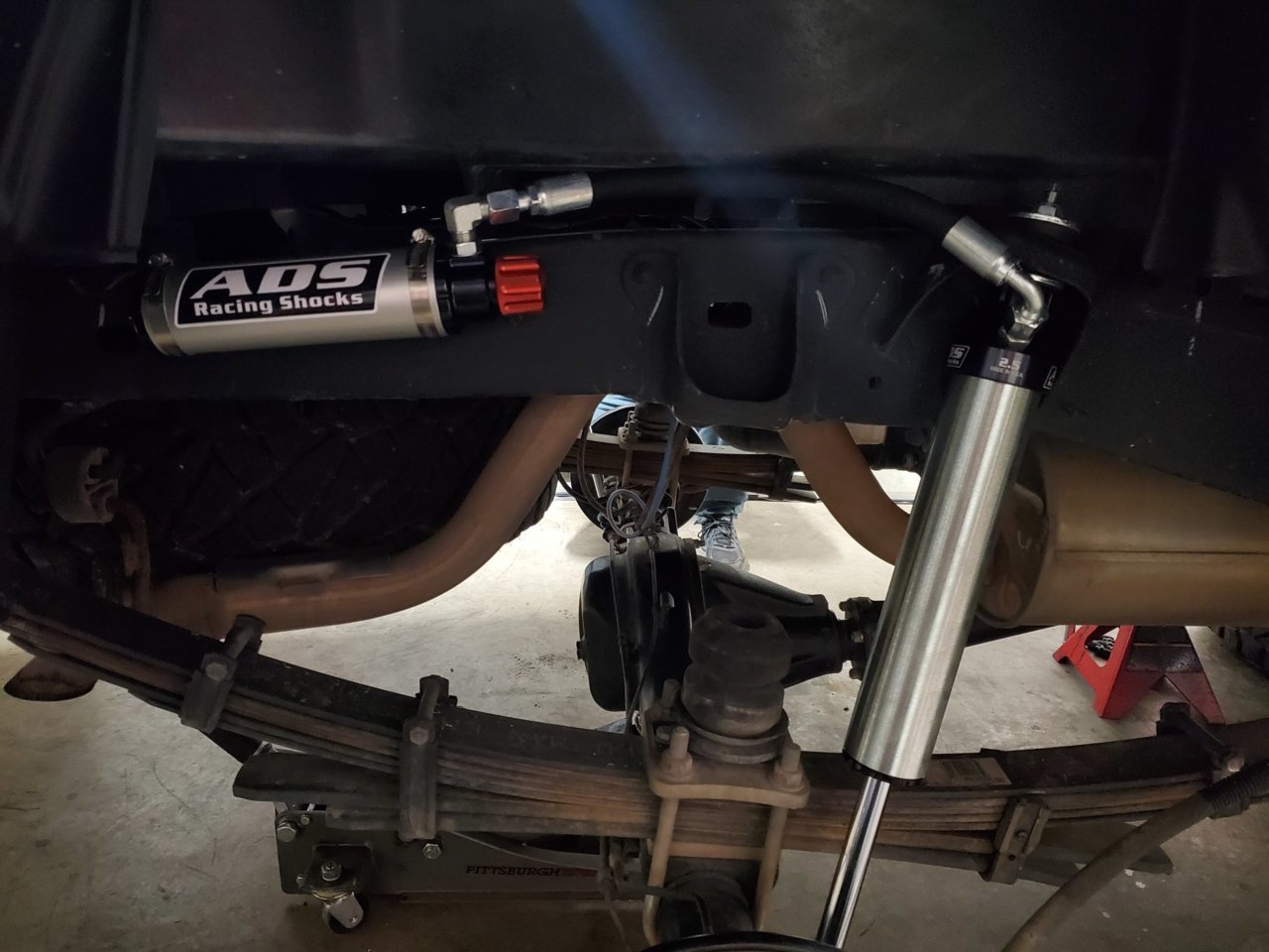

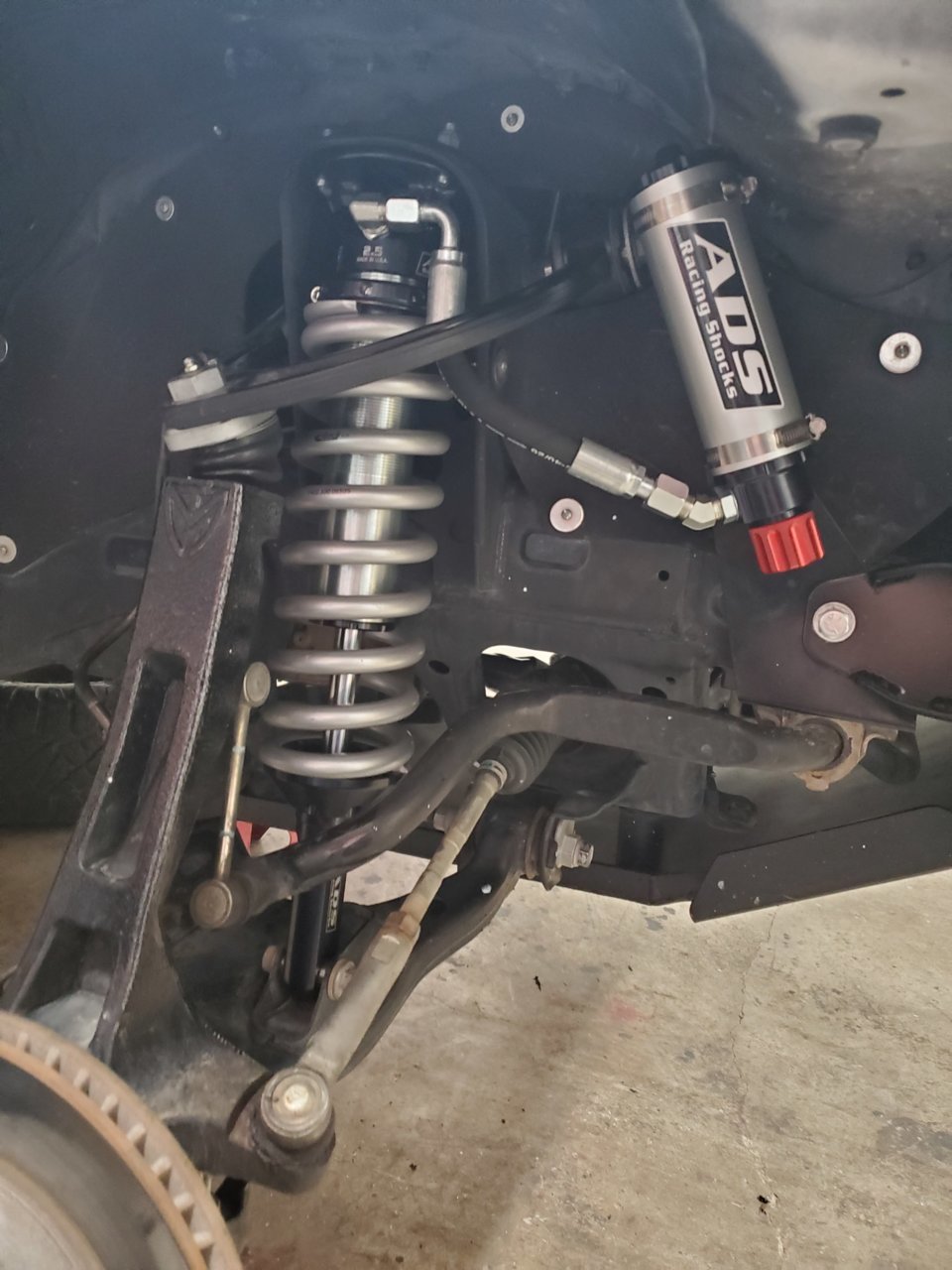

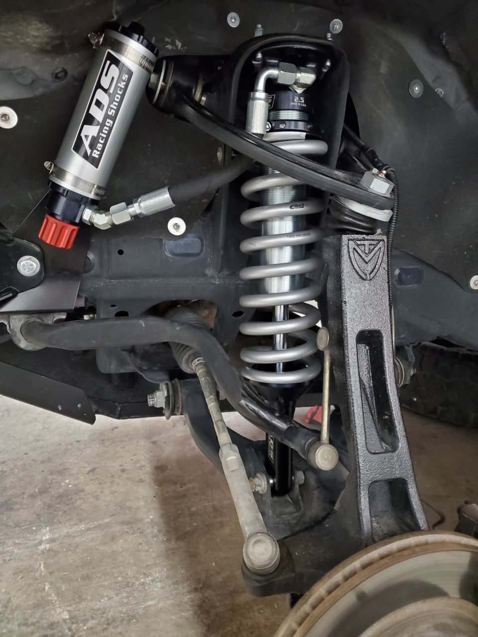

    I'm so happy. The ride is night and day difference from the billys

    Is that how much preload you are running?

    Yes, the passengers side is way less. It feels like I'm floating on pillows. Absolutely in LOVE

    Nice, idk how you’re getting so muc lift... I have like 1.25 on driver side and it’s not that much

    I have Maxtrac 4" spindles lifting my front end. My truck is a 2wd PreRunner
