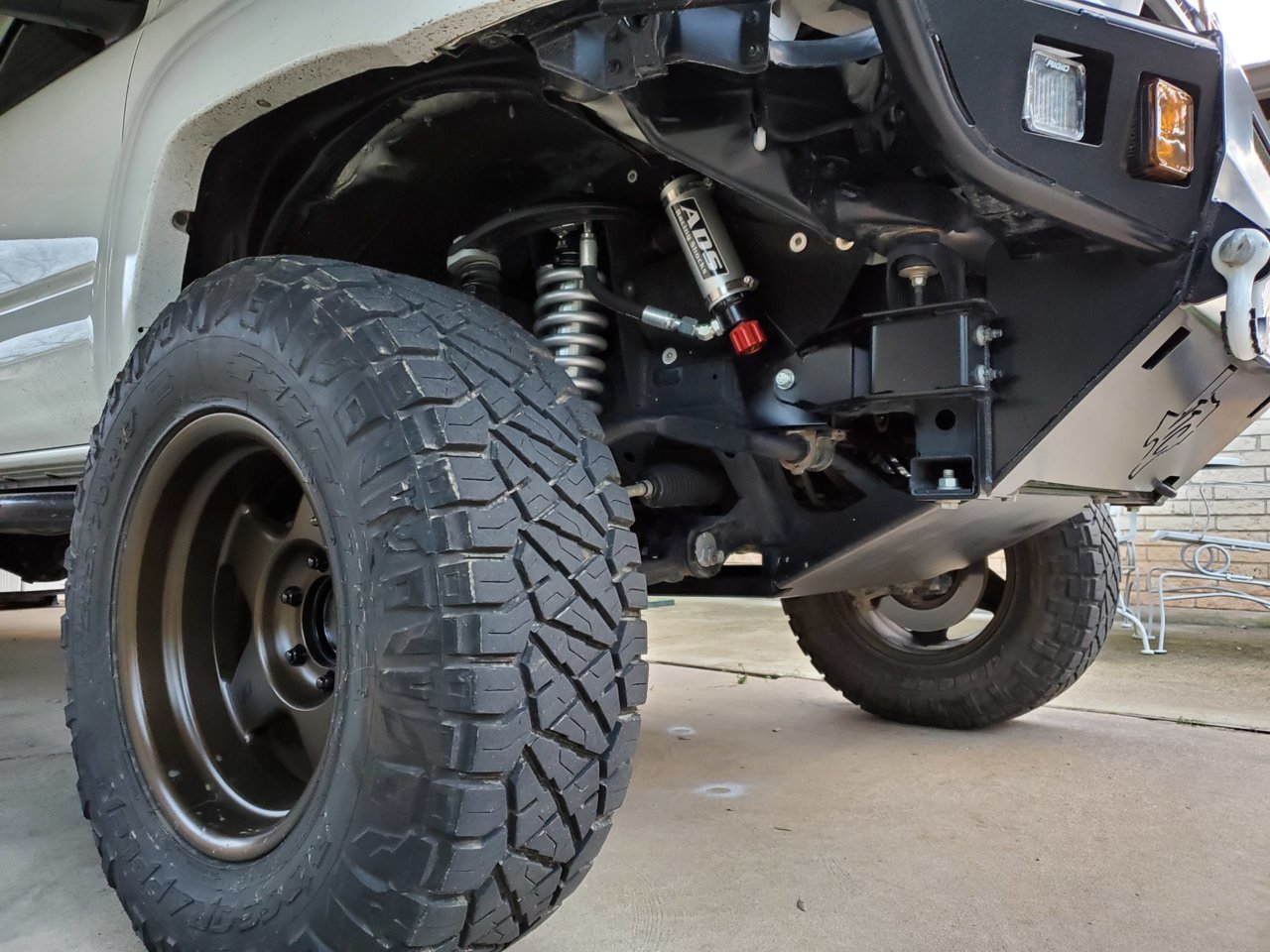

    This doesn't suck.​
    I could probably take the sway bar off now. :)

    Hell yeah, glad to hear that.
    It's not even that deep. My spindle setup pushes the fronts out 3/4 each side so its exaggerated.
    They are a tiny bit deep :p
    Edit: you could also get them in 8" width with less backspace
