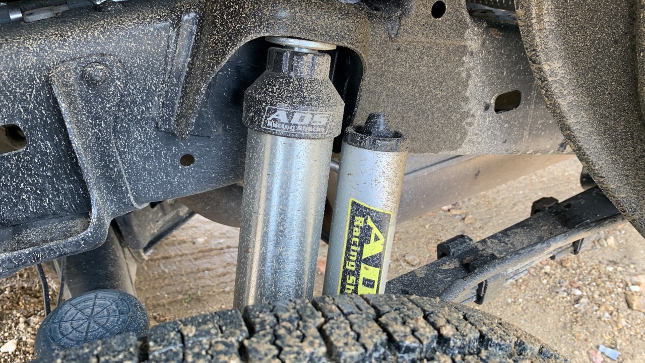

    ADS in AZ
    3/13/21
    Self install. 1.5”x4 lift.
    First trip out. I-17, CC, Prescott. Fun snowy day!
    One word for the ADS: controlled.

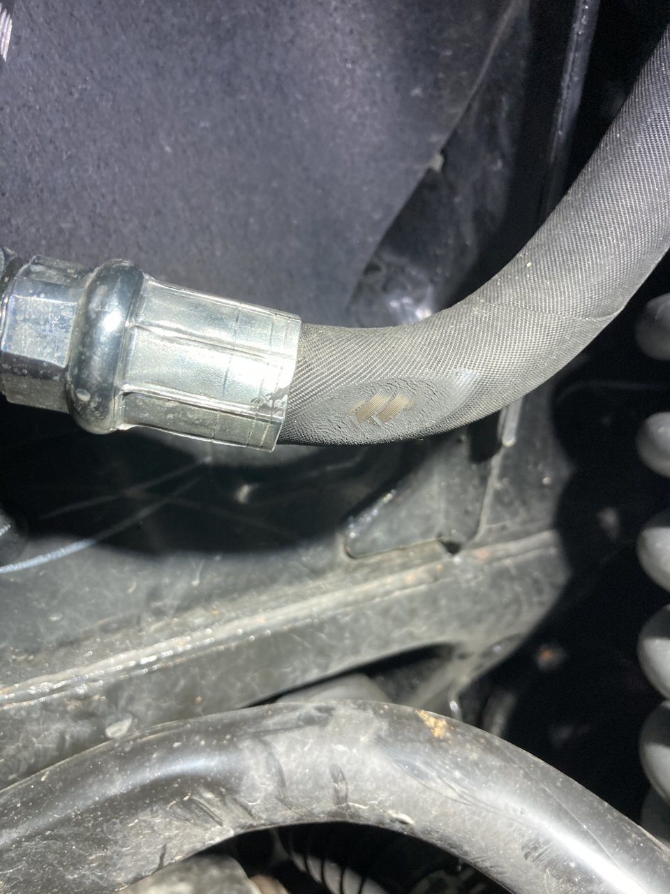

    So went out and played, checked suspension after. Seems like I under clocked my drivers reservoir and the tire rubbed a bit at full lock (4.5” bs wheels). Got through a little bit of rubber. What do you guys think? i’m not a hydraulic line expert by any stretch, but this seems like it won’t be any issue, right? is the steel reinforcement stainless or should i throw a quick shot of enamel to protect it?

    Yikes! That's discomforting to see huh?
    After reading this, I tested my reservoir line with a small magnet. Stuck to it like glue. Might want to paint it, and then PlastiDip it for extra water protection.
    I would also contact ADS and see if this wear point will cause any issues structurally (although I doubt it).

    Thanks for the reassurance! I did contact ADS and have also thrown some bumper coating (enamel paint) that I had laying around on there to protect the steel braids from corrosion.

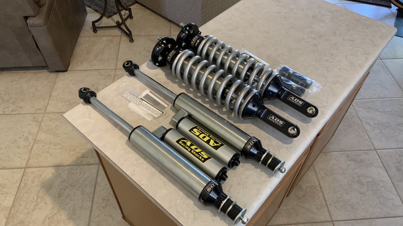

    Some and some more
    I wish I would have done this right out of the box!

    Did you get some rub, too?
    For anyone that is watching, Tyler from ADS responded to my message and said the hose is still fine in this state and will function as intended.
