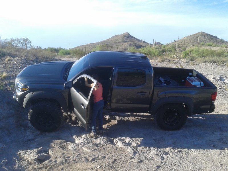

    I'm running the exact same setup as you, except I have MCM ucas. I noticed your truck sits a lot more level than mine. Did you crank up the coilovers at all? I had a "1.25 lift out of the box. Cranked to "2.5 thinking the springs would settle to "2. Sits at "1.75 now. Ass end is sitting at 3.5" of lift after 2k miles. Once I get my hi clearance bumper on that should help. Way to much rake for me the way it sits now.

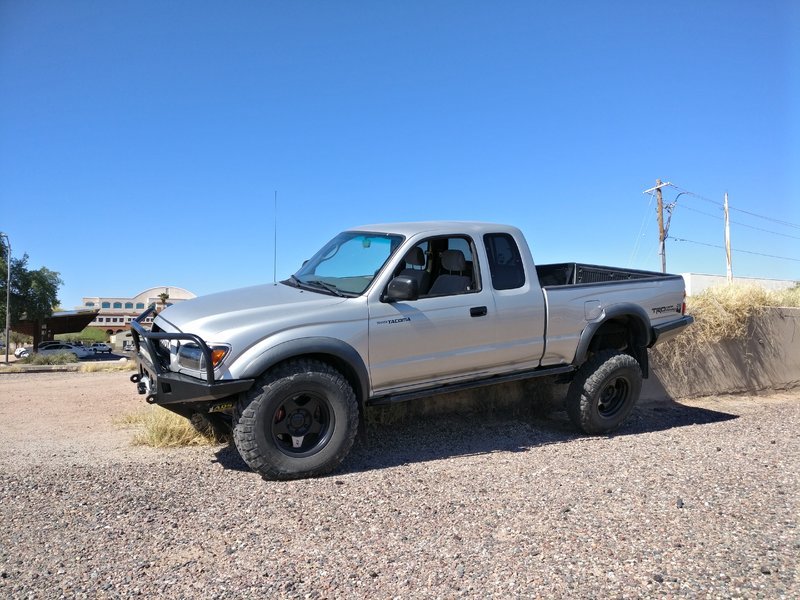

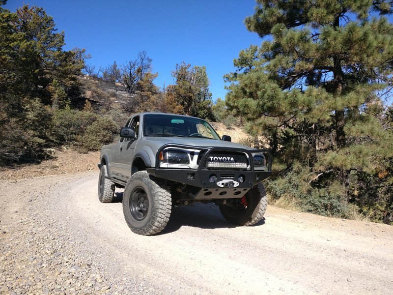

    Seems to give a good amount of lift on par with my old man emu, CV angles look fine and it still compresses nicely.

    Oh your 1st Gen so different from second gen. Looks good though.

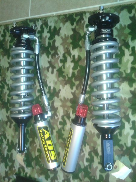

    20160628_184231.jpg Here's mine out of the box. Not a lot of preload at all.

    The number of threads visible should be quite different between 1st and 2nd/3rd Gens to achieve the same amount of height increase. That's most likely why it looks like a ton of preload to those of us a with newer gen!

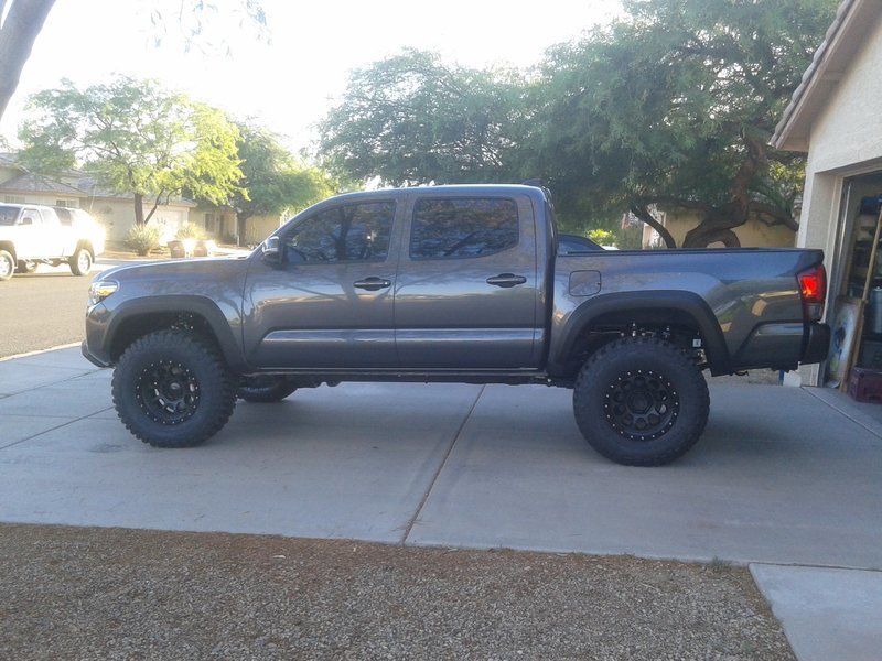

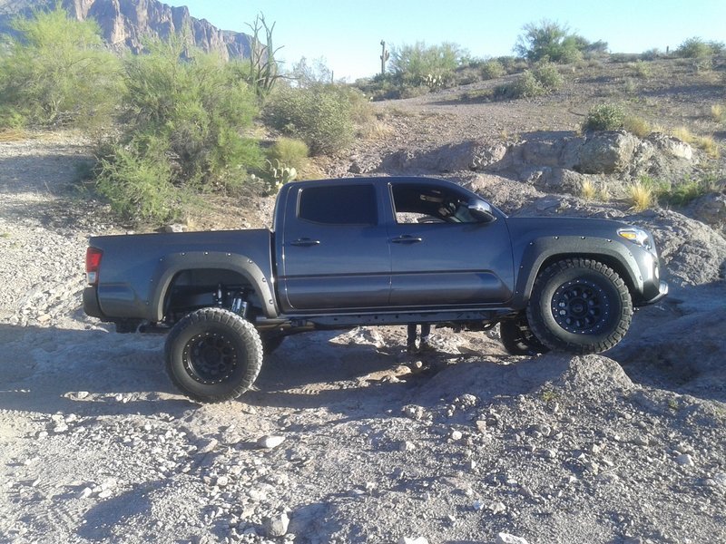

    20160813_174227.jpg Checking front tire clearance, before airing down for an easy trail ride. Front tires still skim across the flares on the bottom corner. This is with 4.5 caster, and 285/75/17. 20160813_174151.jpg
