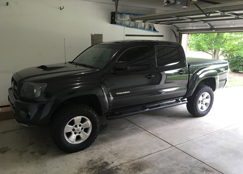

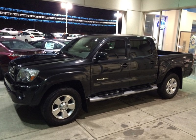

    Alright, I did the best I could to find a decent side angle before picture and then replicate it for an after shot. The before picture happens to be the day I picked my truck up (100% stock) and I literally just took the after shot in my garage. I've done several other things to the truck since I bought it so you guys will notice some other stuff has changed as well but either way, here is a rough idea of what this setup looks like.
    Before:
    After:

    looking good with that set up!

    - 5100/885's, 5100/Icon 3leaf progressive AAL with overload left in, 1/4" Taco lean spacer - ARE Z Series camper shell with Yakima rack system - Tepui Ayer Rooftop Tent - Prinsu Design Cabrac with heavy duty anadized bars - WeatherTech window deflectors/floor liners/bug deflector - Ultragauge MX1.3 - PopnLock codable locking tailgate handle - TRD shift knob - 3M tint - Extang solid fold2.0 tonneu cover - OEM Tacoma muffler tip - OEM Tacoma side steps - OEM Tacoma bed mat - OEM Tacoma roof rack - OEM TRD PRO front grille in matte black - OEM TRD PRO headlights - Fastway FLASH "Solid-Tow" adjustable aluminum ball mount hitch - Reese dual hitch ball covers - Masterlock locking J pin - GoPro windshield mount - Door trim protectors - Side mirror 'fish eyes' - Thule T2 hitch mount 2 bike carrier - LEDs: Map/Dome, 3rd brake, license plate, parking lights, reverse CREE's - SEMA TRD PRO 17" black matte wheels - 265/70/17 BFG A/T KO2s - Black Widow 40" x 95" 3 piece powder-coated folding bed ramp - Mobtown Offroad ribbed tailgate reinforcement skin - GRIDiT center console organizer - Salex center console organizer - Marco Extreme Blast black premium train air horn - 'ImmrYo' Rearview mirror relocate bracket - Mattgecko's Sliding window security bar - Rigid tow rear hitch shackle - Plasti-dipped gunmetal emblems - Blacked out ACEkraut's front license plate relocate bracket - De-flapped (OEM mud flaps gone) - Uniden XL520 CB Radio - Shmellmopwho's CB antenna bed mount - 3ft Firestik II CB antenna - BirdDawg Industries Tech Deck Extreme version w/ 3 Ram 1" ball mounts - Ram Mounts: iPhone6/iPad Mini4 X Grips with 1" dual ball sockets - Garmin GLO portable GPS & GLONASS receiver - Depo LED tail lights with blacked-out inner housing - Various Velcro backed patches on the headliner - 3D-Cell LED Maglite mounted to the driver seat - 4XInnovation DOM weld on sliders with kickouts (welded at 20degree angle) - 4XInnovation Hi Lift bed mounting system - Hi Lift All cast 60" jack with optional handle holder - Lotus Development Hi Lift slider adapter - Relentless Fabrifacfions dual bed rail mounts with dual Quick Fists - Salex glovebox organizer system - YETI vintage bottle opener mounted to the bed - TRD Sport style aftermarket epoxy resin decals for WT front mats - Rigid Industries LED D2 spot lights (Midnight edition) - CBI spot light hood mounts - Air on Board "Zombie Lights" switch - Rebadged WeatherTech floor liners with custom TRD Sport emblems - GoPro Hero 3+ windshield mounted - Mattgecko's cool white LED bedlight kit v2 - 1.25" Spidertrax wheel spacers - Maxsa Escaper Buddy traction boards (mounted on top of Prinsu Cabrac) - 42" Plano Weatherproof gun case (mounted on top of Prinsu Cabrac) - 2gal Rotopax gasoline can, mounting plate, DLX pack mount (mounted on top of Prinsu Cabrac) - Bestek 150W power inverter DC 12V to 110 V - DBPower 600A car jump starter/booster - SOS Off-road Concepts Factory recovery replacement mount - ARB 30' Recovery strap - ARB EZDeflator - Smittybilt receiver hitch D ring with 3/3" shackle - Bosch Icon wiper blades - RCI IFS steel skid plate - Trasharoo trash bag - mounted on tailgate - Lamin X yellow fog lamp covers - Aftermarket illuminated air conditioning/heater/vent knobs - Toyota full frame replacement - Spring 2023 ================================ Future mods: - Rear diff breather relocate - Foglights anytime - Install external speaker for CB - Install mattgecko bedlight kit
    guess you are stock all over if you are worried about mpgs
