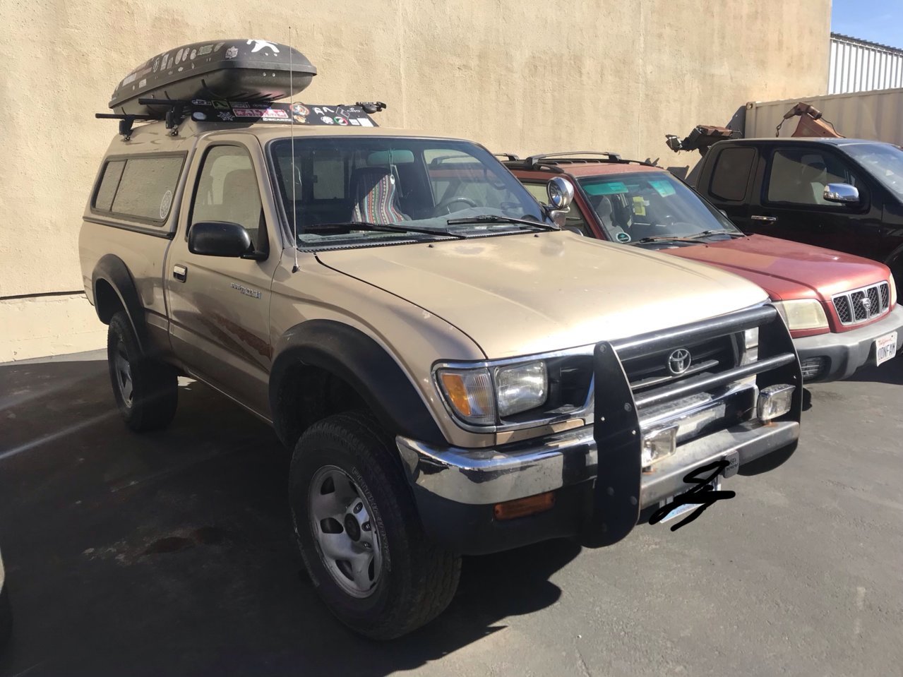

    I’m looking for some advice on what to do with my truck? I have some mechanical capacity to fix small things, but not a head gasket. I am traveling in Northern California, but I am from WA state. My Tacoma broke down yesterday, white smoke, grinding sound wont start, the works!
    Tacoma 1995
    3RZ-FE 2.7 L Engine Manual Trasmission 4x4
    Blown Head gasket. Needs to be towed.
    Otherwise in great shape. Only a little rust on the frame near the rear bumper mounting bolts. No body rust. The parking brake leavers are rusted and need to be hammered and greased.

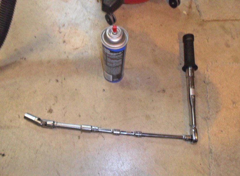

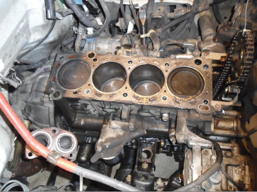

    I remember I've been quoted for head gasket job (same engine) for 1500 dollars. Being new to such "big" job and little naive I tackled the job with my son and basic shop tools. Got "all top gaskets set" from a dealer for 250 dollars. It took us 2 weeks after work (a couple hours a day) to learn, disassemble, clean all parts and put it all together.
    Few scary moments (torquing head bolts), few "I need a longer breaker bar" moments (removing timing chain gears) and many "how was it before I removed it - let's check a photo" moments. Sometimes I had to improvise with tools on hand like this one for removing one of the exhaust bolts
    But starting her for the first time was priceless. And by doing that job myself I ended up with all top end in like new shape. Just while you there make sure to replace fuel filter - very easy to do when everything is off.
