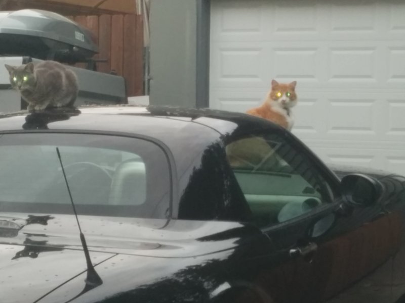

    The worst enemy of your black paint - CATS Damn cats!!! They love black cars and trucks. Regular occurrence on my Miata.
