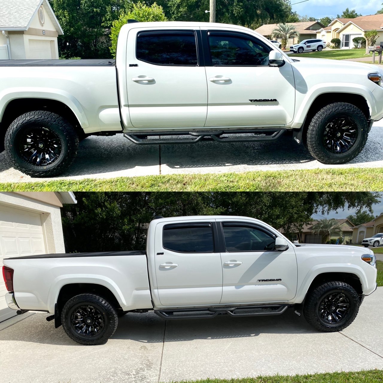

    Just went up to 17s and put 265/70 Falkens but they rubbed, so went down to 265/65 Falken and no rubbing.
    Here is what I ordered:
    Fuel Wheels Blitz Gloss Black Milled 6-Lug Wheel; 17x9; -12mm Offset (16-23 Tacoma)
    Falken Wildpeak All-Terrain Tire (265/70R17)
    Again these did rub so went down 265/65R17

    12mm

    Nice looking truck, how do you like these wheels.
    Every time I see them they grow on me more and more

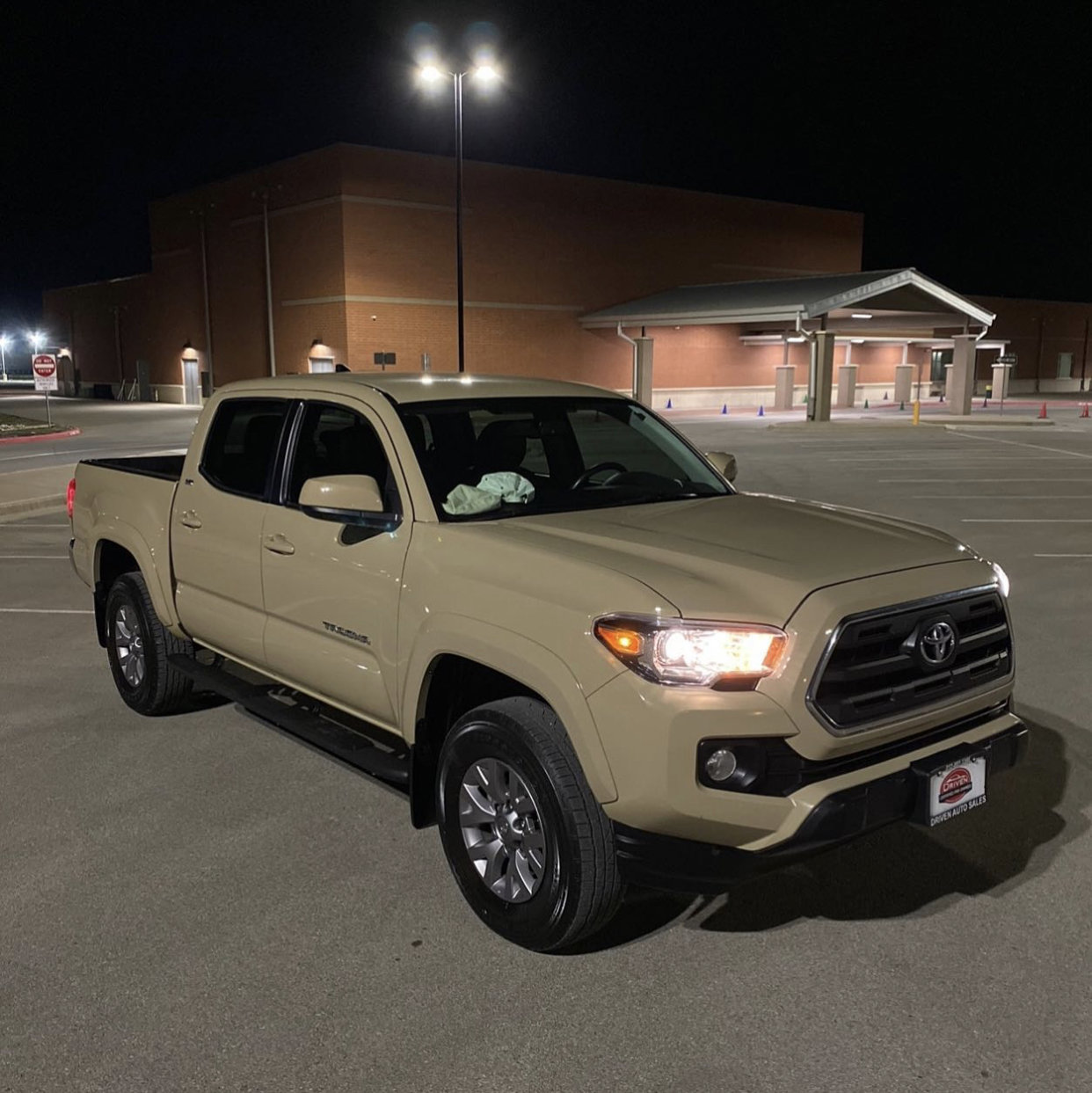

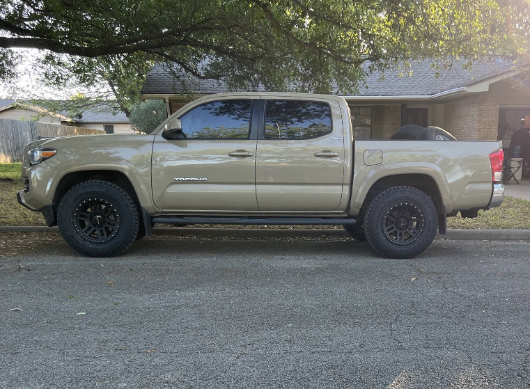

    so i ended up getting tires and rims the next day (yesterday) after work, across the street at Discount Tire. i went with Goodyear Ultraterrains 265/70 R17. so i did step it up. they did a fit test and i was clear everywhere. the only spot where it was truly close on full turns was the plastic guard in front (low) of the front tire. then i got vision rims. i was gonna go elsewhere for rims but they were a decent deal and i got to get it all done at once. not to get all into the economics but financially speaking, they also let me do 12 month 0% interest on the whole kit and caboodle.
    NOTE: first image is the day i got it, the second (from the side) is yesterday.
