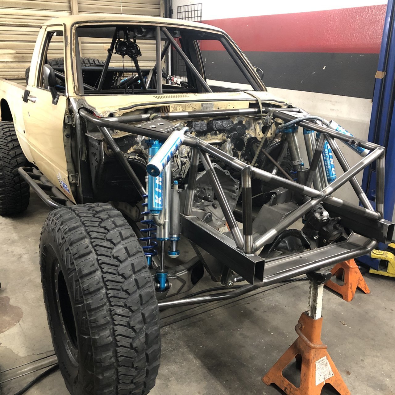

    I'm with this guy, this is obviously the way to go.
    Grossomotto[QUOTED] likes this.
  8. Jan 21, 2021 at 5:57 AM
    #28
    Grossomotto
    Grossomotto Complete 3rd Member
    Mar 13, 2018
    #247175
    8,430
    39.9526° N, 75.1652° W
    2017 4WDV6LB6MT
    He's in the Hilux forum, spectacular build.
