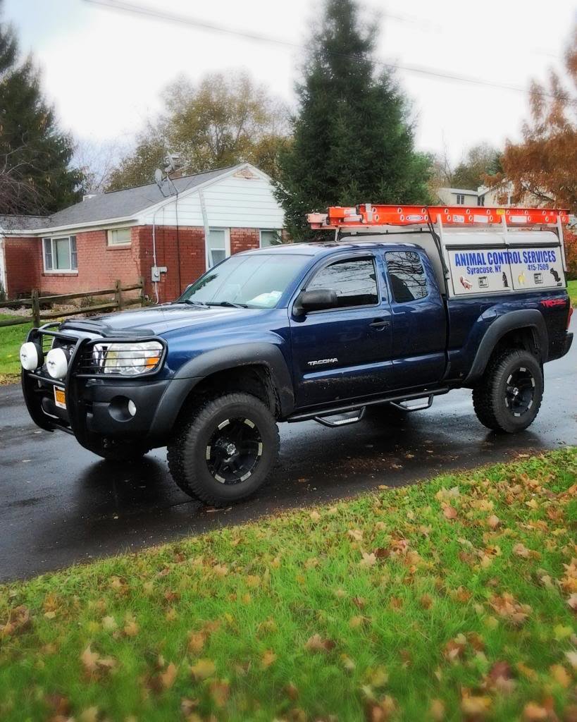

    I have about that much weight on mine, or a little more. We tried a couple set-ups, and it was wasted money. Finally put a set of AllPro Expo's on and could not be happier. I put at least a hundred miles a day on inner city potholed roads, and the truck rides great. Also there has been no loss of ride height at all since installing a couple years ago. I would guess we are 3" over stock fully loaded , maybe a little less, I have never measured.004_zps2ac99f58_0069b0ff3b51952685892ac1fc85aefbe1116252.jpg
