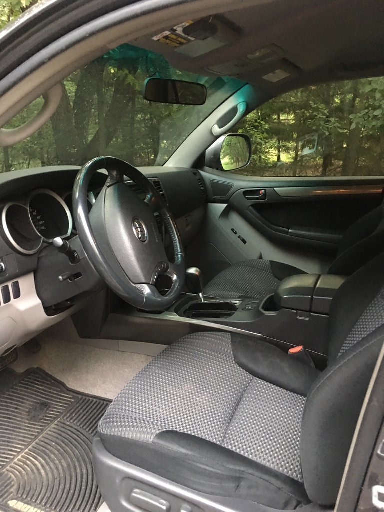

    Here is the interior pic from the owner. Also she states, "It was a company vehicle bought for me, when I retired I purchased it. It was serviced through enterprise when it was new and also through me." Must have worked for Enterprise or something....what do you all think? Worth a look/test drive?
