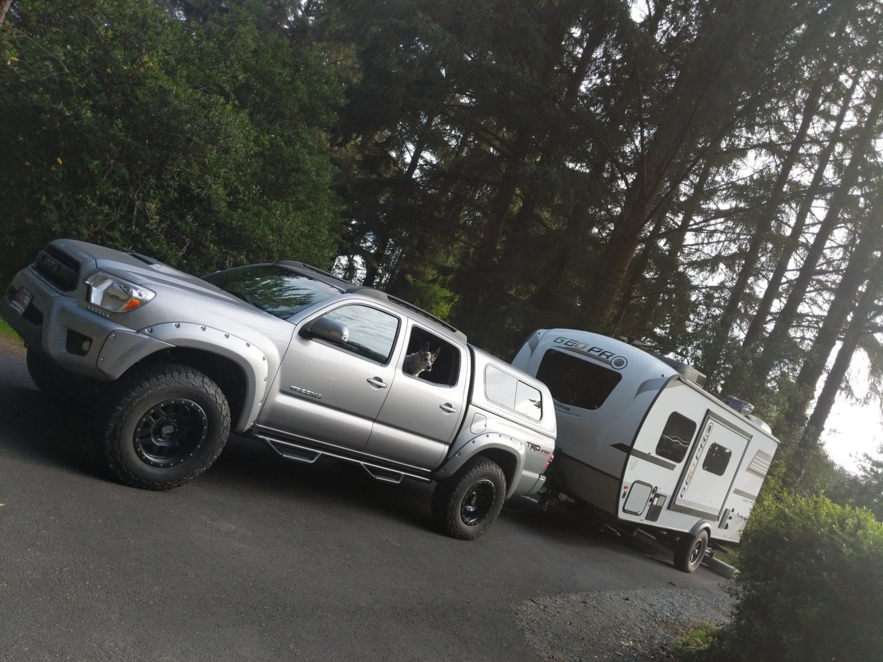

    I re-geared to 4.56 w/ 33" tires and 3" lift. We just pulled a 19' 3200lb travel trailer 3000 miles round trip from Albuquerque to Oregon and back. I averaged 13.3 mpgIMG_20191015_163356.jpg

    I like your setup & your truck looks good! That is great to hear though about your mileage since mine is similar, just 6" lift instead of 3".
