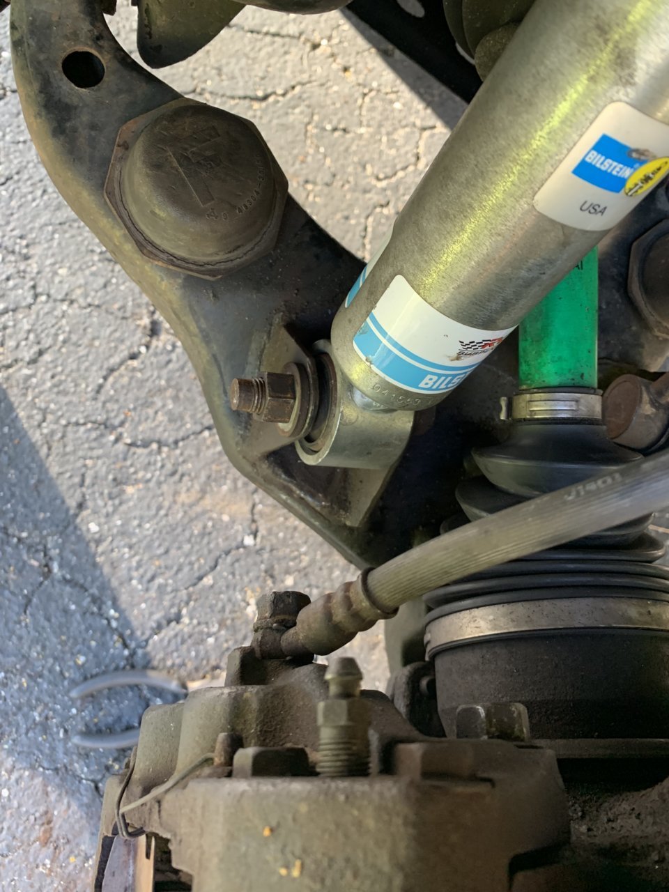

    Yeah, was pumped after an embarrassing amount of time I got the spike all the way through and lined up and started getting the bolt in and “POP” spike came out and suspension jumped forward. So I went inside because it was dark... I am on my own tomorrow so hope I can get it in

    Fuck yes! CV is bent as fuck hopefully not as bad with the tire on the pavement. Now time to find torque specs because I lost them... then need to do the other side.

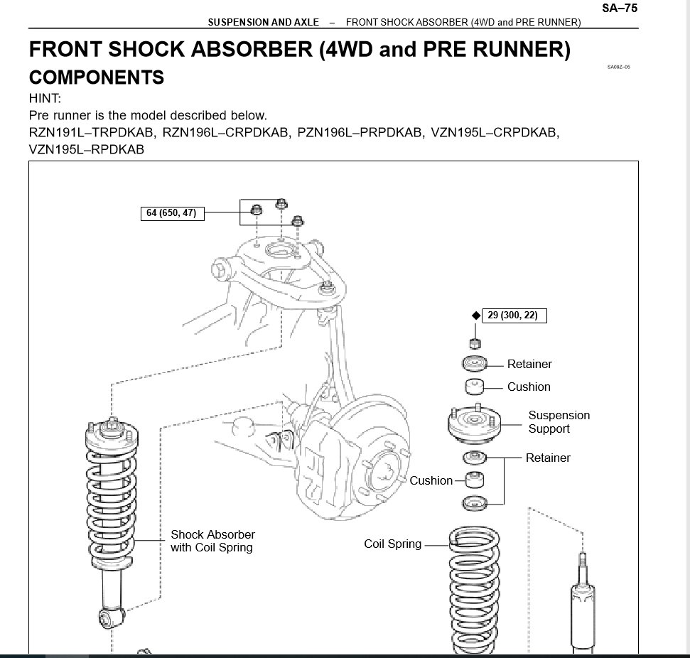

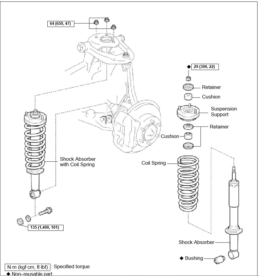

    Capture 1.jpg Capture 2.jpg I believe the torque specs for 1st gen Tacoma's are 101 ft. lbs. for lower shock bolt and 47 ft. lbs. for the 3 top nuts
    Don't torque the lower bolts until the truck is on the ground and you bounce the suspension up and down a few times.

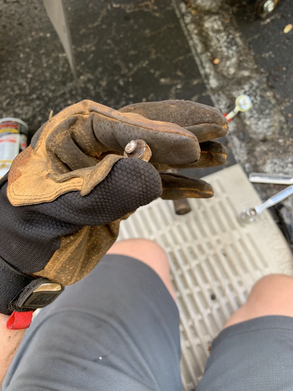

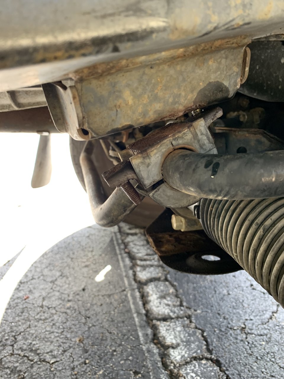

    Wouldn’t be a project without a broken bolt!
    224F2D85-0D31-496E-A43E-8C63203D4308.jpg C81844B9-3308-4616-89E7-678E59BBBAFA.jpg
    Also the apartment people aren’t pumped about me doing work on my truck in the parking lot.

    2015 TRD Sport Well-Known Member
    Apr 15, 2013
    #102139
    749
    South Carolina
    2021 TRD Pro
    At least it's just for the sway bar
    JakesTacoTRD[OP] likes this.

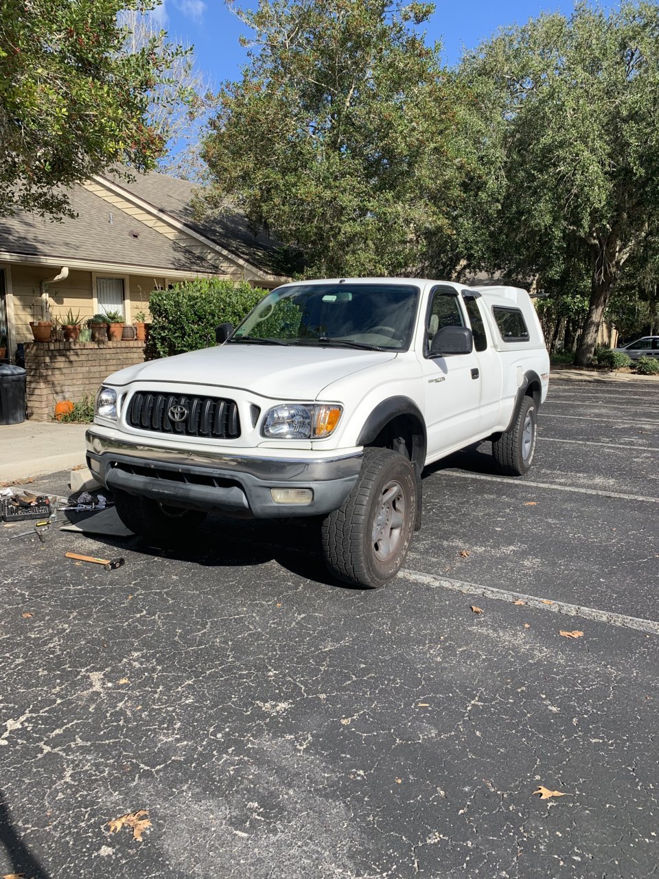

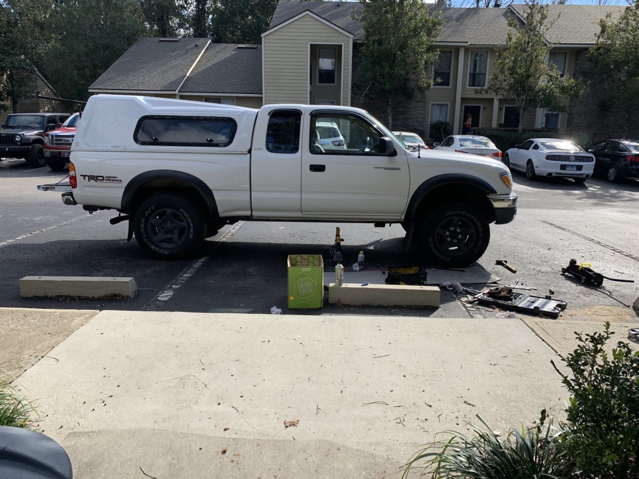

    F0B0177A-C8CD-48E2-8679-086421C48638.jpg image.jpg Need to do the back but not today
  10. Jan 7, 2019 at 11:30 AM
    #30
    JakesTacoTRD
    JakesTacoTRD [OP] "Winona the Tacoma"
    Aug 26, 2017
    #228090
    267
    Jacob
    Gainesville, FL
    2001 White Tacoma SR5 TRD 4x4 5 speed

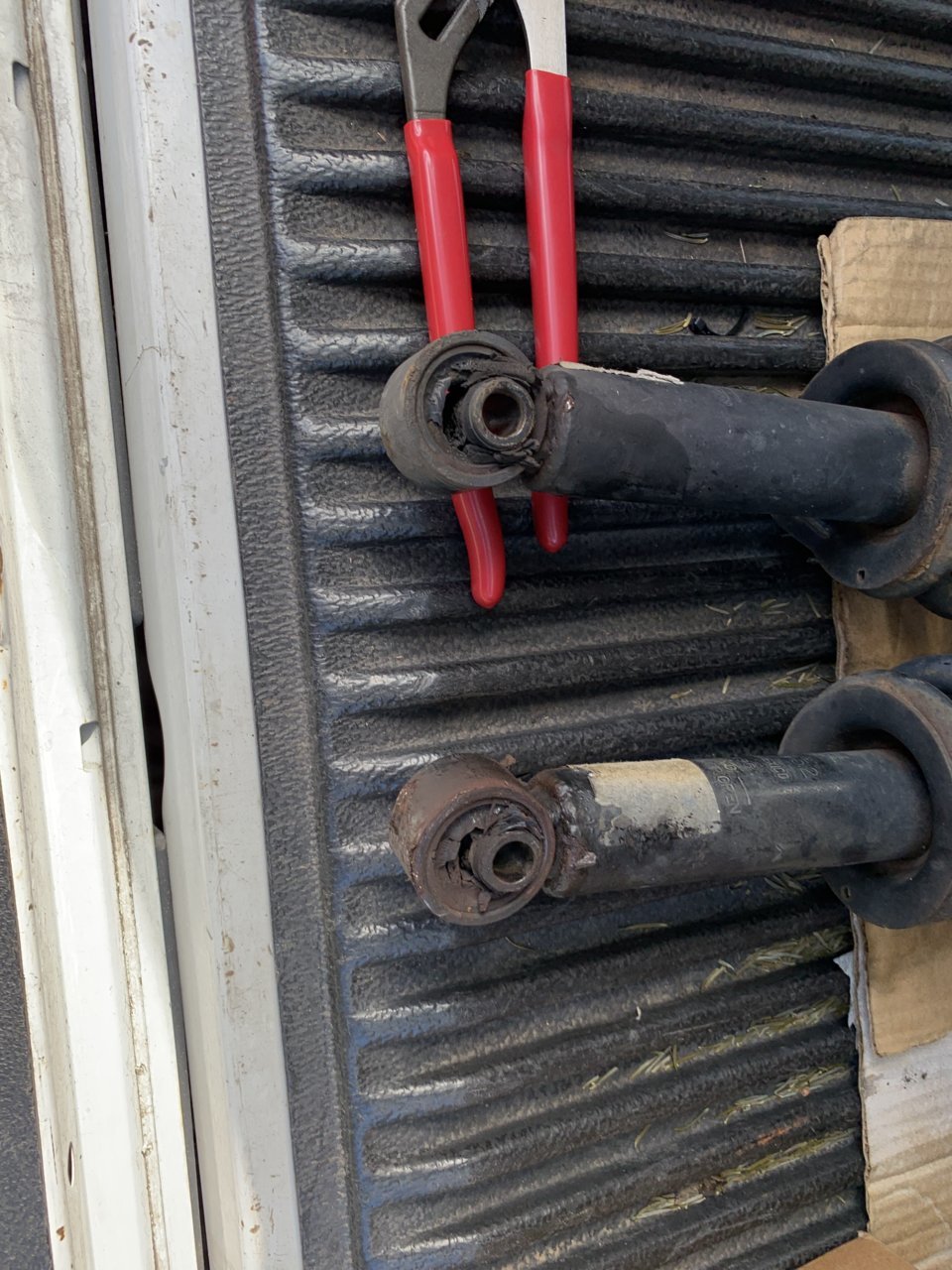

    Before:
    After:
    And then 1.5 AAL for the back in a weekend or two.
    Here are the two old shocks:
    Ccrames2018 and Taco critter like this.

    Yeah, no more loud suspension which is cool. Now gonna drive it around a bit a retorque the nuts and it also reduced the drift in the steering wheel. Getting the tires rotated and balanced. Currently a happy camper!

    Had the guy torque them properly when I got it aligned. Thanks for the info!
