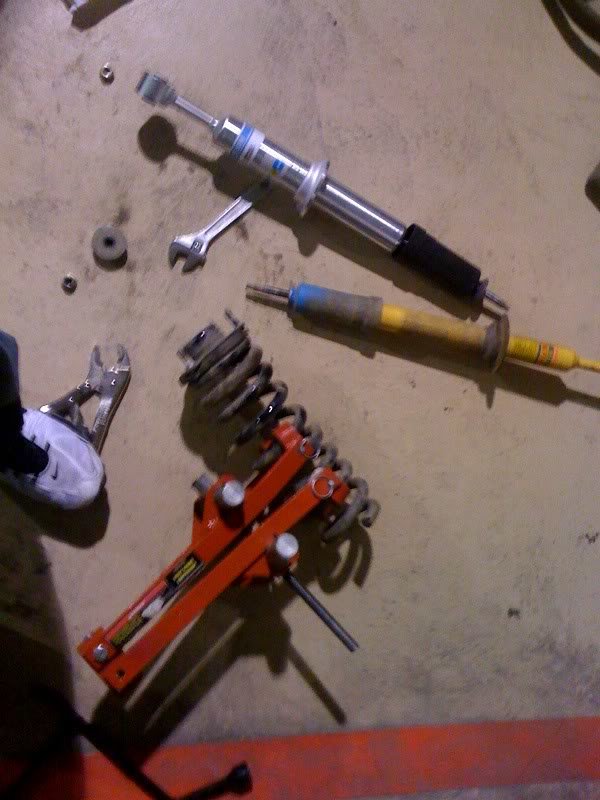

    I did my own spring compressing. It's not an easy job but I've done it several times before. As you saw in the video, it is very dangerous if you don't know what you're doing and not take safety precautions. Videos like that are the reason I prefer to do the work myself. Also if you're getting UCA's, you should just wait until you have the kit and the uca's and install everything all at once.

    I can say that before I attemped my 5100's I was worried about the compressing the spring part but I have a $30 fro harbor freight and it worked just fine. I called around to shops to do the total instal and they want close to $300 and let me tell you there is no where near $300 worth of work going on to change out suspension it was very easy to do and I would think that the coil overs which will be my next step will be just as easy.

    Now that looks like a beefier tool that I could trust. The ones I was looking at were two separate spring compressors with bent plate steel hooks on the end. I'm guessing you tightened down one side at a time until the spring was compressed. I couldn't see how they would keep the coil from slipping out of the fingers. The coil looks like its securely held by this one-piece tool.
    Edit; Is this the tool in your pic?

    That's a damn good heavy duty compressor. Never seen one like that before. All the ones I've ever tried using were wimpy auto store loaners. :)
    Needeless to say, I stopped using them when they start to bend. :eek:

    Am I the only one with one of these bad boys. Got it at Harbor Freight for $80 bucks. Pump the handle a few times and you're done.

    What kind of Safety retension for the spring does it have? I dont see any pins holding the spring secure? After having one blow on my left hand, Im a little more cautios about dealing with these. :eek:
