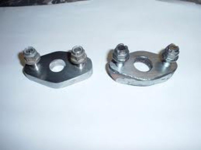

    get o2 bung spacers. 14 dollar fix. getting to much air flow. IMO

    I must admit I had to look up the bung spacers.
    Apparently they physically move the oxygen sensor further away from the exhaust flow.
    But they seem to mostly be for P0420 & P0120 DTC codes, from my quick search, not P0133.

    The "bungs" mentioned are used to move the O2 sensor out of the flow of exhaust. This simply fools the post-cat O2 sensors into believing the catalytic converter is working properly. While this does reduce the chances of a P0420 from returning, it would not fix the problem. It simply masks it.
    If you were to use those bungs on the pre-cat sensor(s), you would most likely result in creating a code, instead of eliminating it. Moving the AF sensor out of the exhaust stream will make the sensor read no changes, and the computer expects to see a steady fluctuation of the signal. (hence the P0133 code for a slow response)
