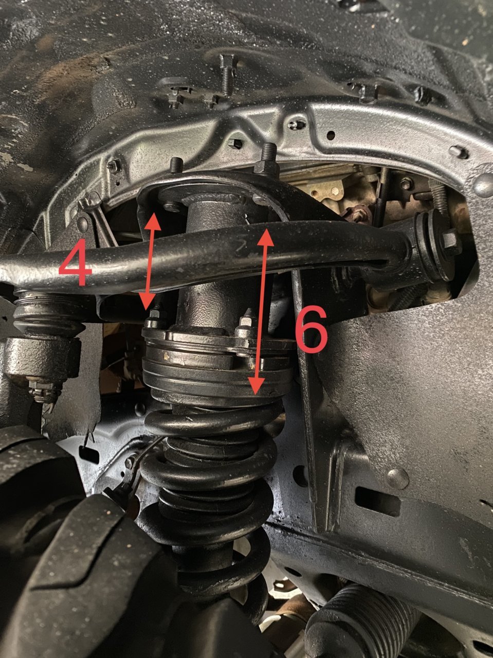

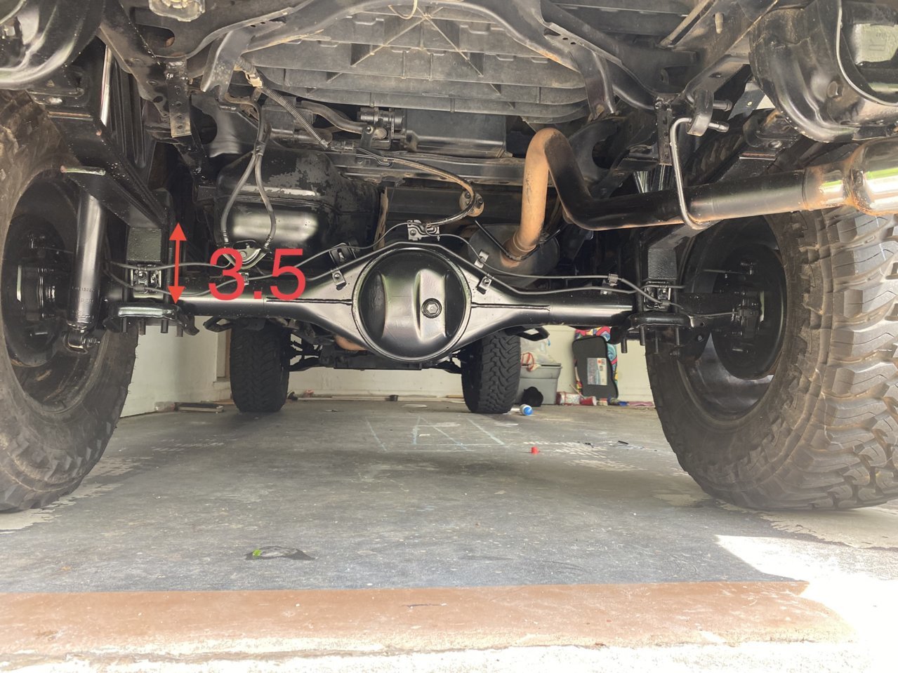

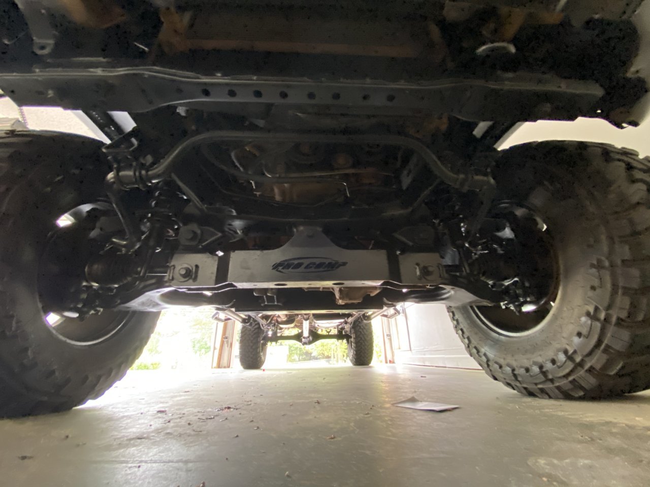

    09 Tacoma 4wd dbl cab
    6” pro comp lift/ 18x10 wheels (prev owner mod)
    I have a pro comp drop bracket and want to get my truck back down to a manageable height. A slight lift, no lift, doesn’t matter to me. Just bought it last week and need it as an additional work truck. What’s my best route to go? I have 4” spacers on front and 3-3.5 blocks in back.

    Probably need to replace your crossmember since it was cut and welded for the drop bracket lift.

    Thanks for the suggestion. Ive researched a cross member and they run about $150 (aftermarket)That’s just for the cross member. Is the pro comp cross member the only thing that has to be replaced? In addition to taking out the spacers.
