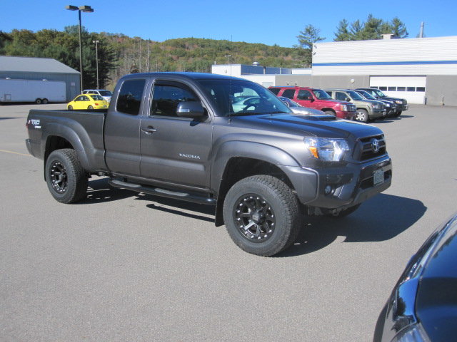

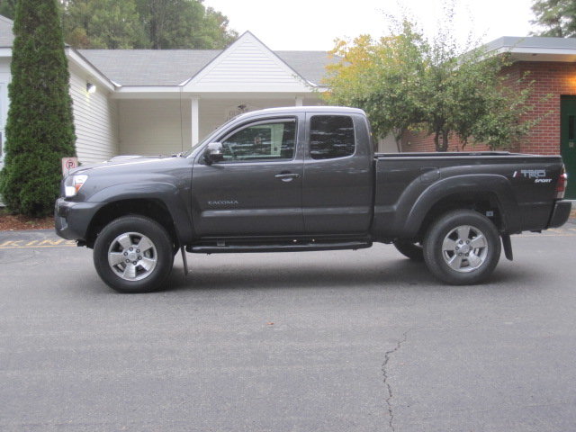

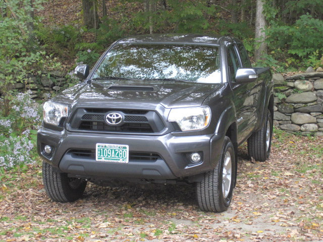

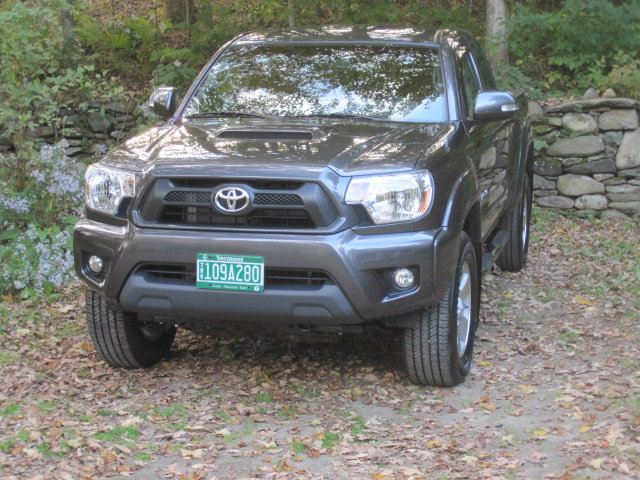

    2013 MGM Sport on the day I brought her home, 9/22/12
    First day, added nerf bars, In-Channel rain guards, WeatherTech floor liners, and removed the ugly dealer license plate frame.

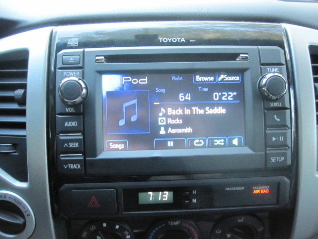

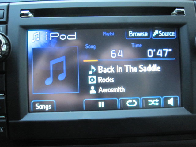

    Hooked up the iPod to the stereo. Not really a 'mod', but I'll tell ya, after spending hundreds of dollars and hours of installation on my last Tacoma stereo, this is f'in amazing! It looks way better, sounds just as good, and took seconds to plug into the USB port. Get me some McDonalds, cause I'm Lovin' It!!

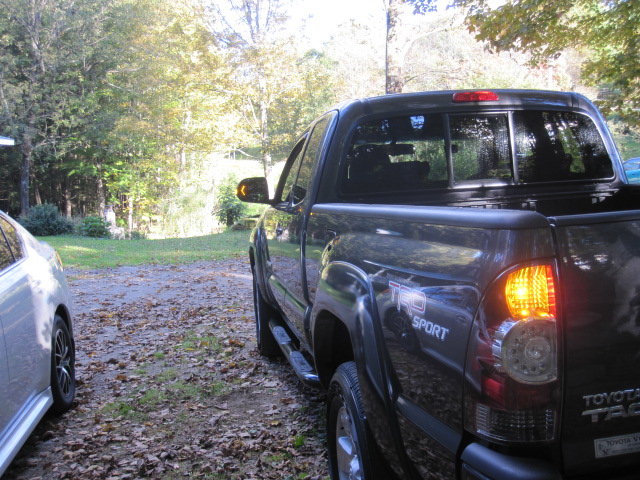

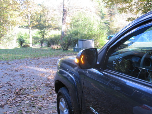

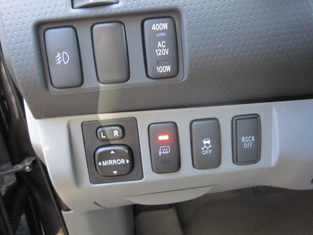

    9/23/12 - Added my Muth heated turn signal mirrors and Highlander heated mirror switch back in. Took nine hours this time. What a bitch, but well worth it in the end.

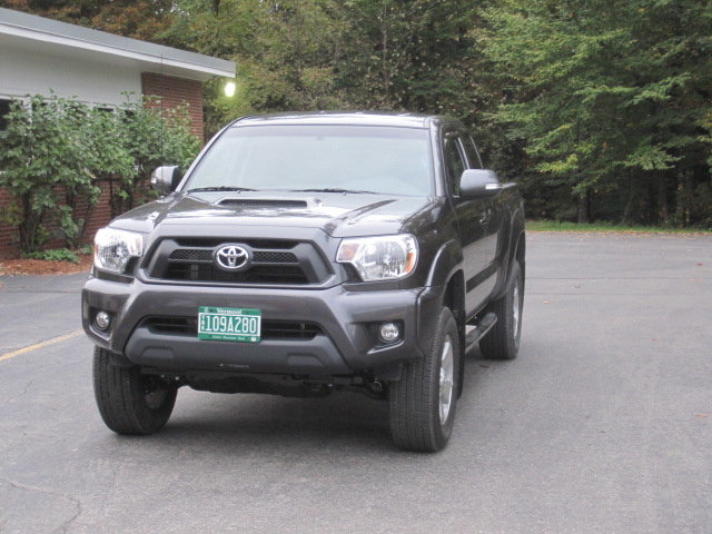

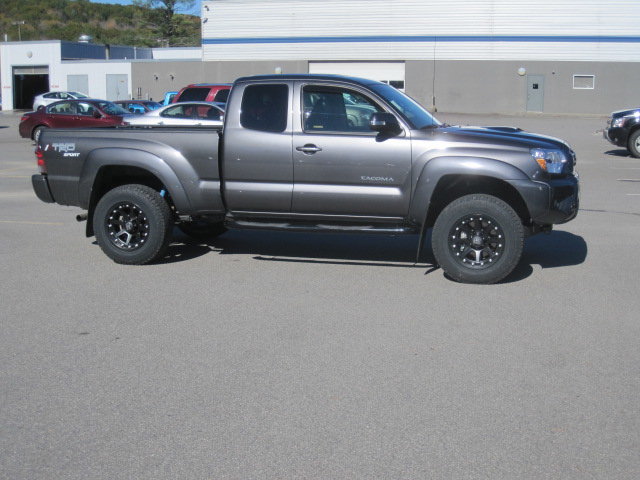

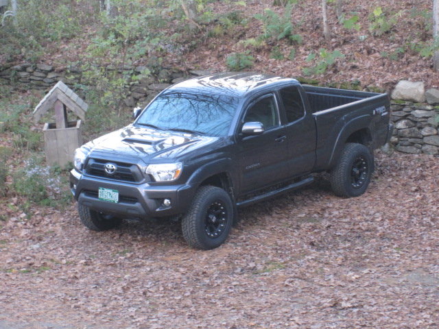

    Also on 9/29/2012: Leveled with 5100s @ 1.75"
    Decided to do it myself this time, and only took around 2 hours. I used the method where you unhook the lower ball joint and lower it with a jack...no compressor needed, and worked like a charm. I really did need an extra set of hands though, so I wouldn't advise trying this alone.
    10/7/2012: Did the disable A/C with defrost mod. Love this mod, and did it on my 2010 when I still had that one too.

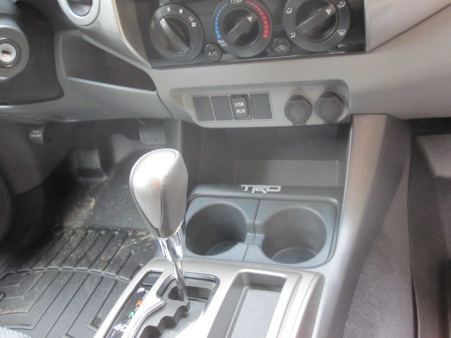

    10/12/2012: Swapped out the rear center console for the older style lidded one. It is a direct fit using the 2013 bracket.

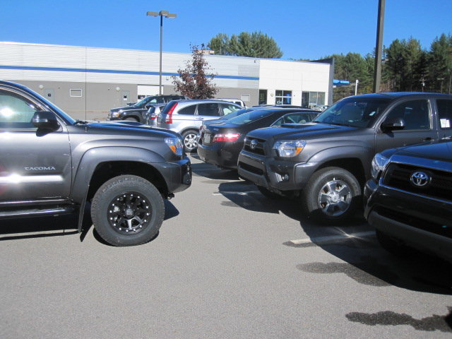

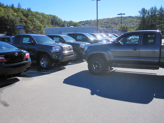

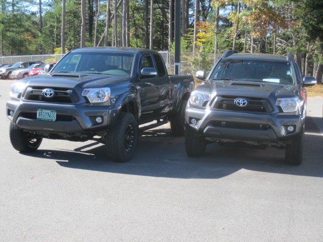

    I had a rare opportunity to get close to another identical, but stock, MGM Sport. It's amazing the difference 1.75" makes.
    Who's yer Daddy?? :D
    And this one was beside a Double Cab Sport. I couldn't get right beside the Access Cab one.

    :thumbsup: Good song choice!

    '10 Tacoma 4x4 LBDC SR5 TRD Sport
    Too many to list now.
    Hey man, wondering about those mirrors....Can it work on a 2010 and if so, how do I get them and how much? Are you just taking the whole setup off of a highlander?

    Yes, they work on a '10, in fact, I first put them on my '10, but when that got hit by a flatbed I traded it in and took some of my mods with me to put on the 2013, including the mirrors.
    They are Muth mirrors, and a Highlander switch. You also have to add a relay or the switch will burn out, and an add-a-fuse kit. There are a few threads on it here, including this one.
    It is an expensive project, probably around $350 with all the parts, but I don't regret it at all. It is very worth it if you get frost where you live.

    looks good, did you actually swap out the entire mirror for this swap like you also have stock MGM sport turn signal mirror set?? or did i mis understand lol. if you have the stock set and want to sell them let me know

    The mirror housing is the stock one. I only replaced the mirror glass.

    Nice truck! Is it perfectly level or a little bit nose high? Can't really tell in the pictures.

    Thanks. No, the front is about 1/2" lower than the back on the right, and the front left is 3/4" lower than the back.
