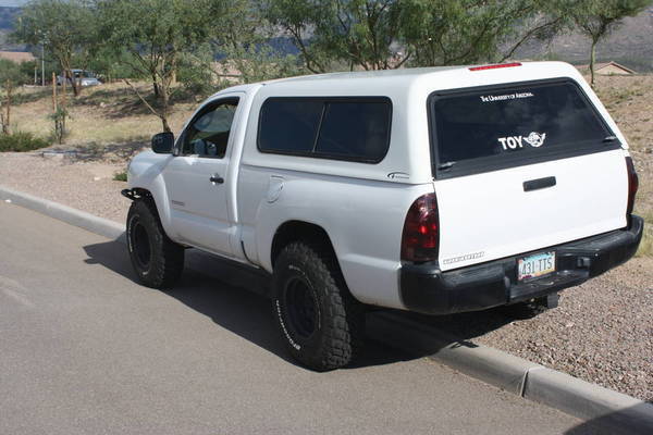

    I took the Deavers off for now and put the AAL and stock leaf springs on the truck. When I have some more $$$ I will have the Deavers re-arched. I have not taken any pics of the truck yet, but here is one picture (taken Oct. 14) from Roy's camera. The rear sits higher by half inch or so.

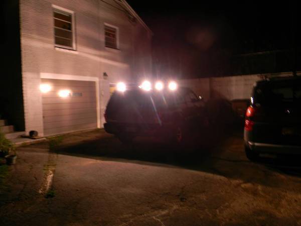

    So here are some pics of the topper lights and aux fuse box.
    Lights lit up at night. The light housings themselves are pretty cheap fogs from walmart or chain auto stores. They were already installed on the topper when I bought it. I took out the stock bulbs and put in KC 55w Ice Blue H3 Halogens.

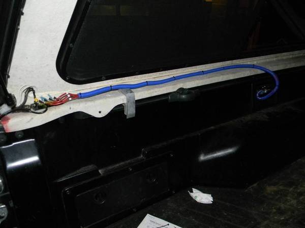

    Wiring inside the topper. I ran 10 gauge wire from the relays under the hood to the DS bed cubby. I used a six pin trailer wiring jack and plug to make the wiring removable with the topper. I continued the 10 gauge to a barrier strip where I tied into the lights.

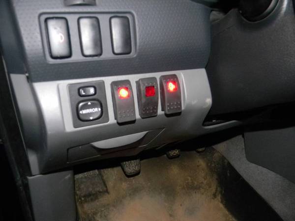

    I used some Carling rocker switches in some of the empty switch locations.

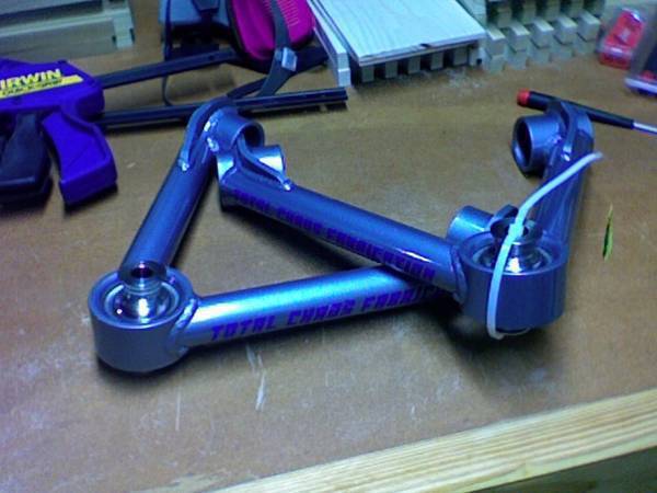

    Last month I picked up a set of TC UCA's for a really good price off ebay.:D
    Now I've got to save up for some coilovers.:eek:

    I think I got them for around 400.
    I haven't gotten them on yet. I picked up a pair of Icon coilovers too. I've just got to get around to swapping it all out. Not really looking forward to it right now. I just moved, trying to plan a wedding, and find a new job. Not too much time to think about doing truck mods, although that's what I'd rather be thinking about sometimes.:eek:
