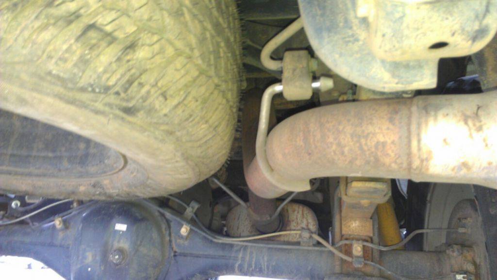

    Id like to see how close the exhaust comes to the spare tire........Im having issues with the urd 3"

    The exhaust is no longer shiny and new, and it has seen it's fair share of dirt, mud, snow, and rocks. Even though it's 409SS it has browned, and has some rusty "pock marks". Unless you are physically scrubbing your exhaust every time you wash your truck, this is to be expected.
    No hitting the spare (which is still my OEM 265/65R17).

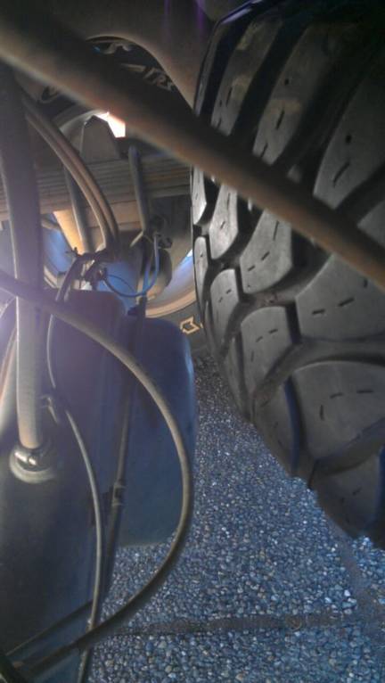

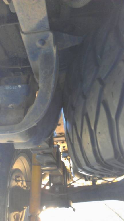

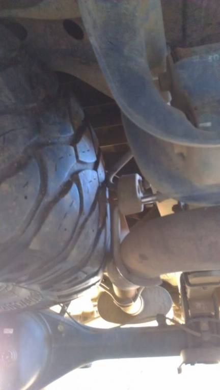

    Alright, I finally mounted my 285/70r17 spare. I also trimmed the stock spare braces
    It hits the stock exhaust hangars, but that's not a big deal since it doesn't get hot. It barely clears the 3" exhaust, so I will keep an eye on it to make sure it doesn't make contact. Otherwise, I will either relocate the spare, or chop the exhaust.
    It also hits the driver's side shackle mount, but again that's not a big deal since it doesn't move and I will eventually be doing a shackle-flip.
    Here's my biggest concern:
    It looks like it might JUST barely clear the pumpkin when the axle is fully stuffed, but I'm not 100% sure until it gets "field-tested".
    I will run it like this for a while, and see how it goes. I may end-up building a mount on the bed-rail (like MetalMiller's), or moving the spare on top of my canopy rails. Right now, space it becoming a commodity :p
