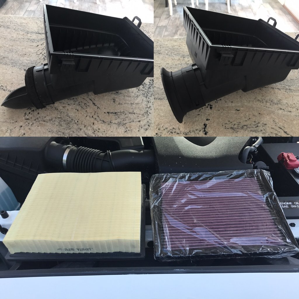

    Just installed the TBS today and my initial results are as follows:
    1.) Noticable increase in low-end throttle response.
    2.) Slightly smoother shifting in high rpms
    3.) Slight "whistle" noise when romping on the throttle similar to a turbo spool but not nearly as cool.
    4.) Little to no horsepower or torque increase. ¯\_(ツ)_/¯
    But you know what? That's pretty much what I was hoping for. Between this and the TRD intake accelerator, a K&N filter, and this throttle body spacer I am confident that this engine is getting all the air it needs. Plus it still looks stock which is something I was kind of going for.

    1. The trumpet horn on the front of the air box and any minimal effect on air flow it has is completely negated by the fact that the air hits the filter disrupting airflow yet again.
    2. like stated throttle body spacers haven't been effective on ANYTHING since the mid 90's when throttle body injection was a thing.
    The only way to get any change of power / torque curve is to increase or decrease intake runner lengths. An intake manifold spacer, put between the upper and lower intake manifold (to increase intake runner length)can do just this and shift torque curves down lower. But even they are minimal gains.
    Also lastly... go back to the stock air filter if you like clean air into your motor... those K&N air filters might flow amazing.... but they filter like shit.
