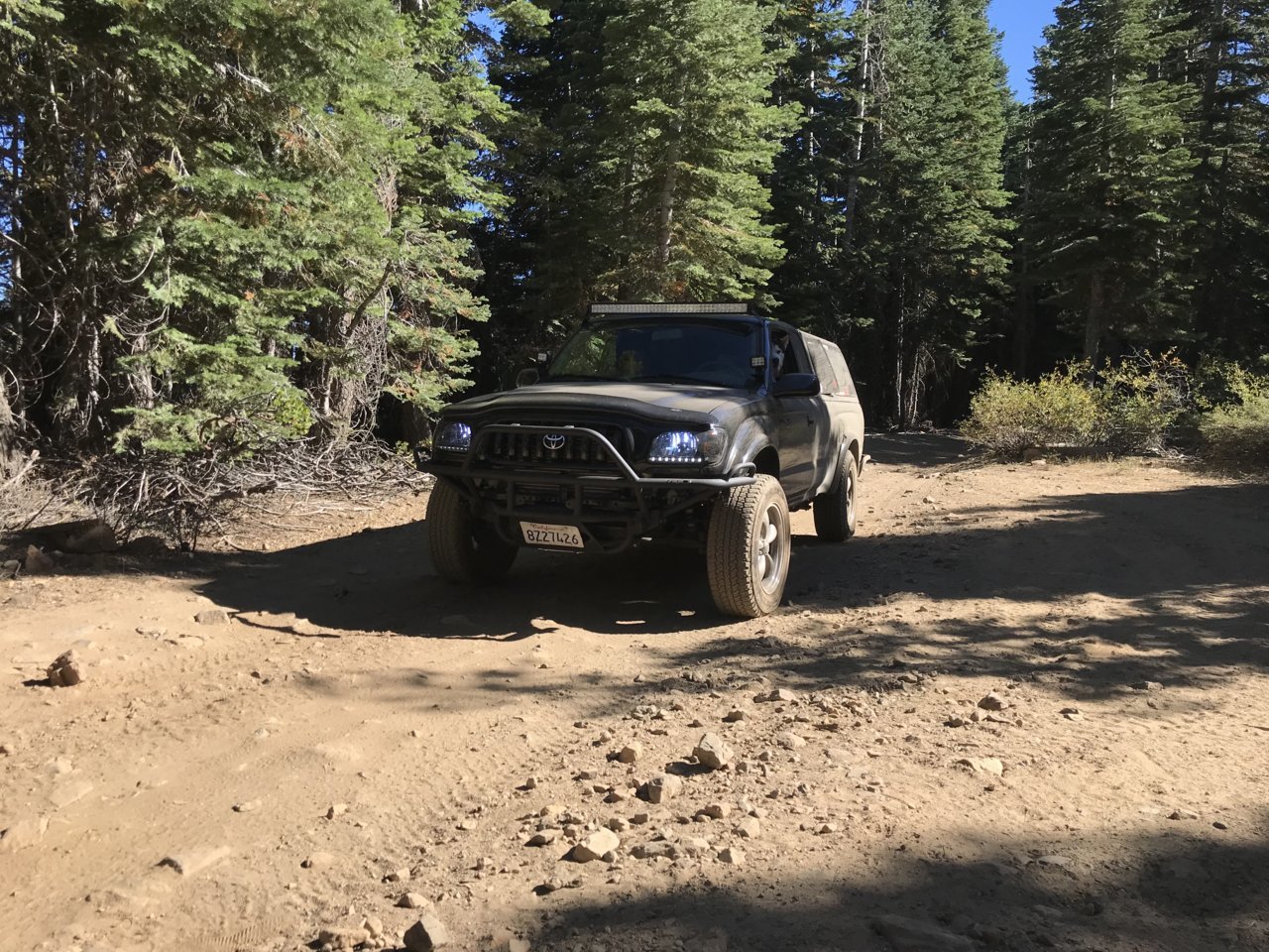

    Doestch sells a 6/3 lift that you can fit 32” tires on. That’s about max
    (I have but been to lazy to install)

    6lug coil overs will not fit. They are massive.
    There is a coil over conversions kit for 5lugs but its for lowering not lifting

    You think it would be as high as a 6lug with like 3” lift?

    Slightly lower by a 1” or 2”

    Even a 3” lifted 5lug on 30s is About 1-2” shorter then a stock 6lug

    I have 31 inch tires with the 3 inch lift. I'm still lower then a 6 lug.
