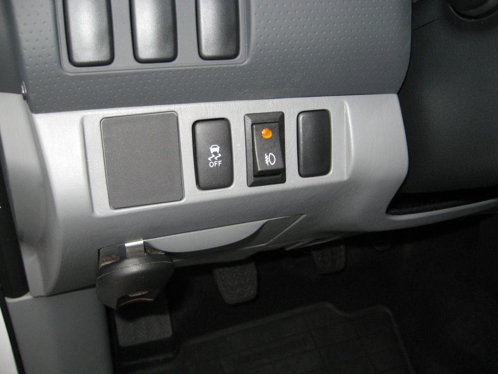

    I went with this OEM switch for my fogs. It's an older one that Toyota used to use for various models. Had to file the opening just a little. The Orange LED is not very bright and comes on when the switch does.
    Paid about $10 for it. Part # 00550-35976

    No..it's not bright at all. You will need to file the opening a bit to make the switch fit. No big deal and doesn't take much to open it up. File a bit and test fit a few times.
    In fact, I just ordered a second one. I'm going to use it for my bedlights that I'm going to install.
    There are 3 connections on the switch.
    #2 (+) power source (from battery, fuse panel, etc.)
    #3 (+) to the accessory (lights, relay, etc.)
    #4 (-) ground
