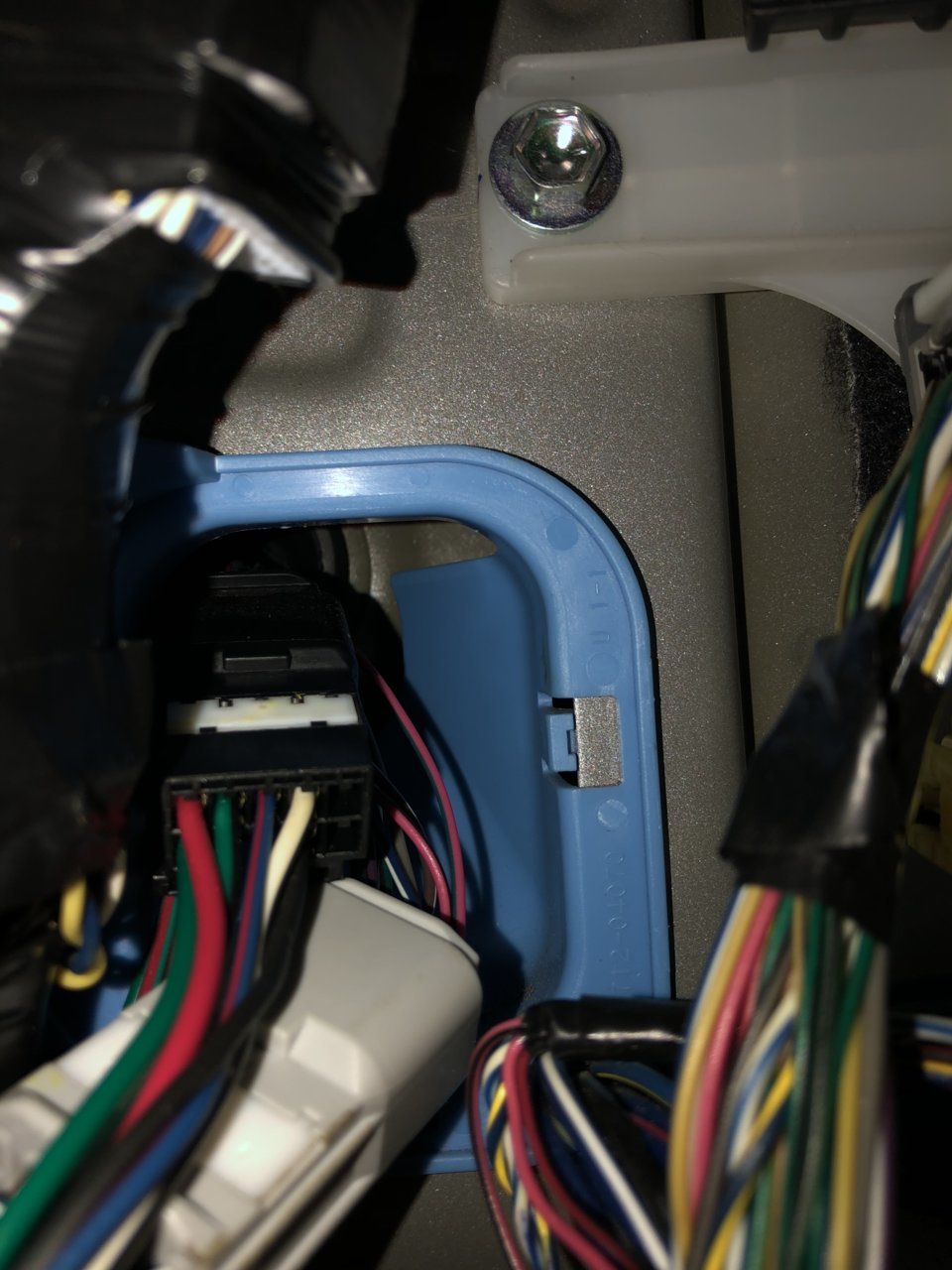

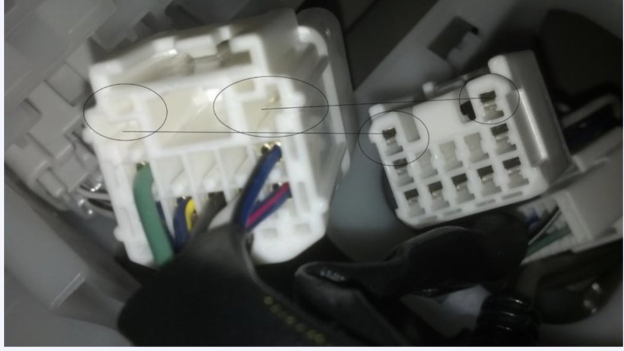

    The black clip missing two wires was location on drivers side of my 2013
    *I opened the blinker loom behind drivers kick panel as posted in other thread- but colors weren’t as listed. Used a simple test light to locate.
    Hope this helps!!

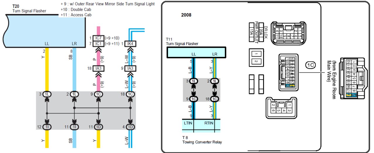

    Tap into connector 1C on your cab fuse box. pins 9 (Right) & 18 (Left)
    terminals are 090/2.3II types unsealed, get connectors and make T harness to branch towards door mirror signals. You must add the wires to the Towing Converter relay in the T harness...

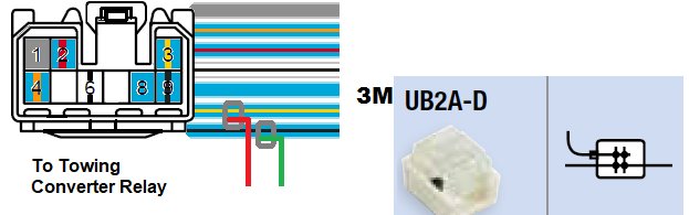

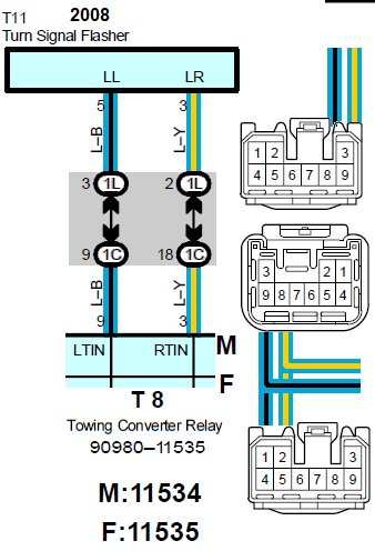

    The later model Tacoma uses a different turn signal relay than the one in your 2008.
    Your Tacoma has a turn signal share from the Cab fuse Box connector 1C pins 9 & 18. It also has a turn signal share wires to the Towing Relay (this one is located behind the Driver's side kick panel.)
    If you purchase connectors 90980-11534 & -11535 and 14 pairs of male & female 090/2.3II terminals you can assemble a T harness to place between the Towing Relay connector and the vehicle harness connector that mates to the Towing Relay. NO cutting the vehicle harness.

    You could T-tap the signal wires going to the Towing Converter....

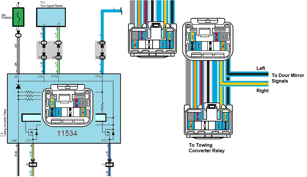

    So i can buy plugs and create a harness so i don’t have to tap into anything?
    Then they’ll function as turn signals when my other signals are on?
    Thats what i would prefer to do. What gauge wire should i get and where/what else sgould i gather up?

    Yes
    Yes
    Length between connectors is up to you. Connection to left & right mirror can have their own connector, no need to tie into the door to mirror connector.

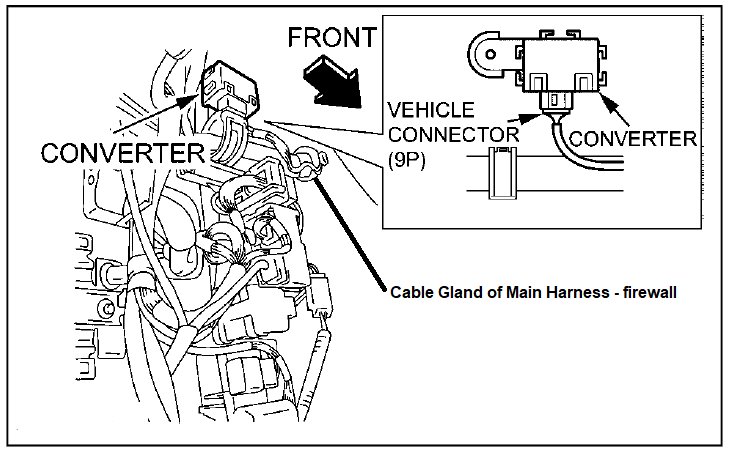

    Where exactly can I find the towing converter plug to tap in to?
