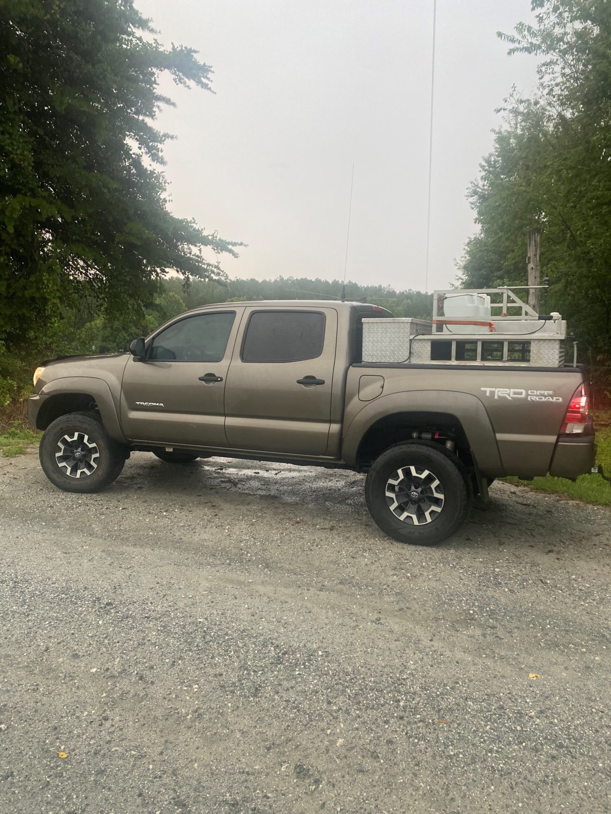

    Thanks, makes a lot of sense. And yes, I cut them down same reason you did. Got about the same distance between the stop and the frame as you do as well. Dont need a lot of articulation, more less want it to work well over washboarded pothole gravel roads. Wanted it to be smooth. Here is the truck after the install. OME susp install.jpg OME susp install.jpg

  4. Jul 10, 2024 at 9:03 AM
    ridefreak
    ridefreak Well-Known Member
    Oct 27, 2018
    #270747
    1,180
    NM
    2006 DCSB TRD
    minor tweaks
    Your truck looks great! I used HD rear springs which is a budget option and supposed to add 500# of carrying capacity along with 1.5~2" of lift. I wanted to avoid any vibrations so I swapped in the ECGS bushing and added a carrier bearing drop. I considered installing the wedges to angle the diff but between the ecgs bushing, new carrier bearing and the carrier brg drop + new front wheel bearings it's quieter and smoother then before the lift.
